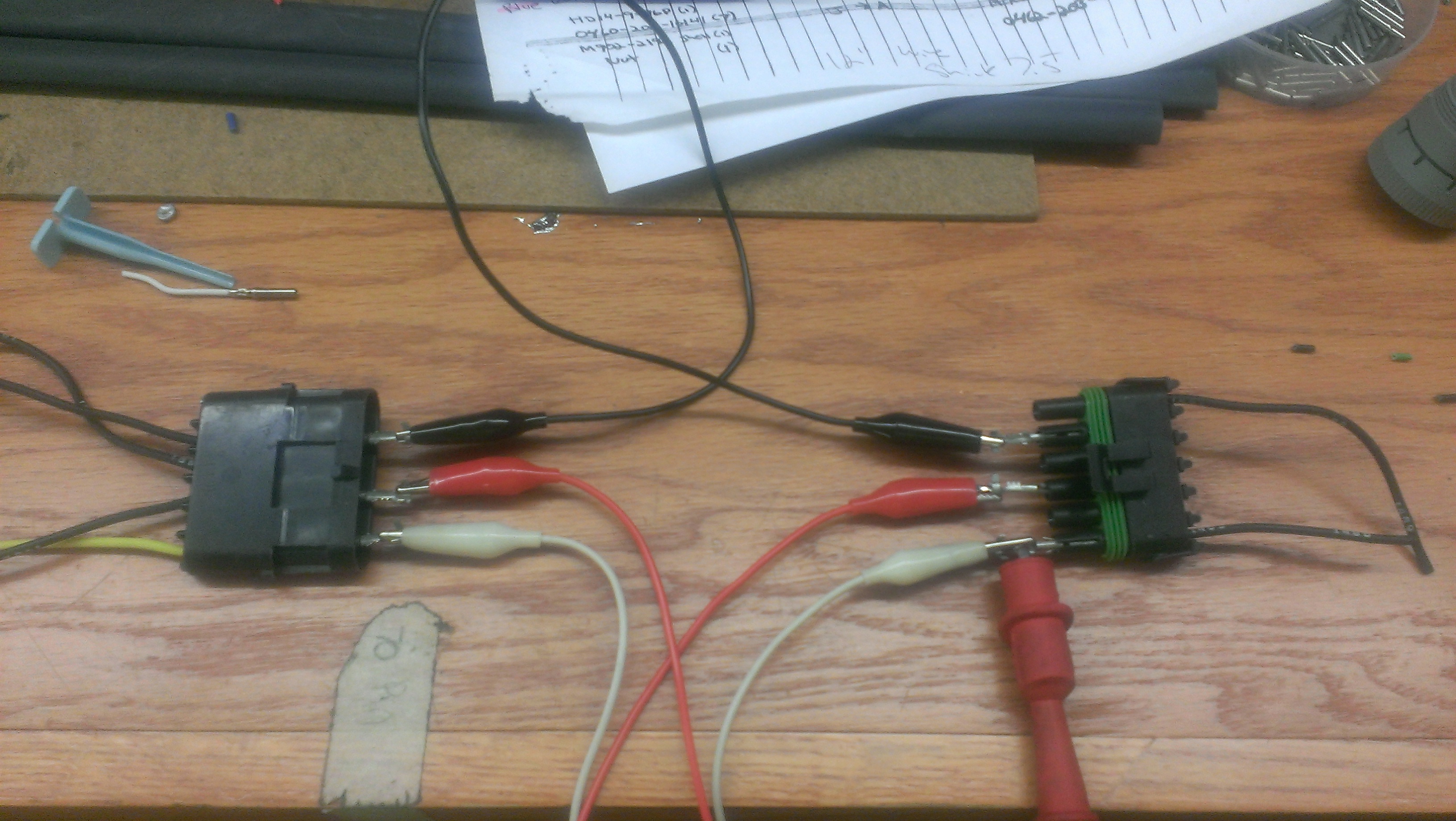

Jumpers shown, x3, easy to make up, and allows testing and/or Jumpers while things are hooked up properly. Any auto parts store or hardware store would have the crimp on ends shown, take your solinoid with you to get the right size blade male/female ends. Install jumpers between factory connectors, make double sure you keep them going to the matching positions.
dieselcrawler, YES - VERY CLEVER !!! Great Idea, I will head off later this afternoon to HDepot with the Solenoid in-hand as you suggested, if no hit there then on to AutoZone or Advantage. I hate to say this, I'm in the middle of cutting (58) 103" lengths (alternating match) of wallpaper. If you hear someone swearing tomorrow (pulling from my old Navy Vocabulary) that will be me while hanging......... This is probably the 15th time since the 90s I've found myself papering, not the most enjoyable task but nice when it's done.......... Thanks Again, dieselcrawler...........

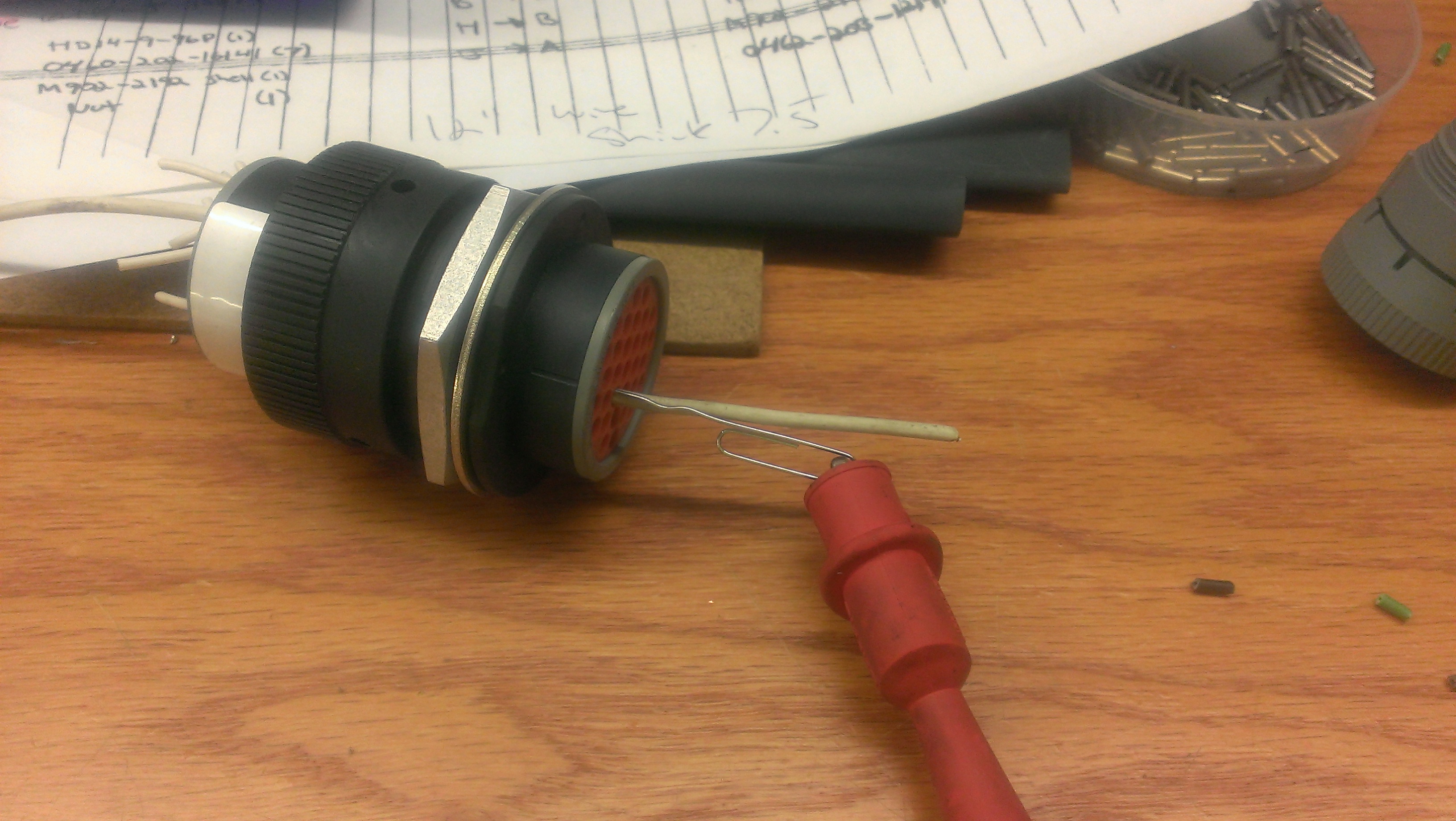

Can you back probe the connector?
This is using a Cat Spoon (7x-1710) it is dished and follows the wire to where you can touch the pin inside.
chances are you don't have the fancy cat spoon. this is what i am talking about with paper clip like wire.

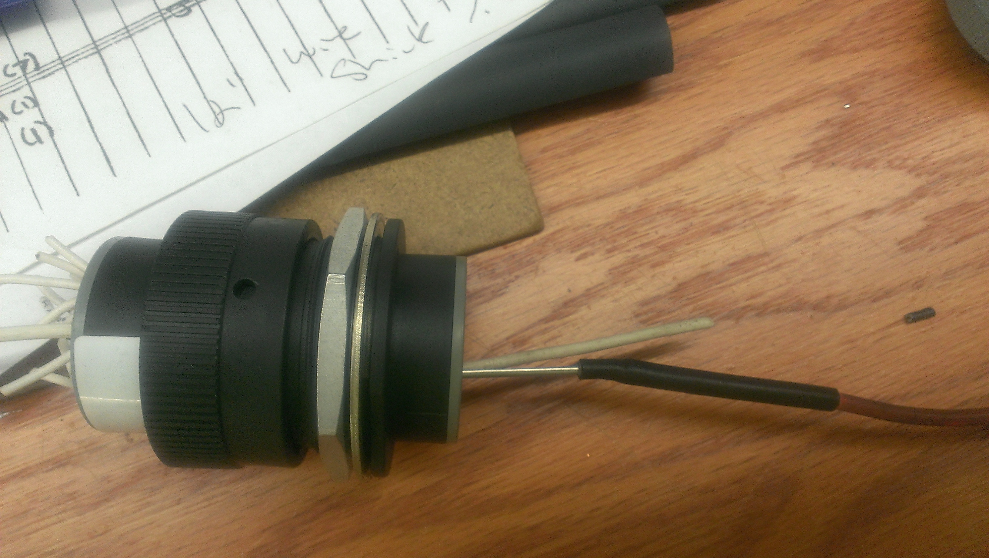

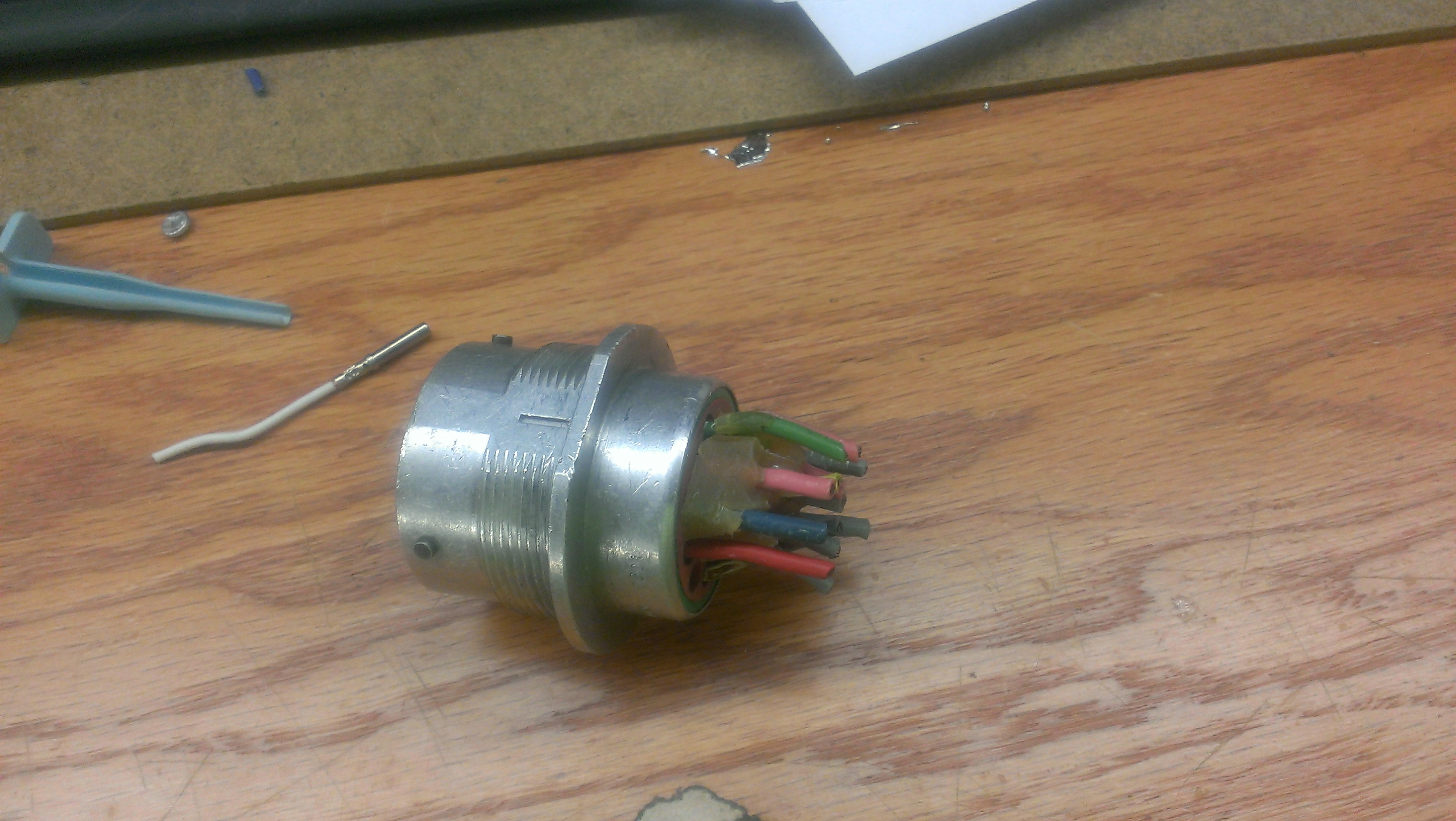

Now if your plug looks like this you are not going to be able to back probe.
I believe diesel crawler is talking about doing something like this.
Back probing will give you the best reading as the voltage drop could be in the plug.
If you can back probe,
One end of the meter goes to ground at the battery!, make sure you have good connection. back probe each wire and tell me what the readings are.
Next switch the ends of the meter, putting the end on the positive at the battery, tell me what readings are on all three wires.
before you are done I need battery voltage.
All readings are made with the solenoid engaged.
recap, when you are done you will have 7 readings.
3 connected to ground at the battery.
3 connect to positive at the battery.
battery voltage, all with solenoid engaged.
Now if you end up doing the last Picture. Which is the jumpers between the connectors, make sure you use an 18 awg wire. To small it will get hot and throw your readings off. In a nut shell you will make same readings as above. However, I would take the wire that you have going from the positive at the battery, once again making sure this wire is 18 awg at least. Disconnect the jumper going to the pull in winding, on the vehicle harness side and with the hold in powered up send 12 volts to the pull in. Based on what you have said above it should pull in as it sounds to me like you have a voltage drop on the pull inside of the coil wiring. Which is typical.

My guess at this point is with the jumpers I showed earlier in place, and an additional jumper from the ground to another good ground, you will find it will operate properly.

In any event I'm back on-line, the attached PIC shows the (3) jumpers (couldn't get white jacket wire so using GRN). Jumpers between Connector X5 on Solenoid to Wiring Diagram 651 Wht/Blu , 658 Grn/Wht & 115 Blk. Jumper wire GRN connecting X5 Wht & 651 Wht/Blu, Jumper Wire RED connecting X5 RED to 658 Grn/Wht and lastly Jumper Wire BLK connecting X5 115 Blk. I have another long jumper going to Battery Ground and connecting to Jumper BLK with Alligator Clip. AT Ignition RUN Position - Nothing, AT Start - Nothing. Thought perhaps with the direct ground to battery might get something.
If you remember during our last testing, I took dieselcrawler's recommendation to simultaneously jump Solenoid Wht & Red from Battery positive while Solenoid Blk connected to battery ground. That was only instance causing the Solenoid to retract.

So you have proven that tge solinoid does work. You have a wiring issue.
Nice job on the jumpers, exactly what i was picturing.
