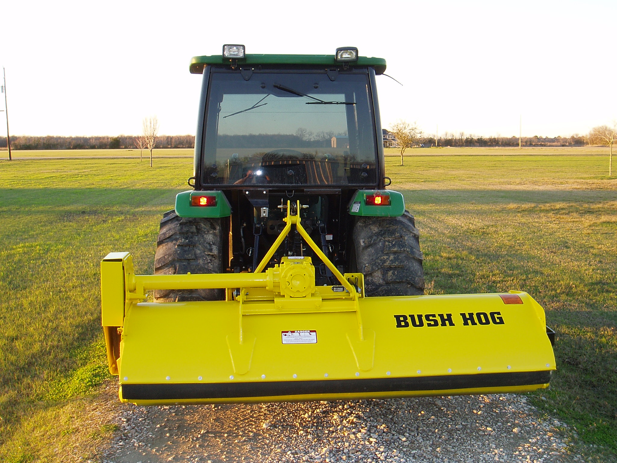

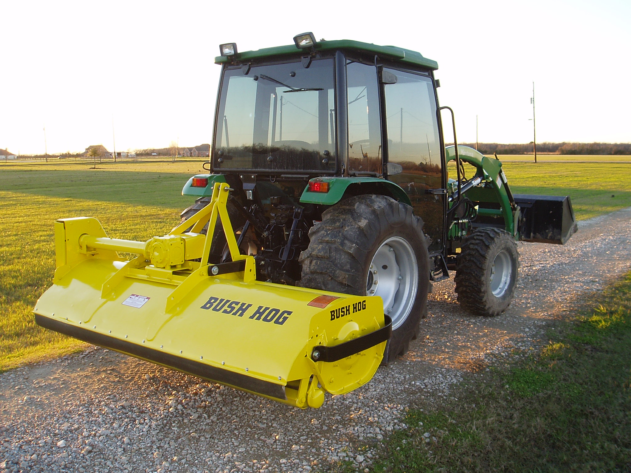

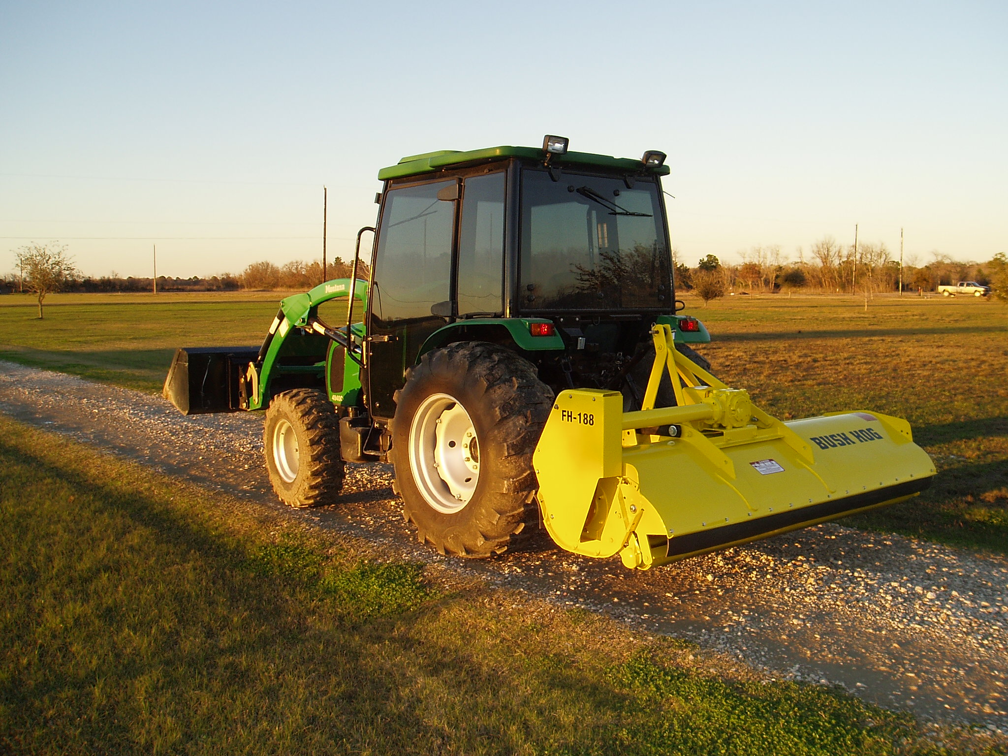

This is my Bush Hog brand flail mower that I bought used and cleaned / repainted. This flail mower had the tail wheel kit also, but I took it off and I just use the mail roller to support the mower in the ground and it works just fine.
I use this mower to mow bermuda grass with at a cutting hight of 1/2".

texasgreen: thats a nice mower there, I thought it was brand new. how wide is it--88''? what type of flails are you running for the bermuda? how much groundspeed can/do you run and how much do you usually cut off?
