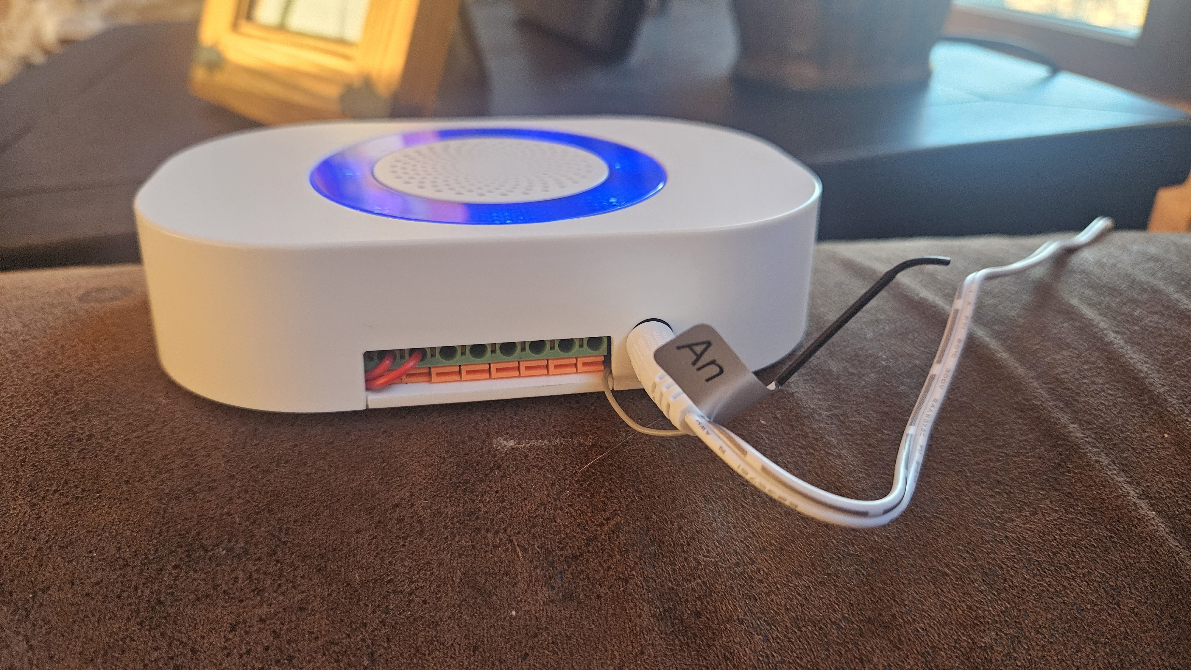

Also for anyone with this system or who may end up with one in the future the back of the reciever that sits in the house has a couple of relays as well as a 2 wire 12v dc output that is triggered when the reciever goes off. Dakota alert does not have a good option for additional alarms for other rooms such as a garage or basement, just a hardwired bell. After some searching I found this wireless doorbell extender that will work with DC and can be ordered with up to 4 remote chimes.
It works perfect with this receiver. The transmitter is small enough it can be hidden inside the dakota alert reciever with only the antenna sticking out.
We added a chime to our bedroom to wake us if anyone comes in at night and also one for the basement where we watch most of our movies. Being a half mile away and with a 1 mile drive it's very unlikely anyone is going to come in on foot. We now get plenty of warning someone is coming in and no false alarms from wildlife. The dogs after 2 days have already started barking and looking out the front door when it goes off.
