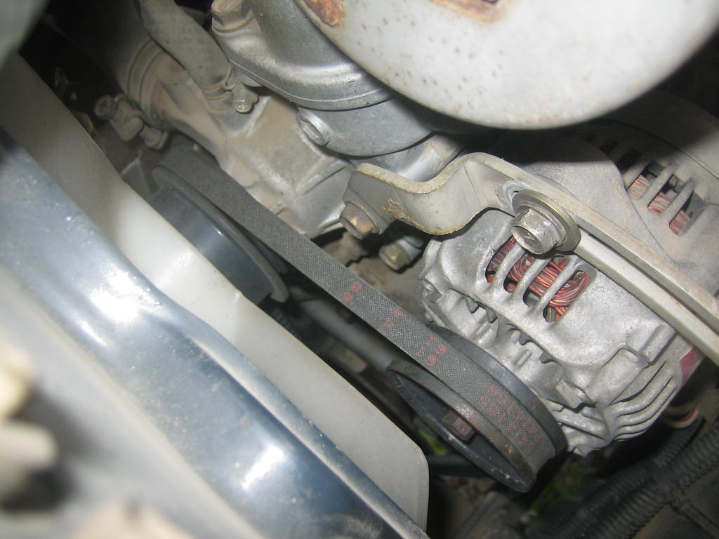

Check the tension on the fan belt, It operates the fan ,water pump, and alternator I believe. It may spin at idle, then slip at higher rpm. The belt may have stretched over the years. But probably the thermostat if you haven't heard any noise from the belt.

v-belt tight ?
The belts seems tight. Although I don't know how to check them when under load.??
I finally had to tighten mine up for the first time. The belt started squealing at high rpm. From the picture you can see how much it moved when tightened up. Adjustment is by a single bolt (12mm head) on the alternator bracket. The belt should deflect almost the thickness of the belt when depressed. If it is loose, it is very noticeable. The belt operates the cooling fan and the water pump, and seemed to be slipping on the driveshaft pulley. Slippage was at high rpm, just open up the hood and take a look/listen with the throttle wide open.

Thanks for the extra information. The belt on my tractor gives a little, but seems sufficiently tight given the teeth on the underside and I saw no slippage at high rpm.
