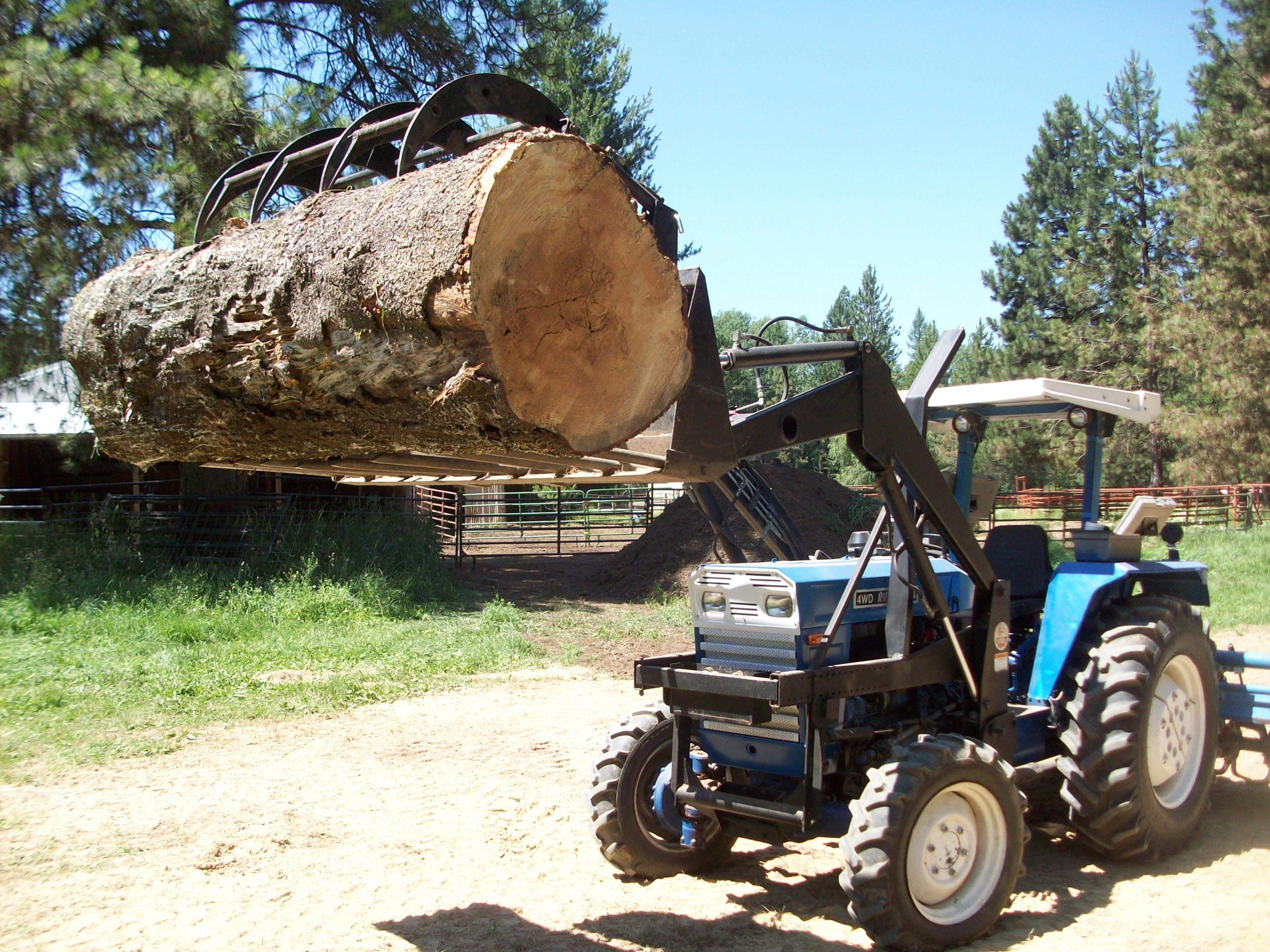

Moving & loading large trees/logs (old growth Pinion some up to 2-3ft diameter).

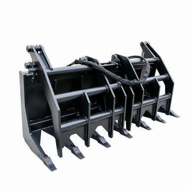

Express steel and tomahawlk both make quality USA built grapples that are strong enough for a large machine like yours. I would definitely be looking for smaller slots in the bottom like the one your showing here. They do make them with a solid bottom too.

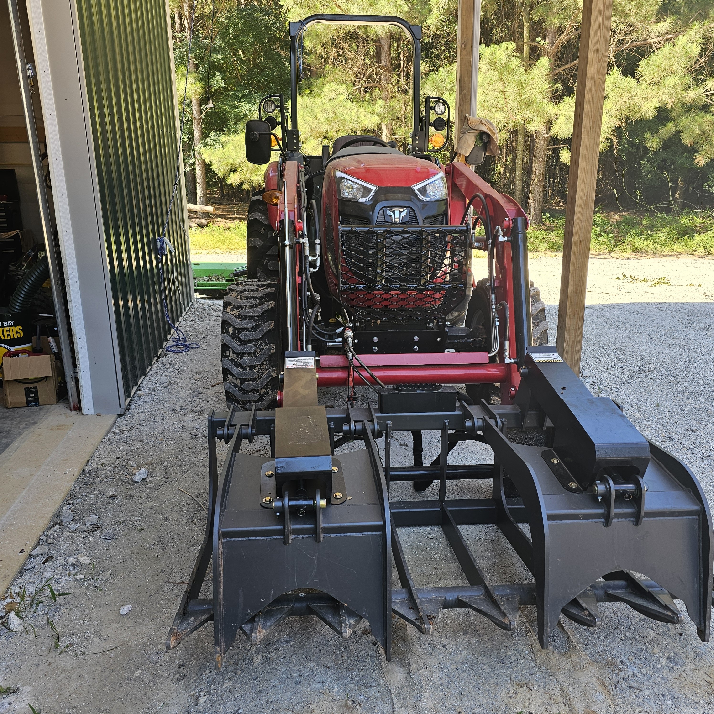

CID is great. It is affordable, strong and light. You can also add options like cylinder guards. Here's mine mounted on my 574.
In general, with grapple usually you get a little more narrow than tractor. They are going to hold 2X their width (or more). Weight is your enemy. It also helps when negotiating smaller spaces. Hard to tell from the photo, but mine is about 6" under tractor width.

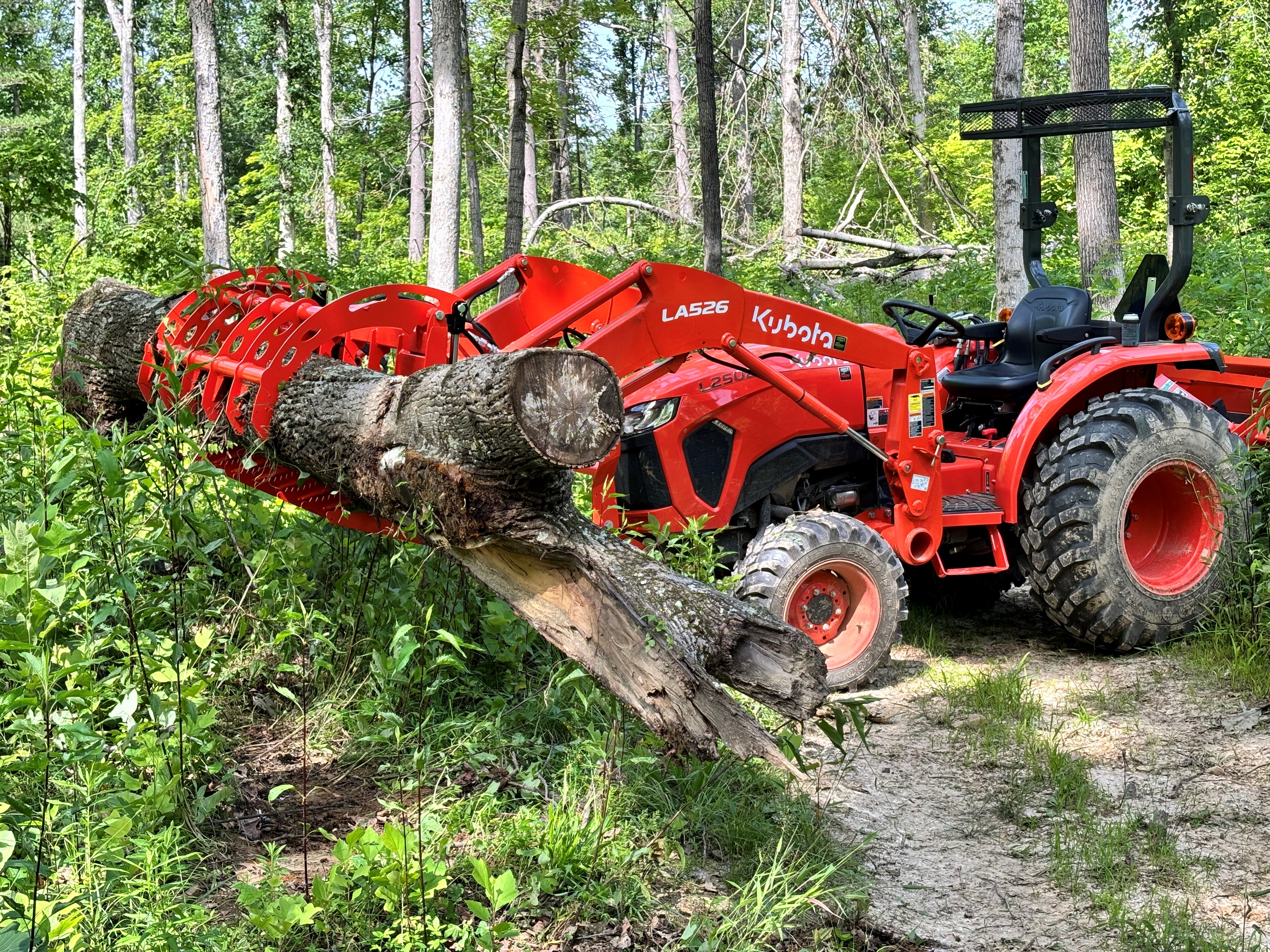

/ Help deciding on a grapple. #13

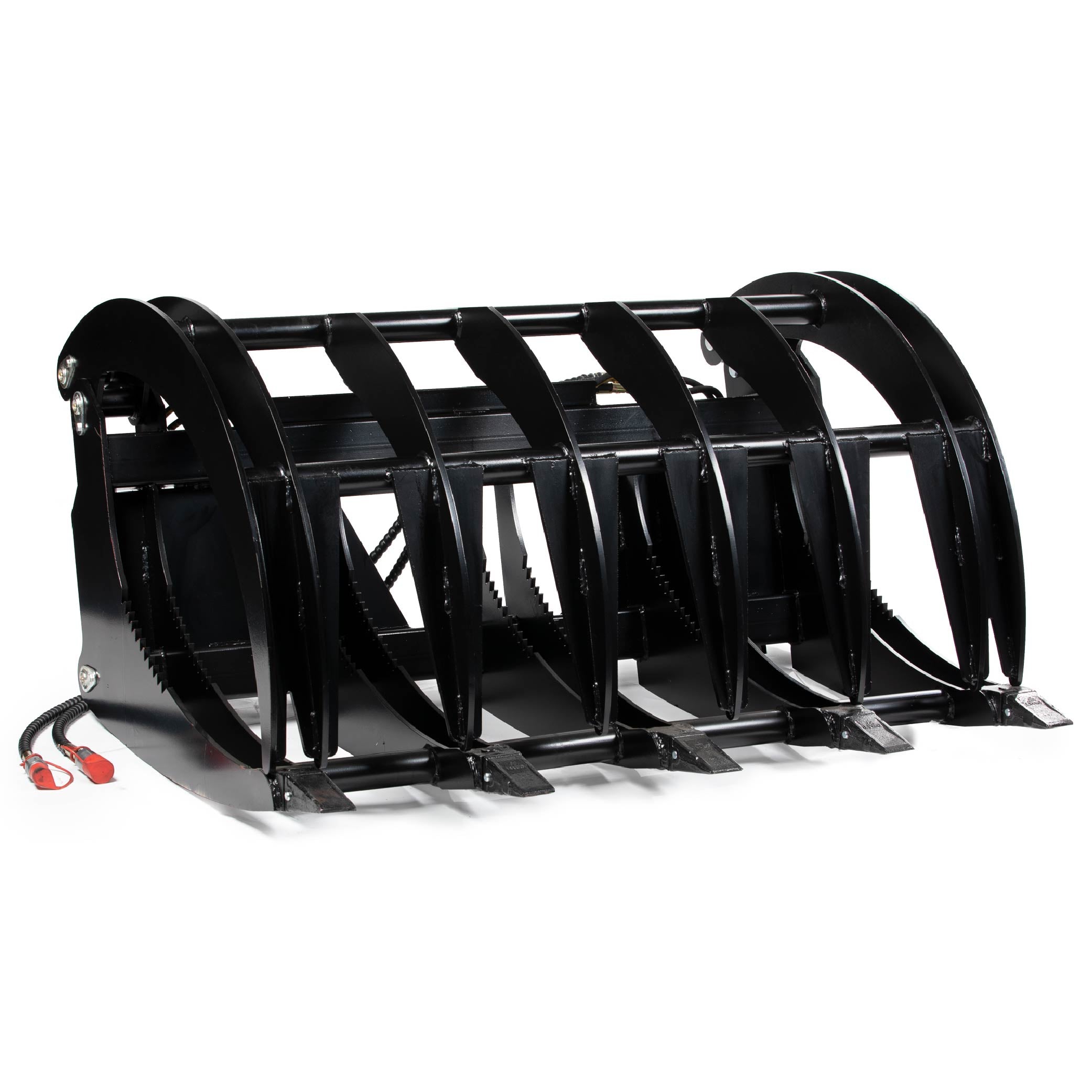

I have the Homestead Implements Pinnacle series root grapple with clam shell. It's a beast of a grapple that I use mostly for logging and cutting firewood and it works very well for that. I have carried some heftt logs out of the woods with it and then hold the logs at the splitter so I can cut to firewood size. I also use it to clear thick overgrowth around the property and it works amazing for rooting into the ground and digging stuff up. No regrets choosing his grapple.

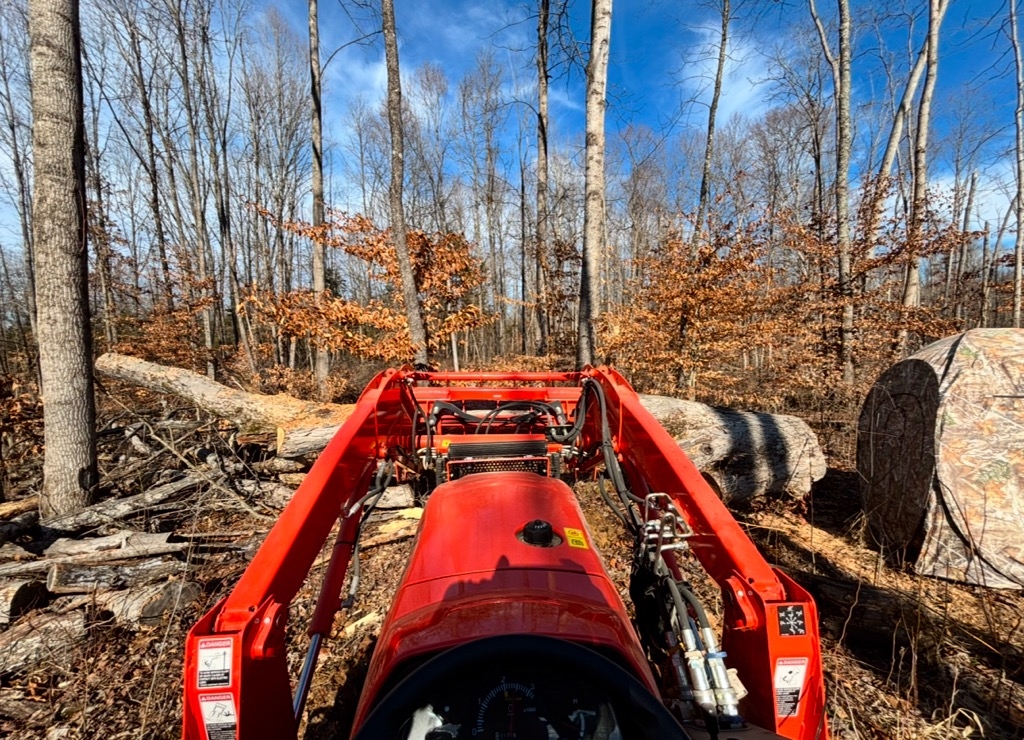

I purchased a 72" Bradco root rake in 2016 for $4,600 for the M59 TLB which has a 75" track width because I want the grapple to pick up everything in the tractors path so I don't run over what I want to remove. I scale at 10K+ lbs with loaded tires, grapple and backhoe.
I think your budget is light for a 105 gross hp tractor weighing somewhere between 5,700 to 7,700 lbs.
For gathering brush, debris, trash, you want the widest possible opening to grasp the greatest amount in am single bite, particularly with cleaning split wood of the ground. I've attached the Bradco spec below.
Second pic is Siberian Elm with my hand to give some idea of log size. Third is saw logs. Forth is mouth full of rocks. Last pic is moving tree tops. ps. I have no idea why images posted in reverse order.

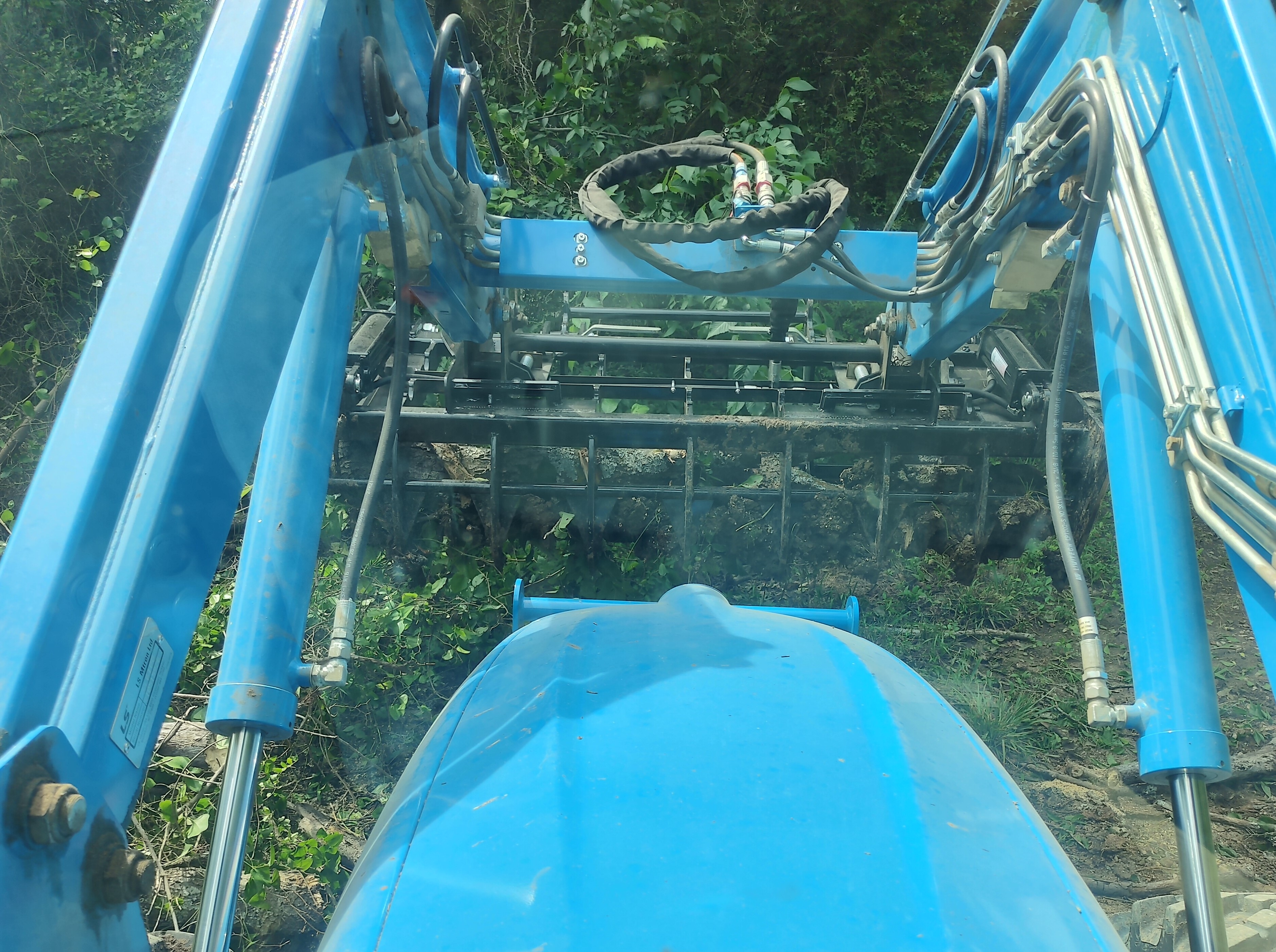

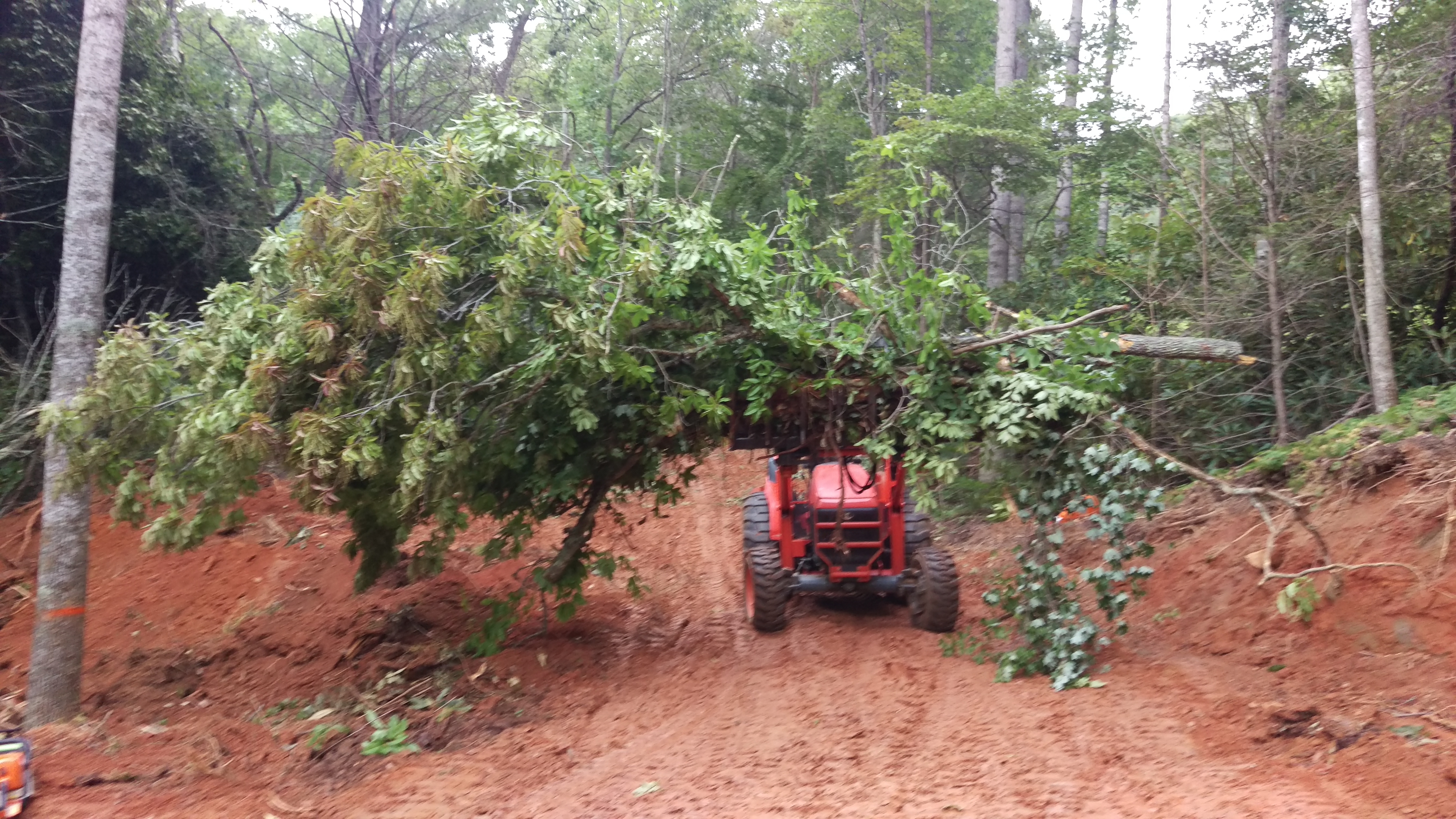

/ Help deciding on a grapple. #18

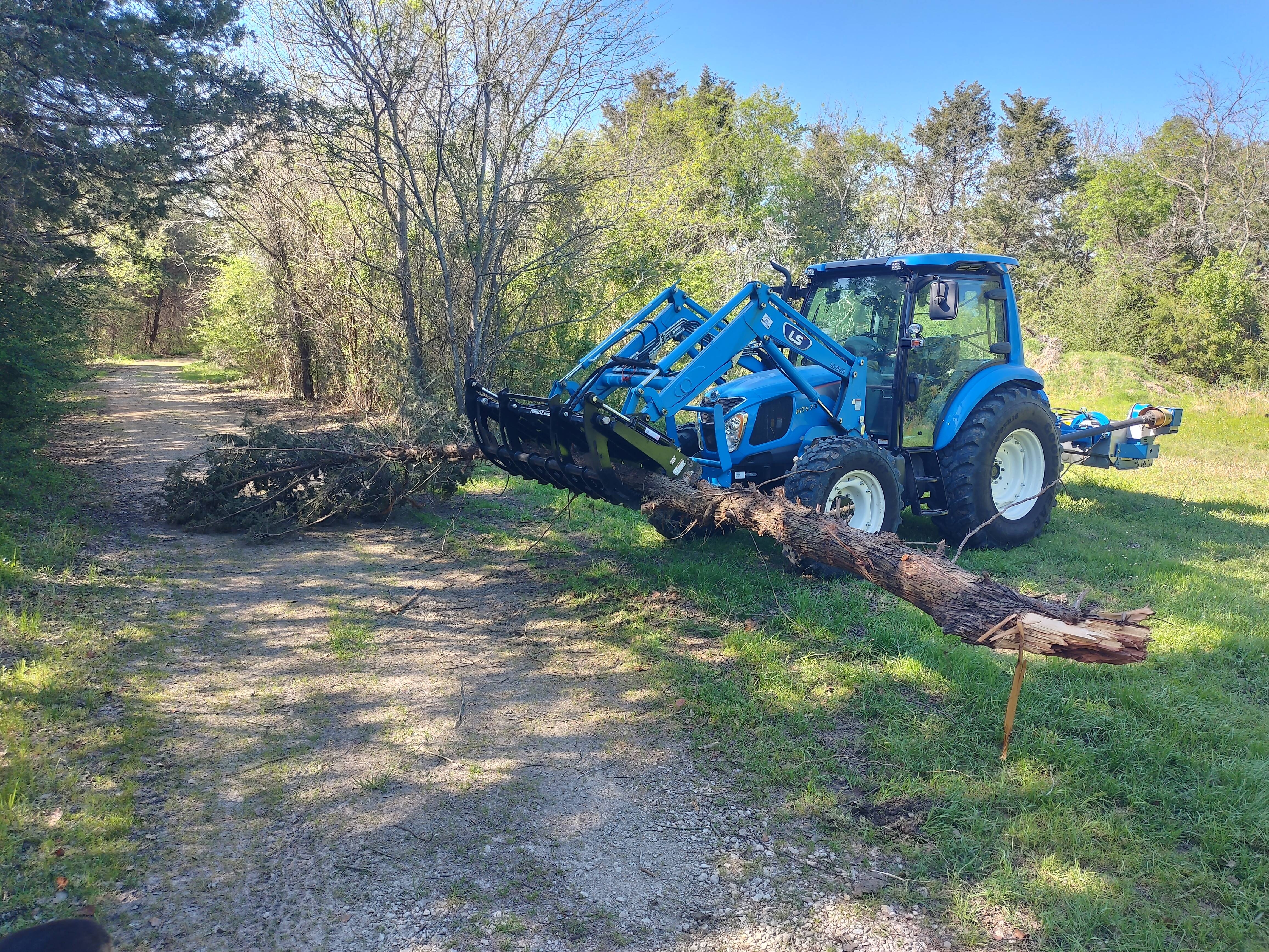

OP, at least look into Homestead grapples. I use a Pinnacle root grapple with a 73hp tractor
and it has held up really well. I've picked up tree trunks, pulled sticker vines out of trees,
moved logs vines and limbs into stacks to p/u with grapple. Dug out and pulled out a
few smaller whole trees.The more you use it the better operator you'll be.
Btw, Homestead delivered on time. It arrived the day they said it would be here. Delivered
to my farm. (you will need pallet forks to unload from truck). Good luck in your search.
