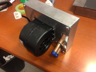

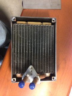

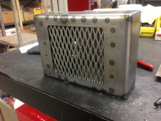

i've got a tuckaway heater in my rtv 500 its plumbs into the water cooled systems, its very small and was not too high either, looks a little smaller than the one listed above and its also has the window defrost.
Sounds pretty interesting. Was this something you purchased? If so, can you tell us what it is and where you found it?
