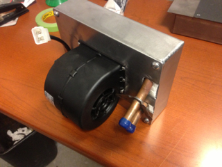

I so far have been able to build one for less than 100.00 bucks, for my RTV 900.

So this past weekend I got around to finishing my budget heater install and it COOKS :)

Chad, that is really compact and a small heater core is more than adequate. Do you have a provision to send heat directly to the glass area?
/ Heat for UTV's with cabs #33
I have plans to add defrost ducts, just no time at the moment. We got about a foot of snow last night while plowing it stays so warm the snow just runs of the glass. :)

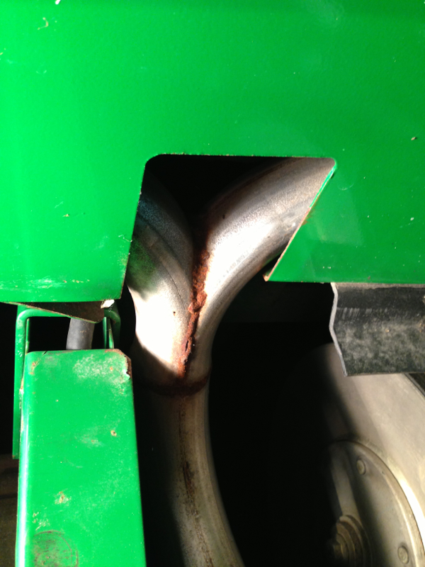

I like the idea of using a renewable resource. I chose to re-route my exhaust through the cab. It serves two purposes. Keeps the exhaust above the cab when plowing and backing up and provides heat.
Here it is in action.
http://www.youtube.com/watch?v=0g30nijylf0&sns=em
/ Heat for UTV's with cabs #35
Well ill be... That's a unique set up! Amazing what the imagination can come up with.
Do you have a way to shut it off in the summer?
/ Heat for UTV's with cabs #37
Since I am not plowing, I put the original muffler back on and it routes out the back.
Ed
Sent from my iPad using TractorByNet

Thank you all for the weaalth of informaation. I especially like the idea of running the exhaust through the cab. Rather then through the cab have the end terminate in the cab?
<img src="http://www.tractorbynet.com/forums/attachment.php?attachmentid=293859"/>
<img src="http://www.tractorbynet.com/forums/attachment.php?attachmentid=293860"/>
<img src="http://www.tractorbynet.com/forums/attachment.php?attachmentid=293861"/>
<img src="http://www.tractorbynet.com/forums/attachment.php?attachmentid=293862"/>
Just a word of warning, small planes use exhaust for heat with a heat exchanger. They have carbon monoxide detectors on some of them in case one would develop a crack. Just thought I would mention that with that Y in the cab.
