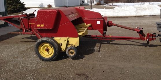

Another old girl (bailer that has been around the field a time or two. Appears to be a Hayliner 66 which in it's day was a good machine (I had one starting out and sold it to a hobby farmer and found out later that the original owners manual and shop manual which I had, was worth more than the bailer itself. The issue with an old bailer is everything is chain drive and chains stretch with use and ocassional maintenance. Everything gets sloppy and your bales get sloppy too. New balers are all gear drive. Knotters remian the same except hardened bill hooks are SOP now. Even my new 575 uses the same gearbox your old girl uses. If it's good, keep it.

It's a s68 Super Hayliner. It works pretty well, at least as well as a stock Hayliner from 1958 can. When I was growing up we used an early 1950's vintage IH baler my dad bought for $100. We made a lot of good hay with that old baler.

I ran a 66 for years but the chains are a PITA. The new generation balers have no chains, all gear drive except the hydraulic pump for bale tension and the packer forks and they bale at least 3 times as fast or about half as fast as round baling plus the pickups are much wider but like anything else, you need a steel hinged wallet for one. You can get one point greasing for the knotters (which I don't because I don't trust single point greasers, hydraulic tougue swing (nice) and knotter blowers.
