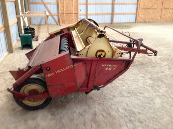

Tested the Haybine on some old tall dead grass, and it worked like a champ. I still want to replace the knives as I don't think it will work as well on green and growing stuff. The baler knitters also worked great. I think I'll sharpen the piston knife and top off the main gearbox but otherwise it looks like I'm ready to make some hay.

I lubed the chains on the Haybine with a spray-on chain lube that goes on wet but supposedly rejects dirt and dust. We shall see. I will probably not lube the timing chains that drive the knotters on the baler.

After replacing the knives and bushing on the cutter bar in the Haybine last night, I took it out for a test run tonight. The old girl cuts like a champ!

I've got an experiment going with the NH cutter bar bushings. I repaired a couple using Devcon Flexane castable urethane. A $40 kit will repair several bushings. I'll let you know if they hold up. Another week or two and it will be time for second cutting. Mostly waiting for the weather to dry up!
The haybine sure makes a lot of racket when a bushing goes.

Second cutting is on the ground. The Devcon repaired bushings don't hold up at all. Ended up making a run to get parts! I didn't use the compact to mow though. The 720 got the job today.
