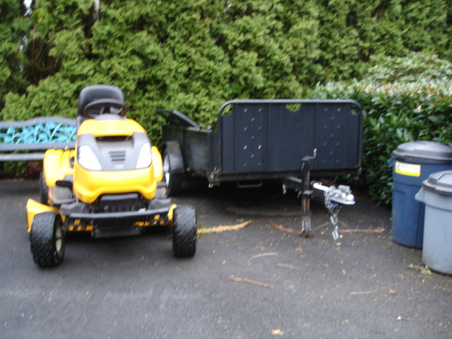

/ Having fun cutting grass.
HI you guys. Here is a pic of my super Home Depot bargain.
In an earlier post I told of getting a i1040 for almost half price and a trailer for a way less than half price.
Get to know your Home Depot manager.
