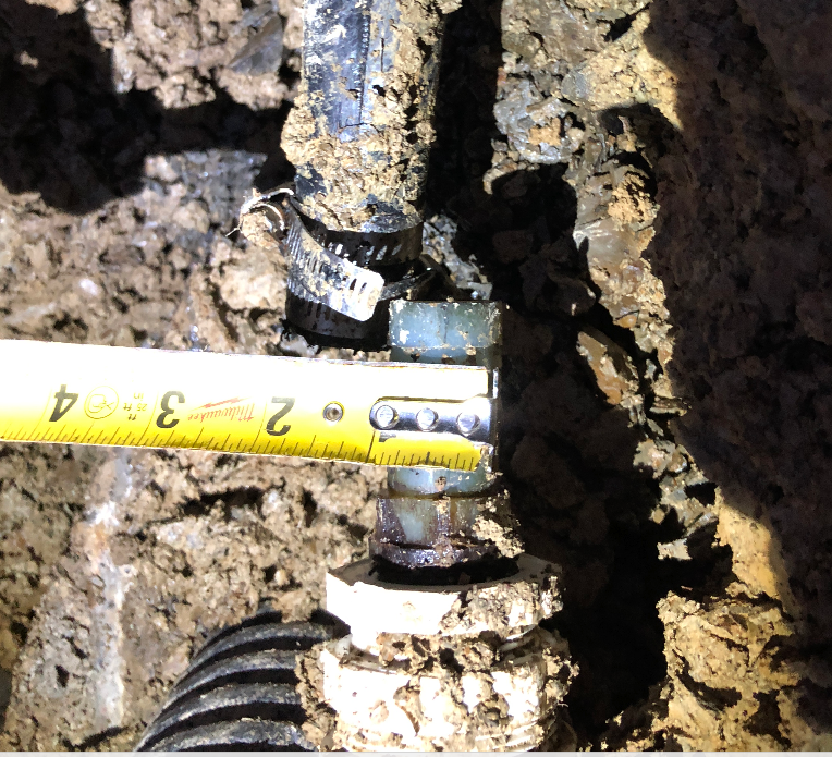

I do see water, but it doesn't flow very fast. I think I found the issue though. I dug around where the 1 1/2" discharge line is and it comes out 1 1/2" PVC but there is a reducer that goes to 1" then to black poly pipe. So if my pump can pass 3/4" solids and it goes into a 1" pipe, it's definitely going to clog up.
I haven’t seen raw affluent pumped in anything smaller than 1 1/2”. Looks like the previous install was a real sh...t show! In more ways than one. Glad you found the issue.

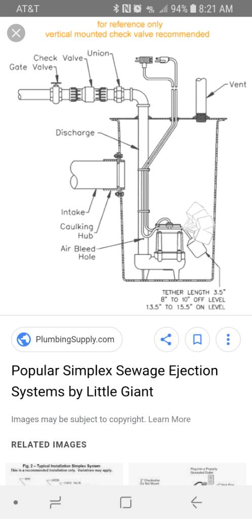

Yep, that would be the restriction.
Those pumps are designed for 1.5 to 2 inch pipe.
For a 225 foot run, I would think 2 inch would be recommended.
You will need to run new pipe and make sure you install a check valve close to the pump and a gate valve after the check valve.
The gate valve is so you can service the check valve and the pump in the future.
Here is a diagram and a link in case the diagram does not display properly from my phone.
Google Image Result for https://www.plumbingsupply.com/images/sewage-ejection-package-typical-installation.png

Good drawing. But for scale the pit in the photo is only about 18” deep. This puts the check valve within about 2 vertical feet of the pump. In the OP’s case the check valve etc will need to be in the pit next to the pump......I thank that’s what he’s describing anyway ;^)
