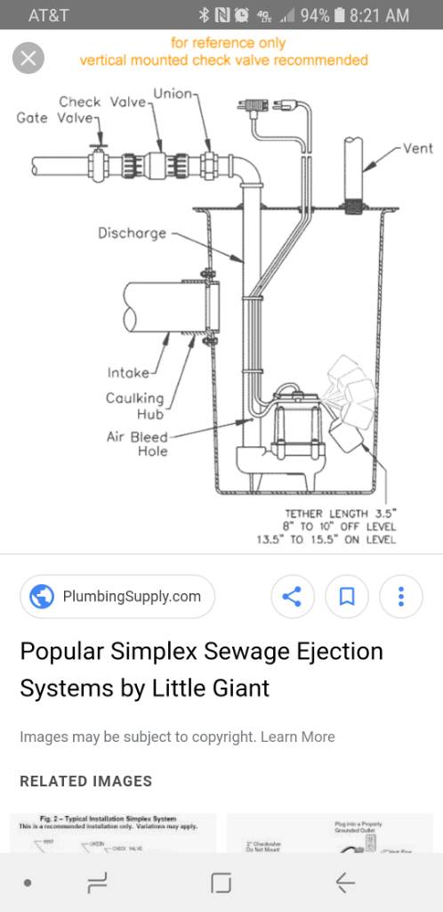

One piece of advice I followed was to install a back flow valve in the pump outlet line but also to drill a small (like 12") hole in that valve. The reasoning being that the down rush of the pipe full of liquid could actually damage the pump motor.
Also due to the rocky terrain it was almost impossible to bury the pump line below the 4" frost depth and the leak hole in the valve insured that the line was normally dry.

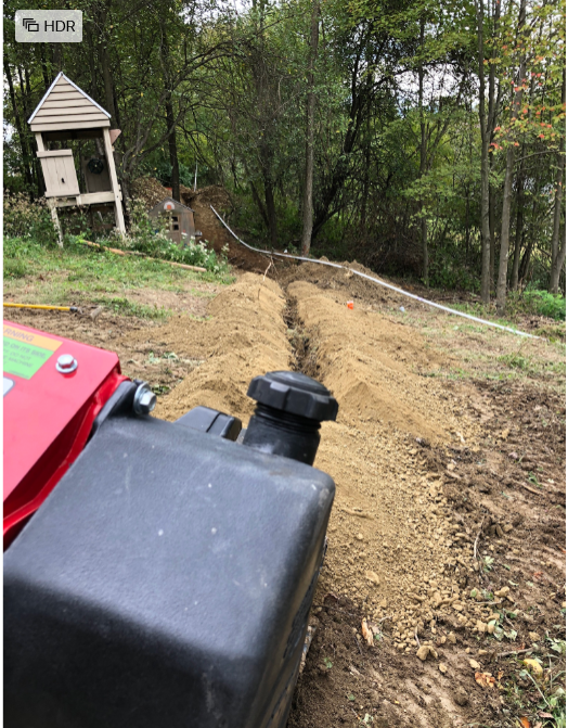

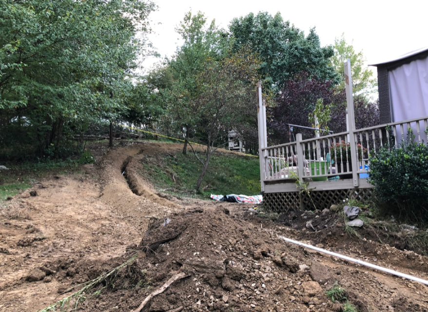

To confirm, the city sewage is uphill from the tank maybe about 20'. This is common around here since the city sewage happens to be available at a higher elevation. The leach field was elevated also. It hasn't rained for about week now. I've been checking the tank and it is filling up again. I can hear the pump running, but I am wondering if the pipe that goes to the city sewage may be either blocked or broke. The pump ran all night and the tank level did not go down. BTW, I did replace the pump with a new one when this all started. I am going to try to snake the 1 1/2" line to see how far I can get. What would be a good way to find out the exact elevation different of the septic tank and the city sewage manhole? I'm guessing at 20'. I would like to get a better idea. I found an Iphone app, but it was flaky.

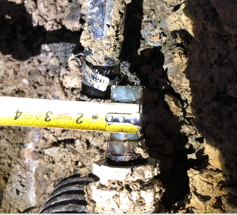

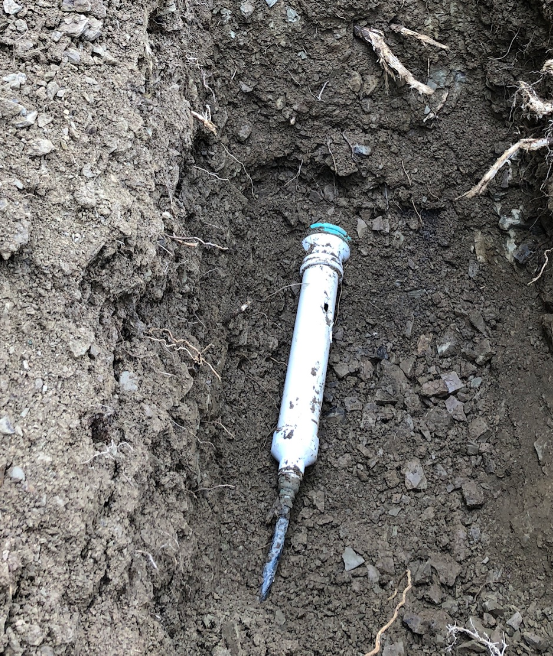

There is a back flow inline on the vertical part of the pipe where it comes up from the pipe. I disconnected after the back flow and water was coming out really good, so I think that is ok. There has to be a clog between the manhole and where the pipe leaves the septic tank. Or the pipe is crushed which i find hard to believe. It looks like schedule 40 pipe and of what I can tell, it's buried about 3' down. Once the rain subsides, I am going to measure the distance so I have a better number of how far the manhole is from the septic and also check elevation. This way I have some real numbers to go by. I am going to get a 100' 3/8" snake and try to push it through the 1 1/2" pipe. There should be no resistance unless there is a blockage. Of what I can tell, there should only be 1 elbow close to the tank that I have to snake past. Other than that, it should be a straight line to the manhole.

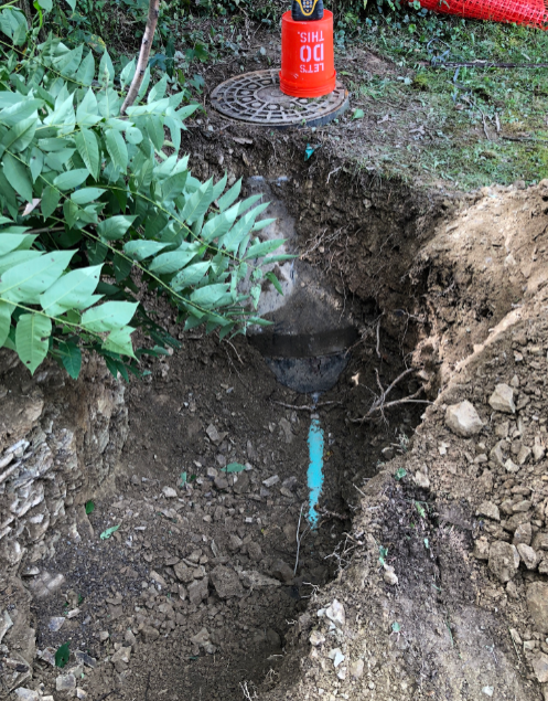

When I pulled the manhole cover, there are only 2 lines that go into it and 1 line that goes out. The manhole was empty other than my line pumping water in. It wasn't pumping very fast though, it was more like a heavy trickle. The neighbor has the other line in the manhole. He kicked his pump on and it was pumping at least 5 times faster than mine. It was gushing through.
My roof is about 20' up from my septic. I could put my rotary laser level on top of the roof, then walk up the hill to the manhole with my laser receiver and wait for it to go off. I could mark the spot on the ground and go from there.
