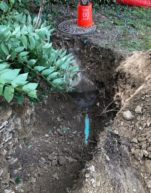

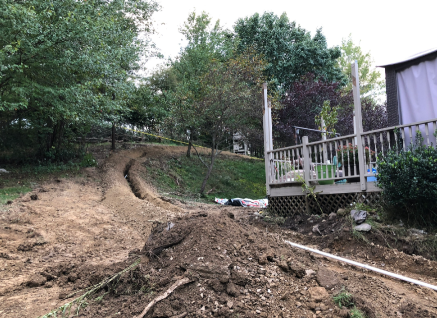

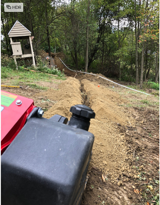

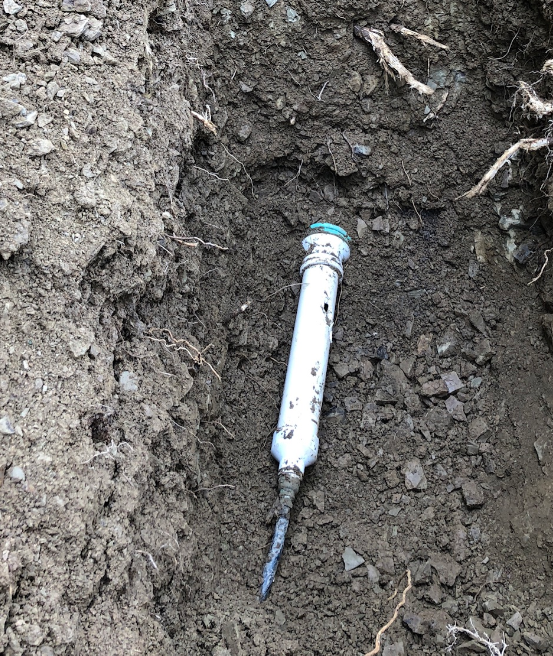

The first picture is the manhole. You can see the 6" pipe stub out. I dug about 10' back from the manhole a found where the 6" goes to 4", then down to the 1" black poly. I still cannot believe they ran that. I got the trench dug and got the 1 1/2" line ran. Now I have to call to get it inspected. Next weekend I'll install the grinder.
   / Have a weird Septic issue #53
:shocked: who ever though that would be ok?? At least they could have upsized the black poly. :duh: good job figuring out your dilemma.
