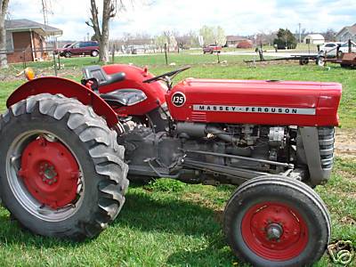

Was wondering if anyone could tell me if I could haul a Massey Ferguson 135 on a Uhaul auto transport trailer. I am unsure of the year of the tractor and am posting a pic in case it helps.
The weight of the tractor should not be a problem, I am just worried about the width. I can't find the trailers minimum width, only the maximum.
This is the info on the trailer:
Max load: 4,000 lbs
The vehicle being towed:
Must have a maximum outside-to-outside tire width of 75"
Must have a maximum wheelbase (distance from front axle to rear axle, usually posted on the driver's side door jamb) of 133 inches.
What do you all think?

I would guess that the inside to inside on the places the wheels go is between 51 and 39 inches wide (making the ramps between 12 and 18 inches wide).

To put it all in proper perspective, a 135 is SMALLER (width and length) than most cars. You'll be fine as far as physical size. Weight might be an issue. I see U-Haul's specs say max weight of 4000lbs. A 135 will weigh in slightly more than 4000 and if the rear tires are fluid filled, quite a bit more than 4K.
I see the PAVT rear wheels..... (Power adjustable variable tread) In the position they appear to be in, you should probably expect 68" to 72" outside to outside on rear tire width.
/ Hauling a MF 135 #5
75 inches is 190 cm... Common trackwidths for the 135 were 135 or 150 cm, with 12.4-28 standard tires that gives you 10 to 25 cm to spare.
Given the spacing between mudguards and wheels, i assume its 150cm trackwidth and 12.4-28 rear tires. This tire size wont hold much water, so you wont be much overweight.
My 3011 is about the same size and weight and it towed fine behind my 850 TDI at around 110 km/h. I did use a 3.5 ton trailer with proper brakes and tires though.
/ Hauling a MF 135 #6
If you are OK with the weight the trailer should work.
Worst case would be you may have to adjust the wheel spacing on the tractor to load it.
Front and rear spacing can usually be set in range of 52" to 72" center top center, more or less.
Figure rear tire width will be approx 12".
I can't tell from the picture exactly how wheels are set, but you should be OK. Take some tools just in case.

Thanks for everyones input. I will be going to pick it up this weekend. Then I can run the serial number and figure out what year it is. All I know is it has a 3 cylinder Perkins engine, which I thought was strange for a gas burner.

Just wanted to clpse out this post with a big thanks for everyones help. I got the tractor home this evening, she fit perfectly on the uhaul auto transport trailer. Will be starting a new post shortly in the proper forum to get some suggestions on getting this old girl back up to speed. Thanks again.
