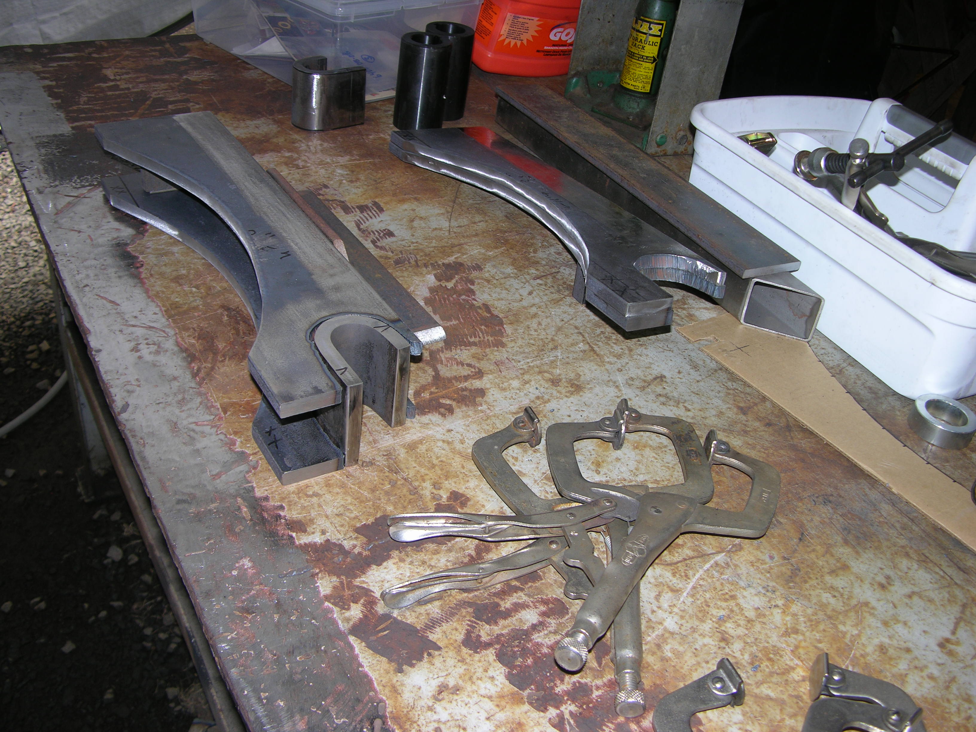

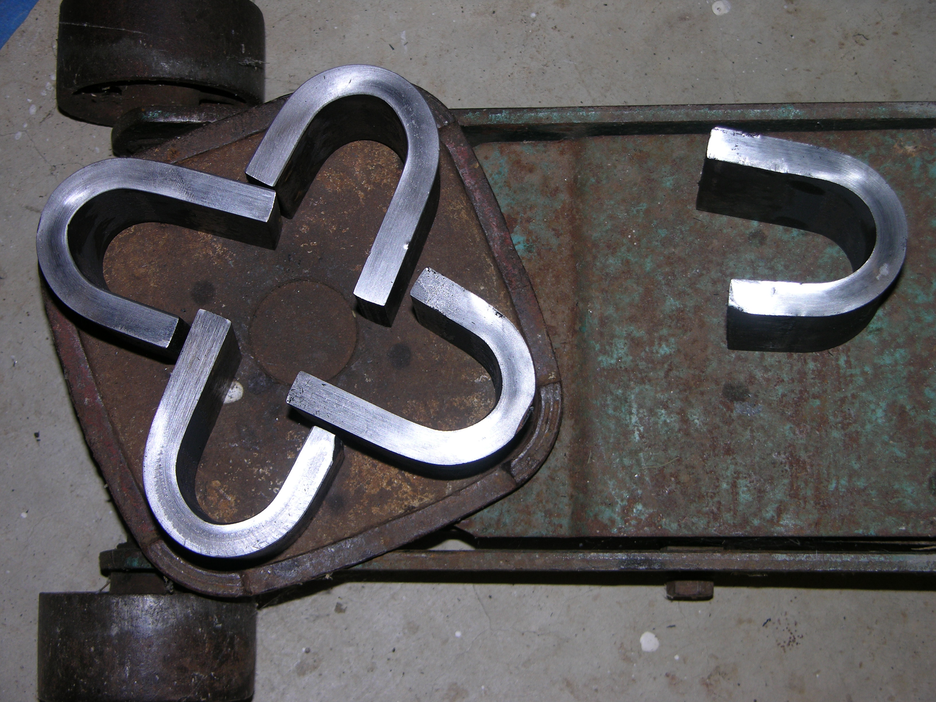

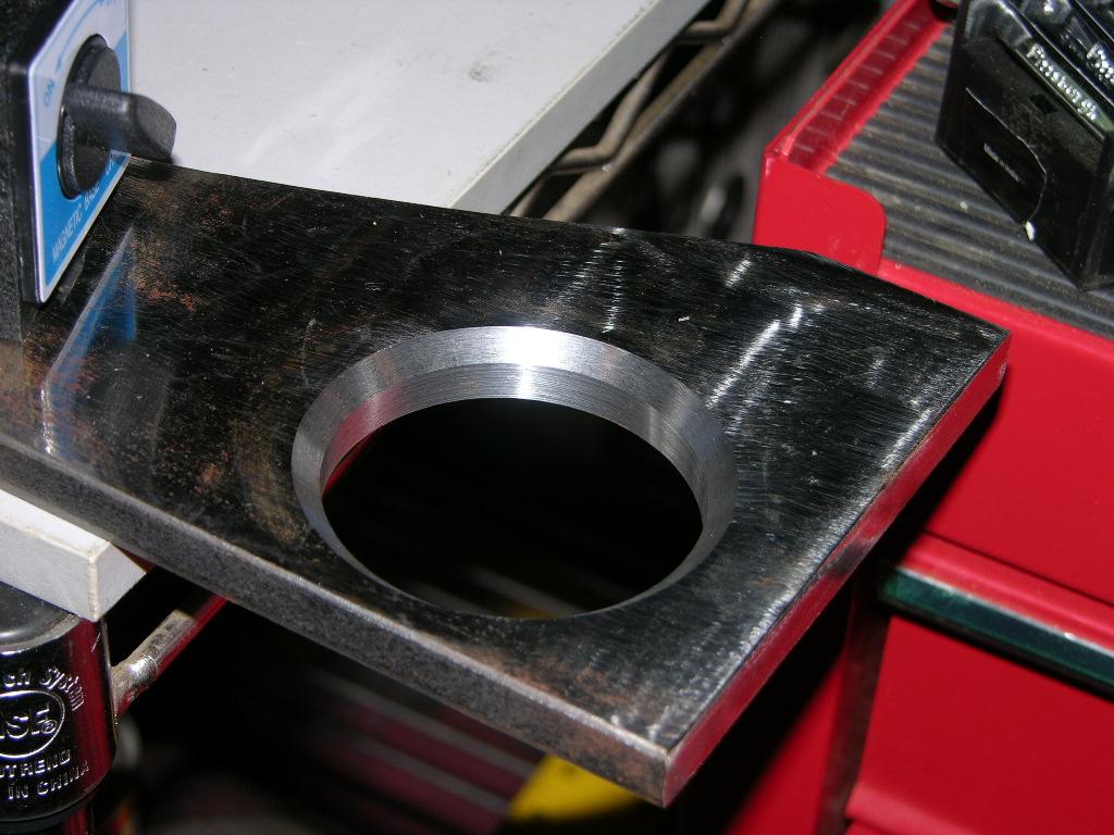

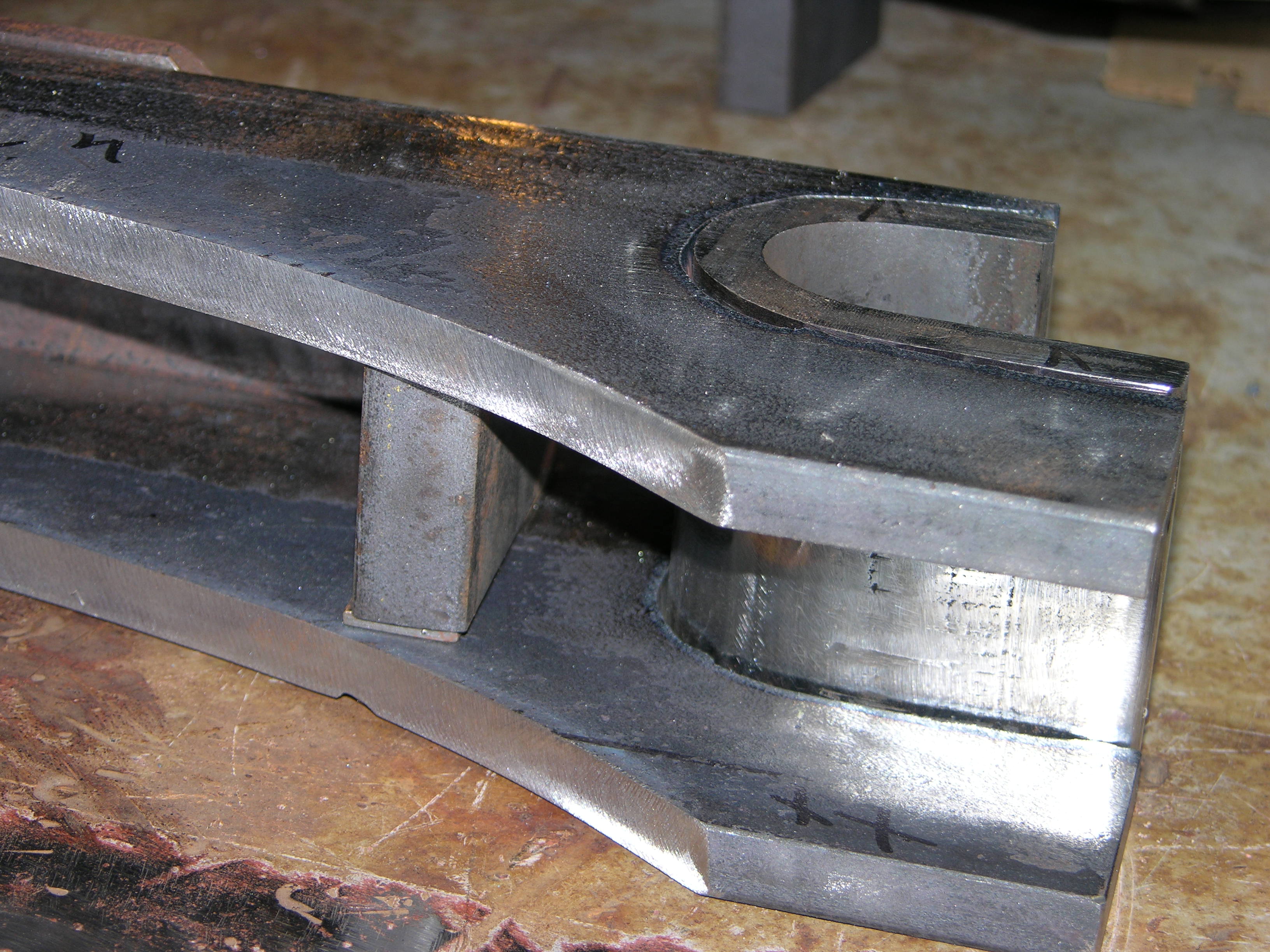

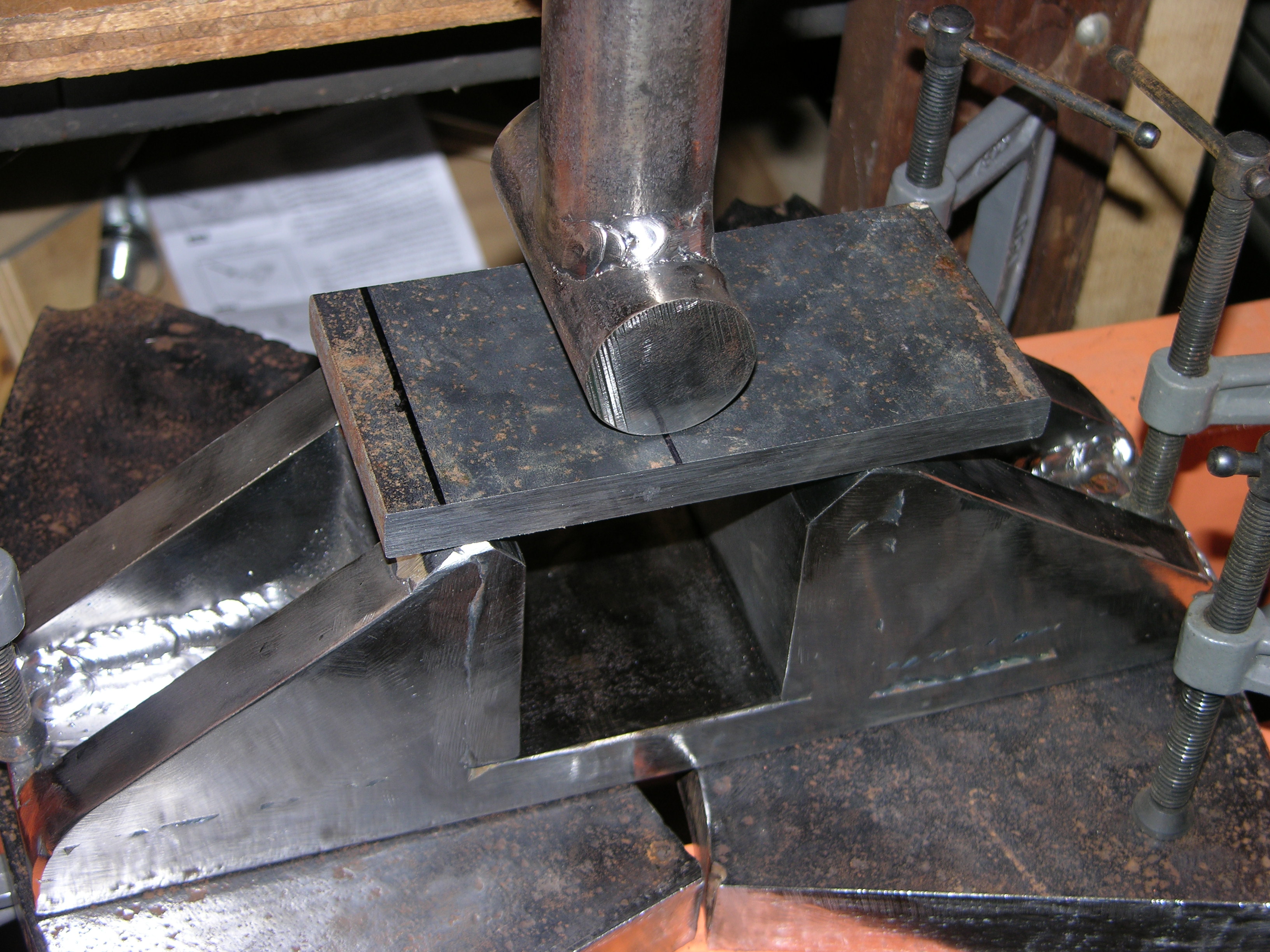

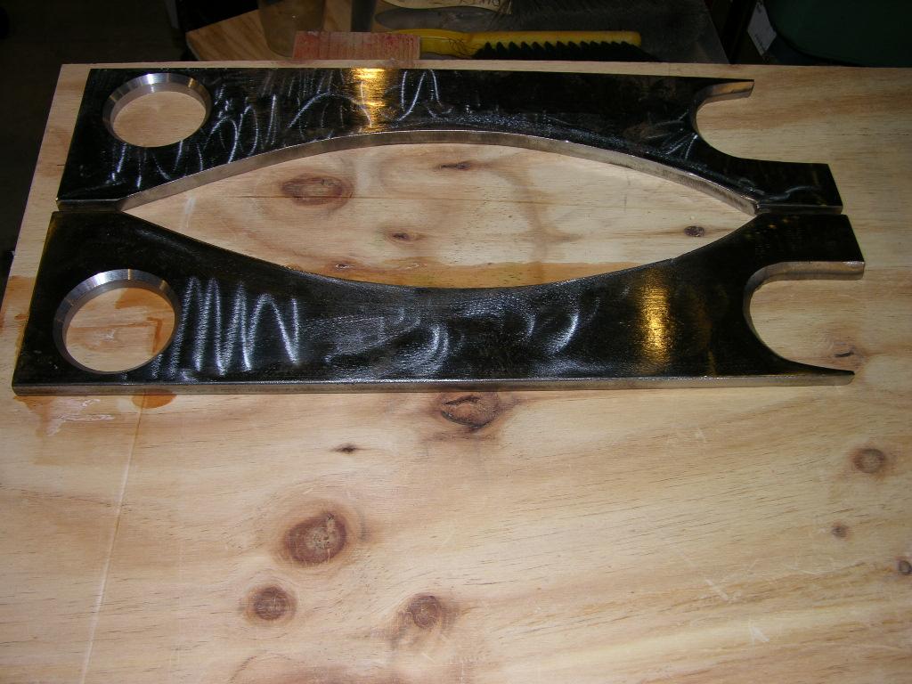

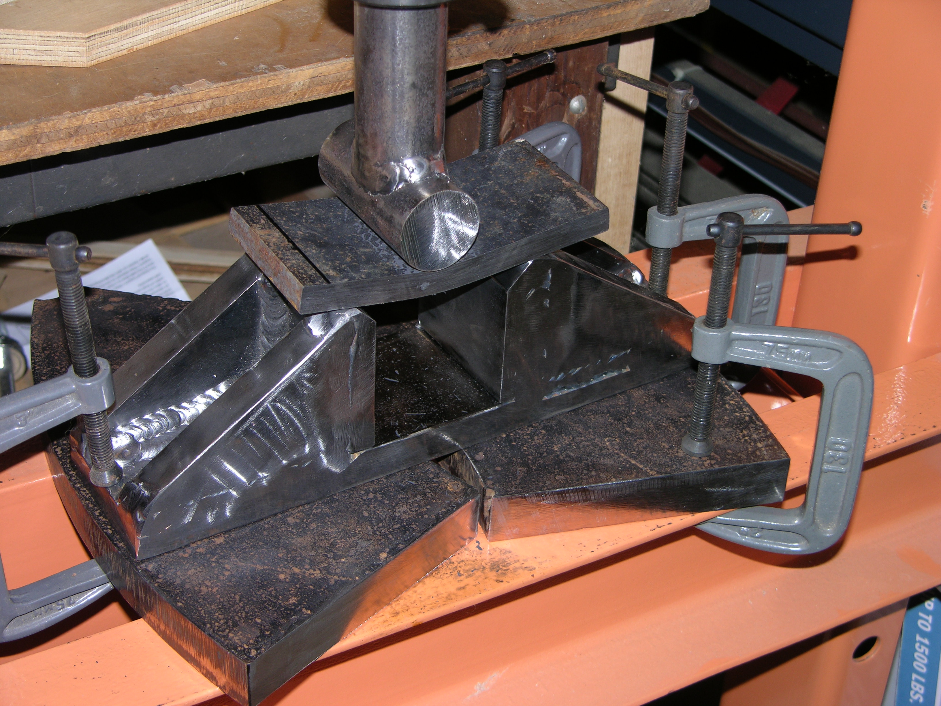

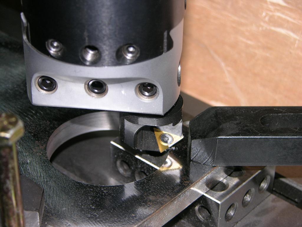

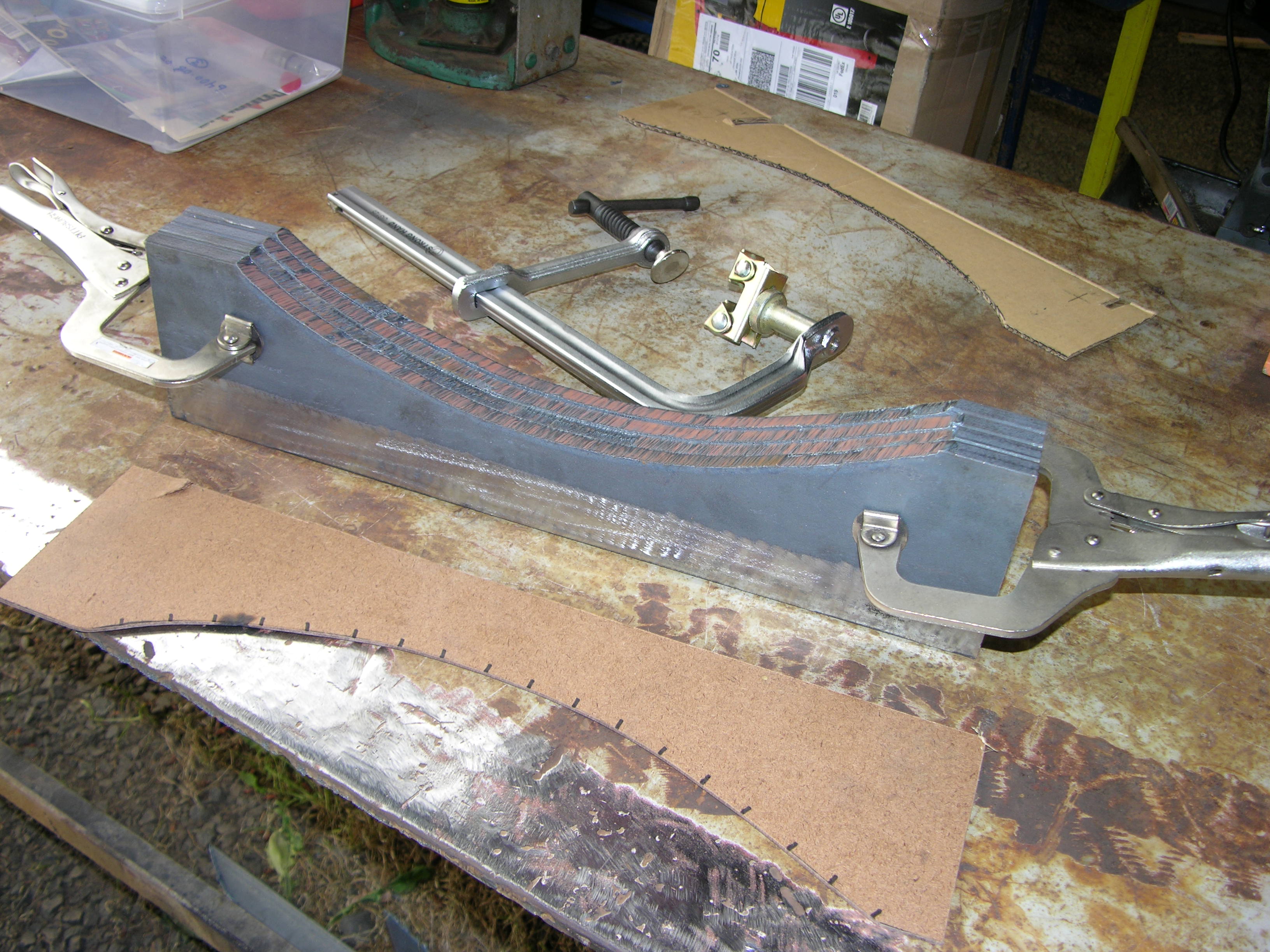

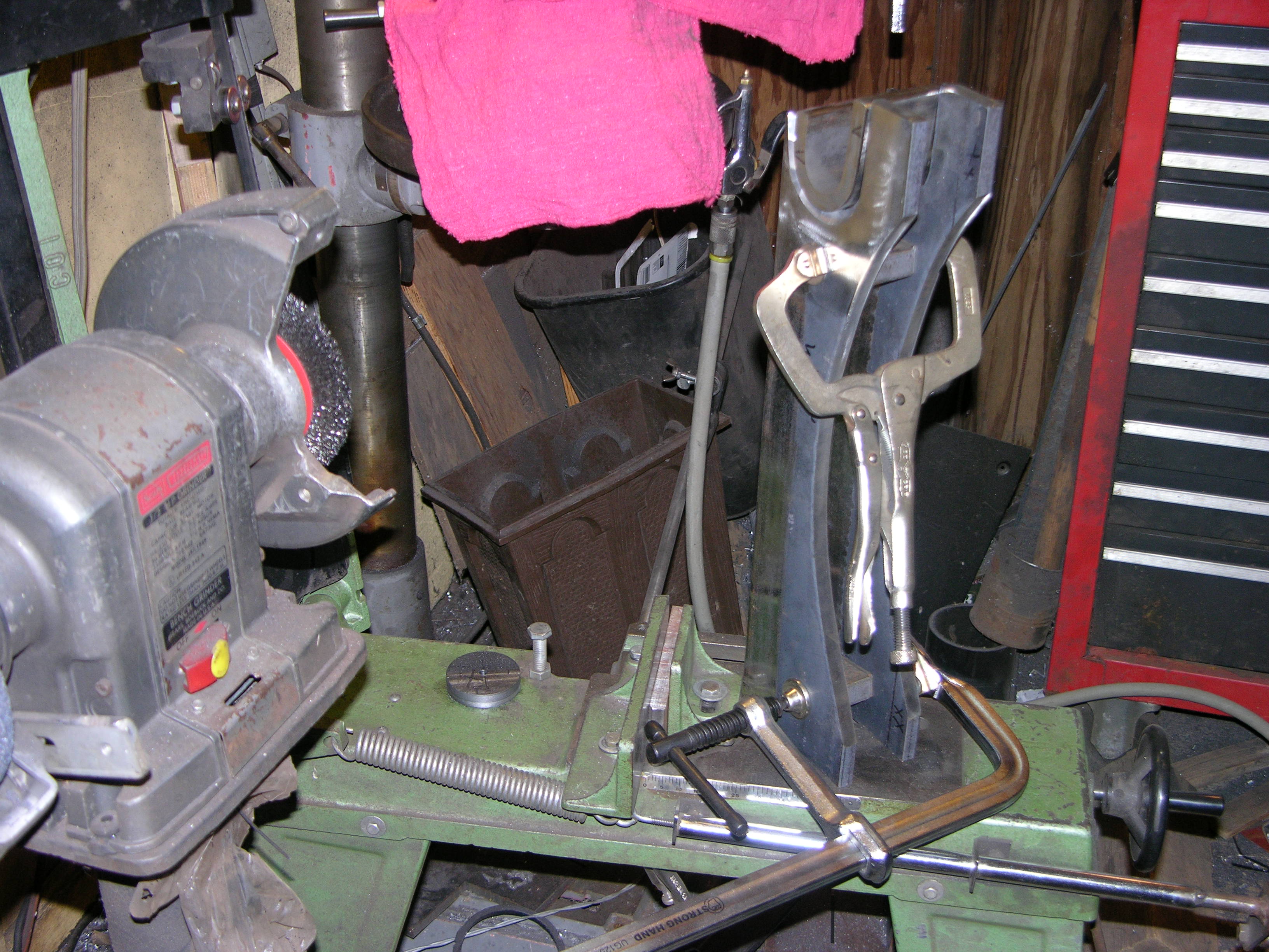

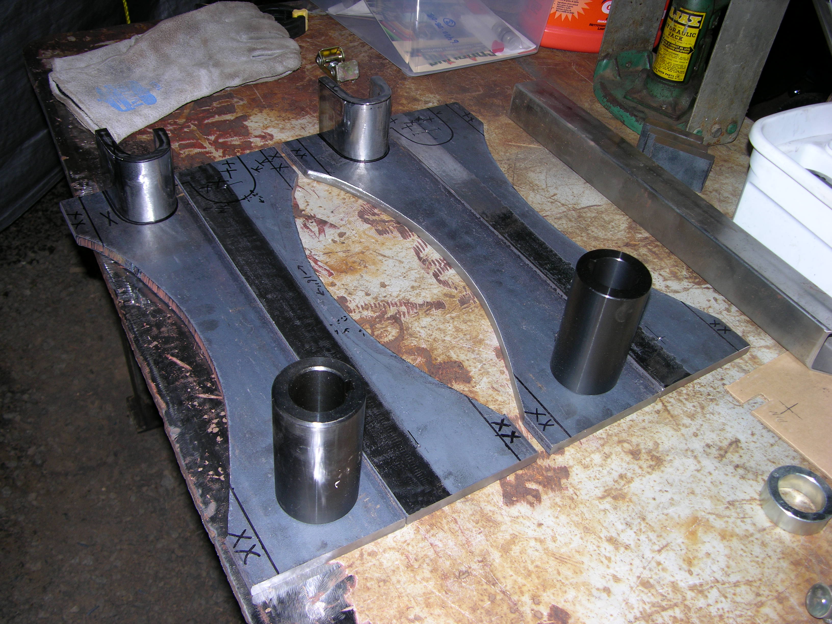

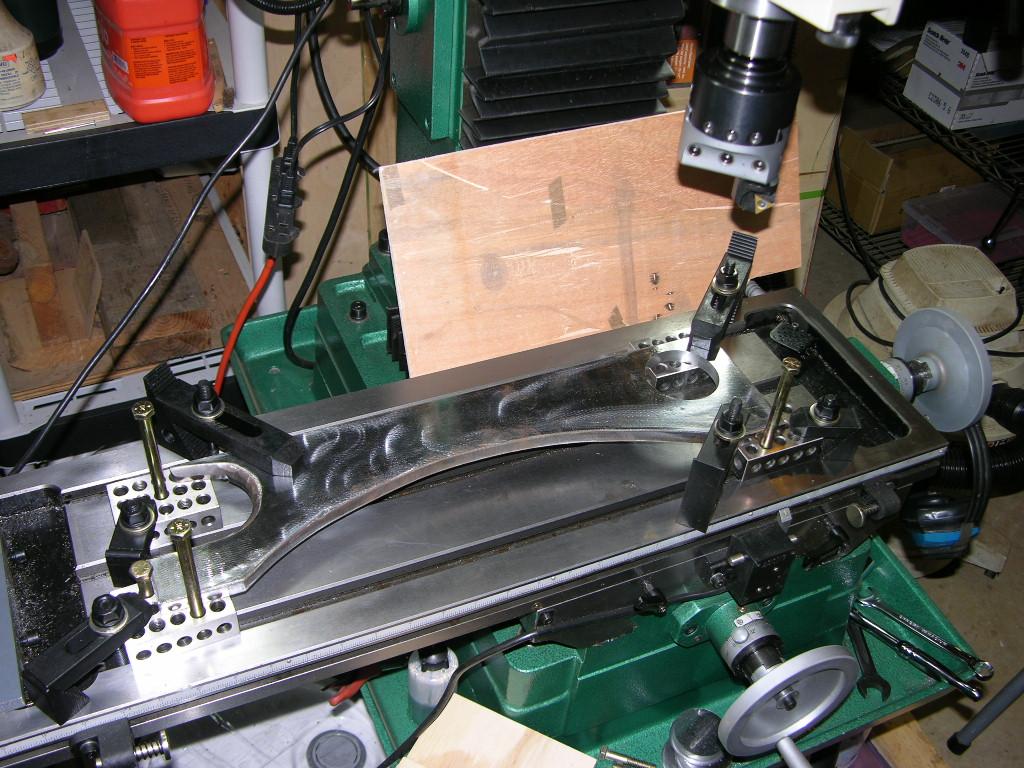

I started a QA for the loader on my 580B, but it's stalled out lately due to higher priorities - I went with a beefier version of some I saw on Kubotas, most of the parts are 1/2" and 3/4" steel - upper pins will fit into deep "U" brackets, then the 2 lower pins will lock it into the uppers - I built a jig (all 3/4x3 FB) to press 1/2x3 FB into the U brackets, then future implements will just be Case compatible 2-pin mount. If I'm just moving attachments around, no need to use lower pins at all, just "hook-n-go" -
The long radius in the plates is just to clear the curved back of the original 1 yd bucket; other implements (grapple, forks, brush forks, 3ph quick hitch, etc) may not need that. The "U" brackets are only needed on the main loader mounts, any attachments would just be 1-1/2" pins spaced same as original.
Here's a few pics, any questions feel free to ask... Steve

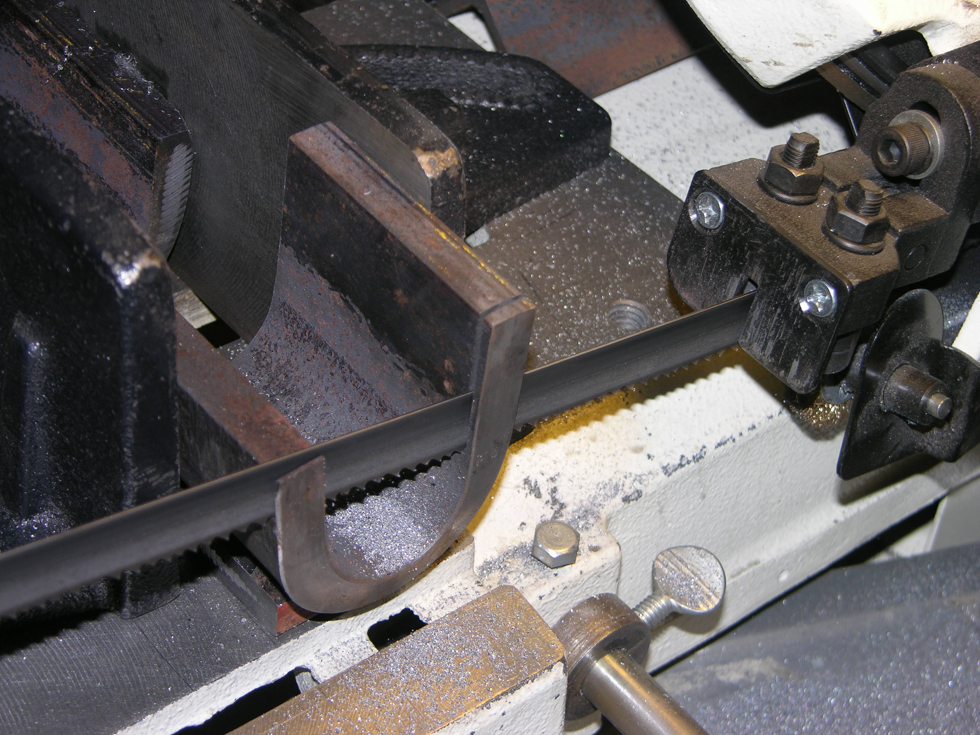

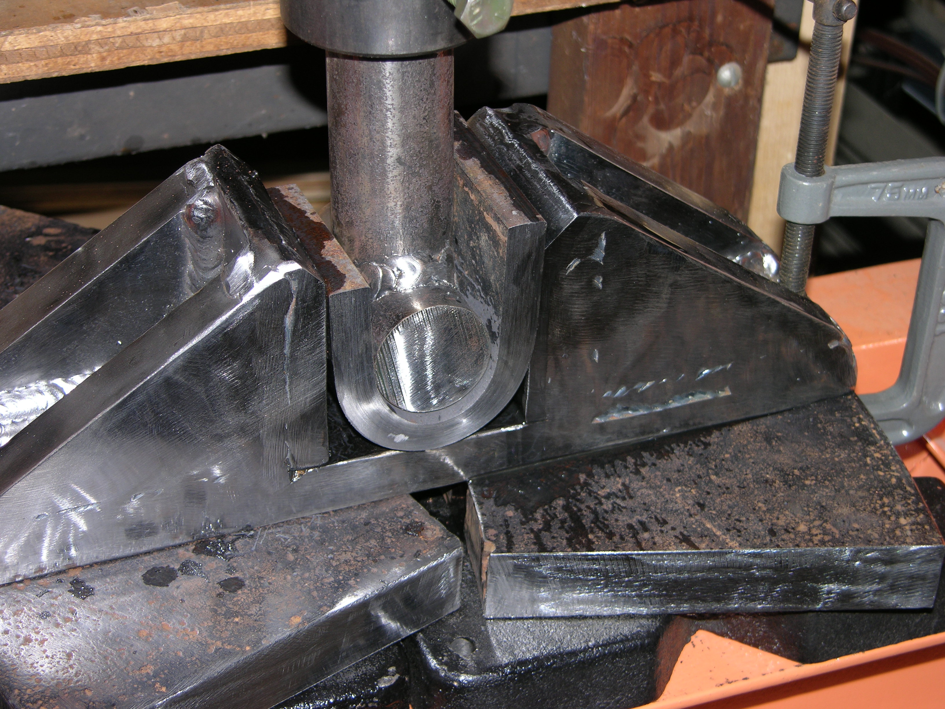

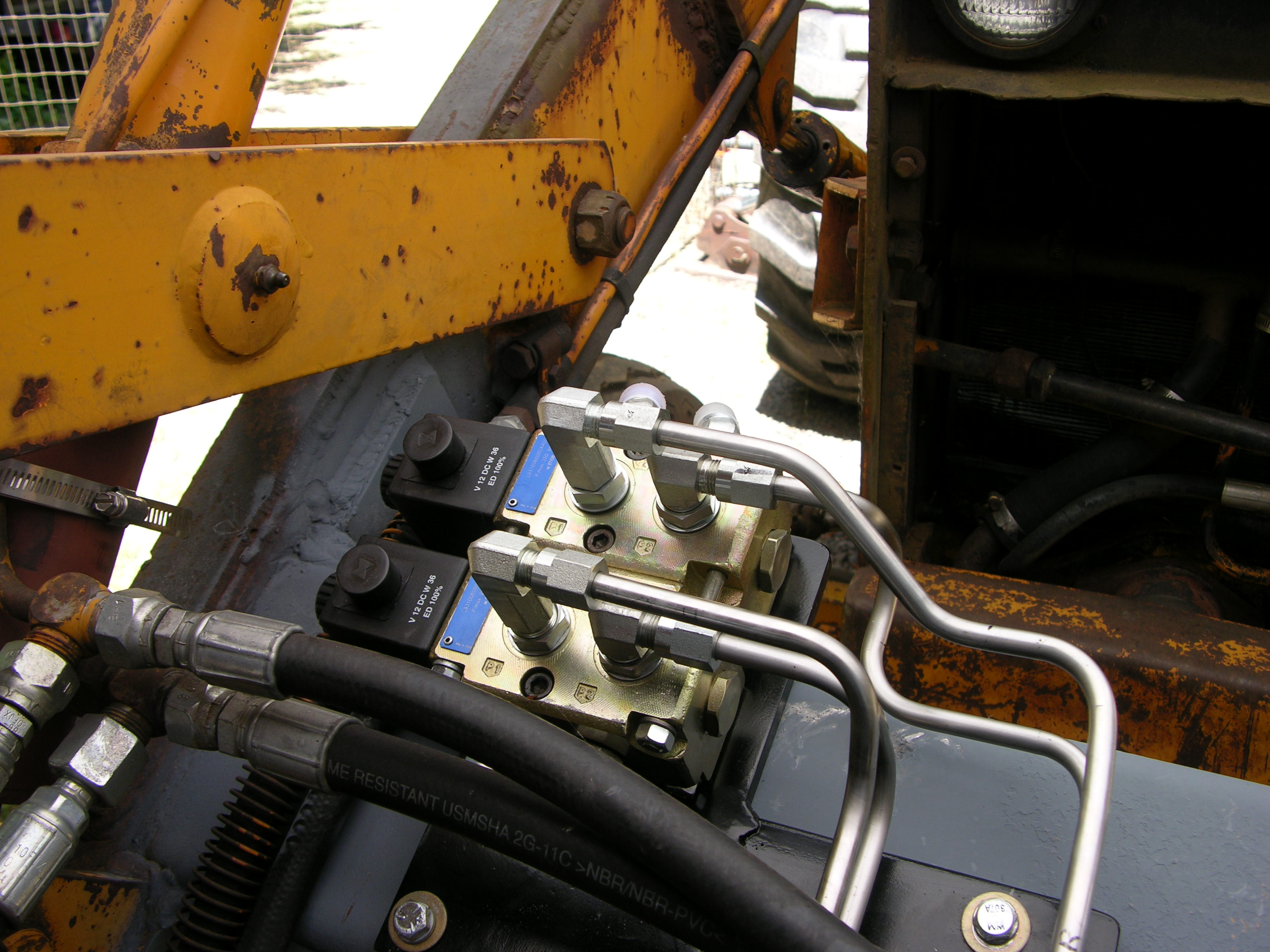

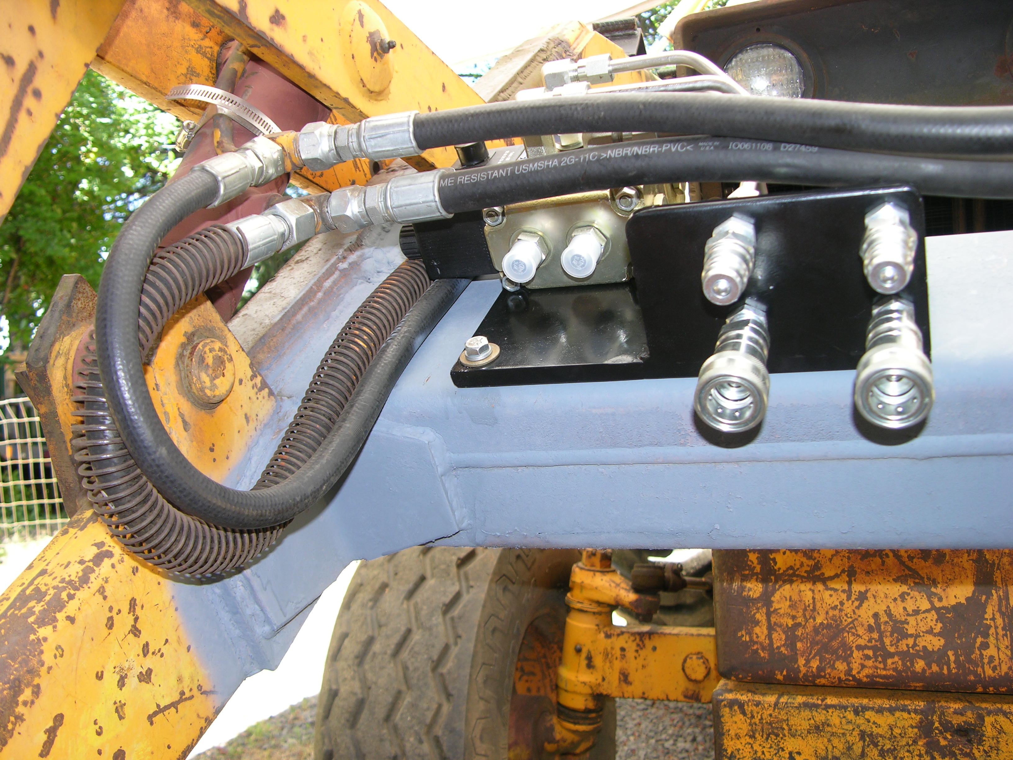

A few more...
DSCN1331.JPG DSCN1459.JPG DSCN1460.JPG DSCN1463.JPG DSCN1468.JPG DSCN1300.JPG
IIRC, JD hoes use a single curl cylinder - but hopefully some of this might work for you... Steve

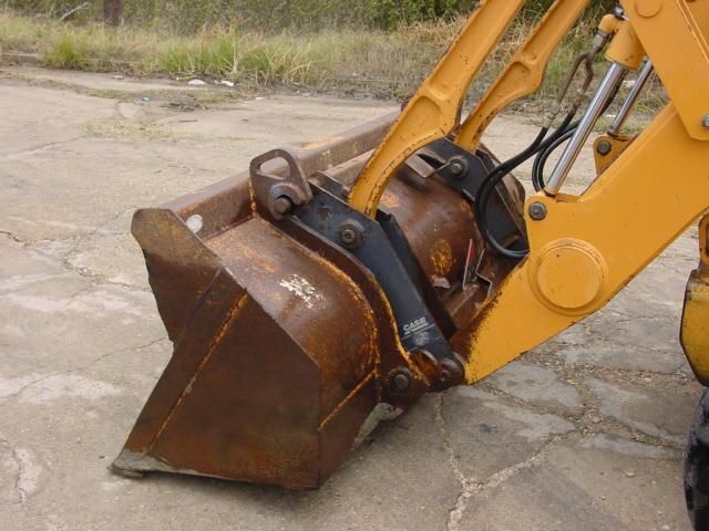

Oh, here's Case's version - I didn't like the idea of having to build those hooks for every single attachment, so I went with the heavier version of the Kubota
BTW, those pieces are still sitting around waiting for me, hopefully sometime in the next year :rolleyes:

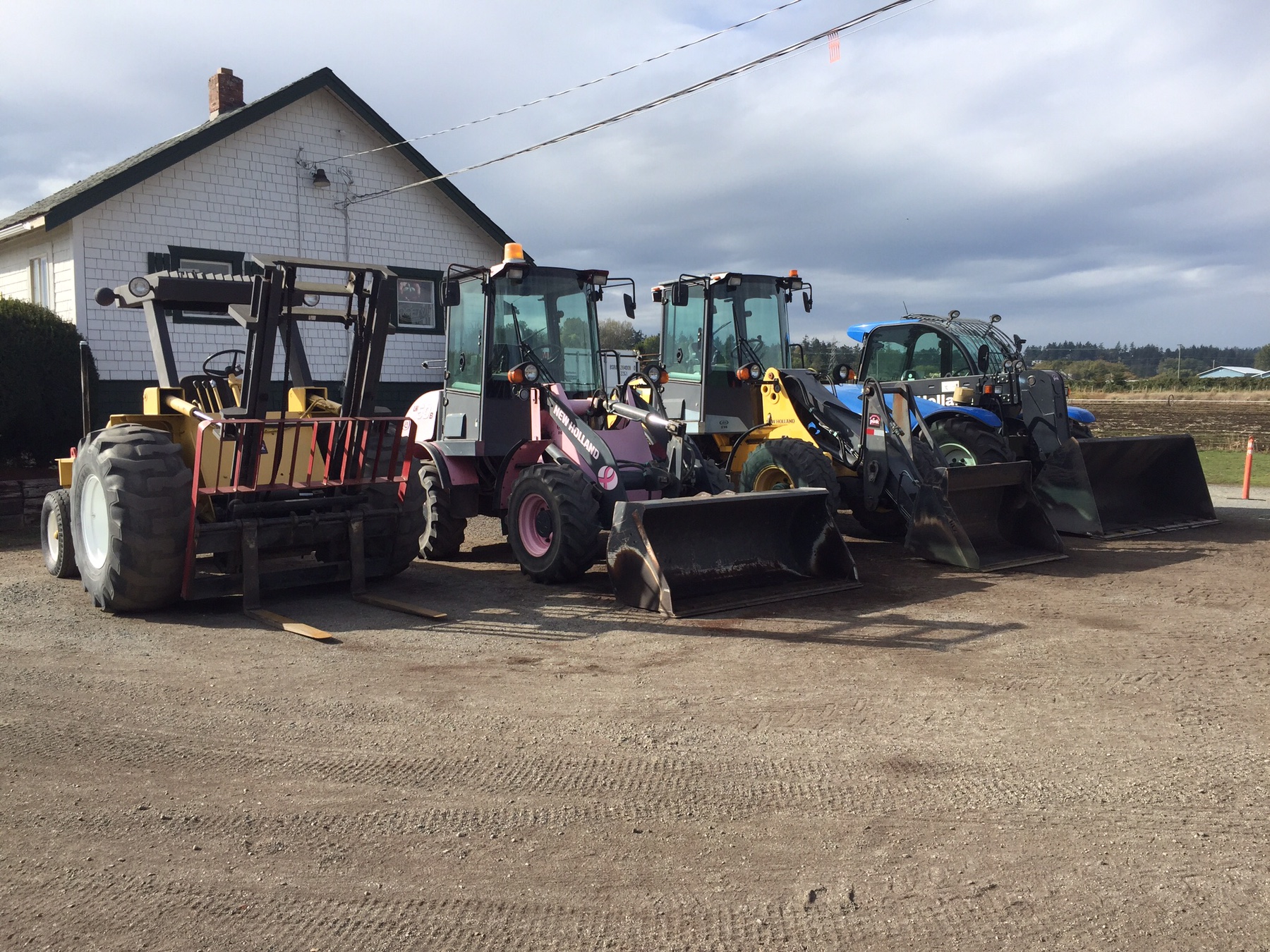

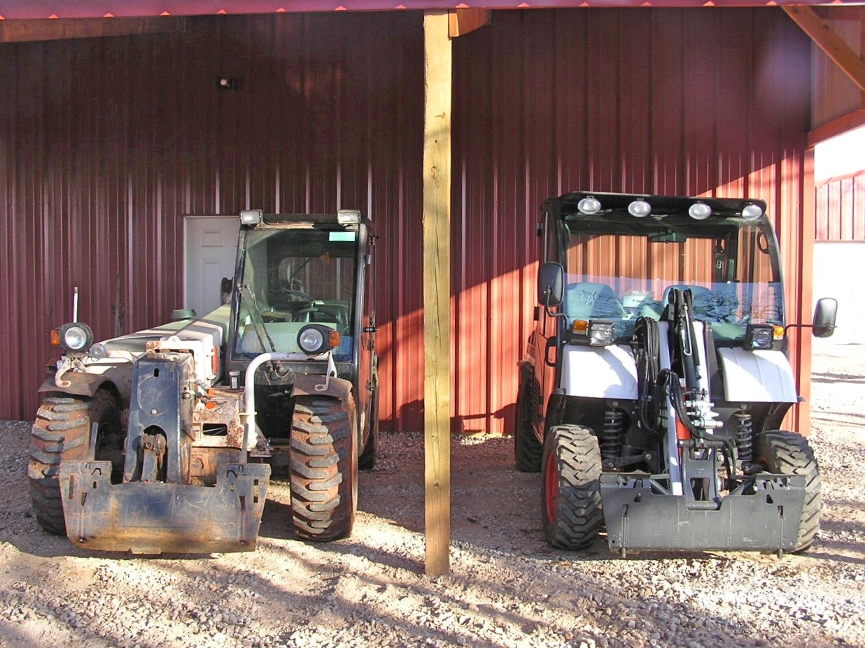

These three loaders all have QA and each has at least two buckets and fork attachments.
