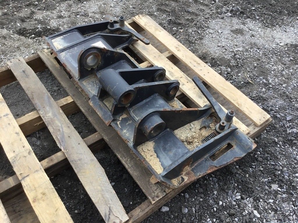

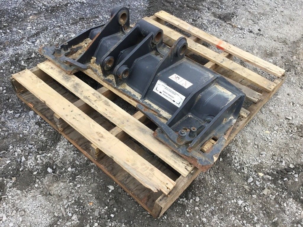

Those are seriously beefier than any adapters I've seen. I wouldn't hesitate using something built like that on my full size backhoe.
It looks plenty beefy enough but it looks like the bottom 2 pins are too narrow and it only has a mount for 1 point in the center. My backhoe has 2.

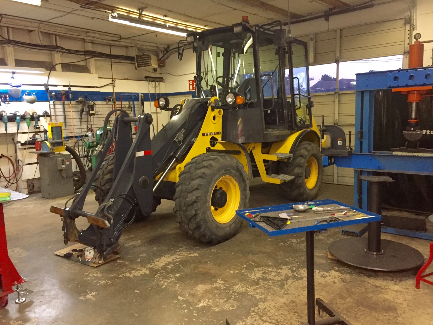

Don’t know if this will help or not but here’s a pic of SSQA on a 80 HP compact wheel loader.
