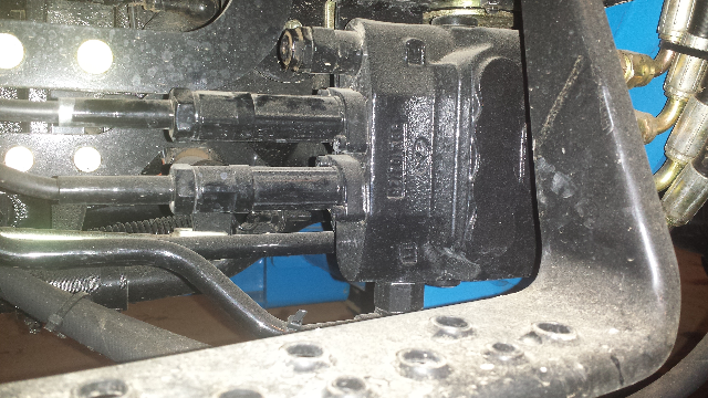

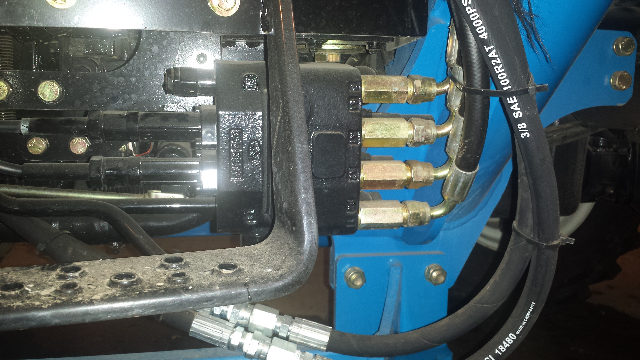

The relief valve on the loader valve also controls the remote valves. Other manufactures will have diff pressure settings. some more than 2600 and some less. Just when a tractor comes into my shop with a pressure issue I take it to 2600 psi at PTO speed. Ive had a couple R4041's come in where the PSI was only at about 2000 psi. Which is way below factory specs.
Ok cool. I'll source a pressure gauge so I can check. Looking back, my previous R4041 may have been too low.
So in this pic, where's the set screw?
I do not have a LS but that protrusion on the top of the loader valve looks just like the one on my Kioti, other than my whole valve assy. is turned 90 degrees.
