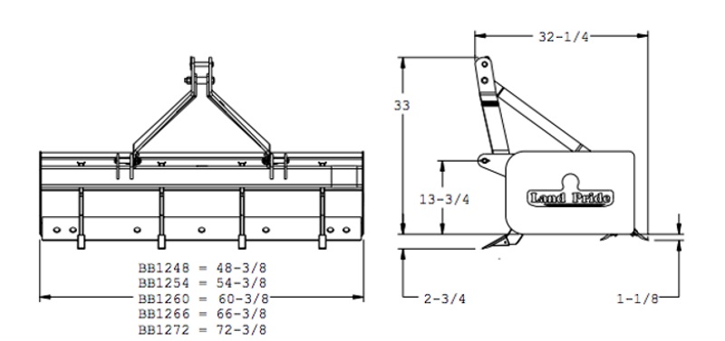

What are the typical side wall dimensions, and what's the best angle for the bottom edge relative to the back?
I've been wanting to build one for a while, but without a design template, I've been reluctant to start sourcing materials.
The side wall is 3/8 on my Cammond.
Here is the only drawing that I found with a Google image search. It is a low back style.
   / Has anybody built a box blade? #47
I'm more interested in the front to back and top to bottom lengths, and what the included angle of the bottom right corner in the right picture is.
The land pride dimensions are helpful though!
