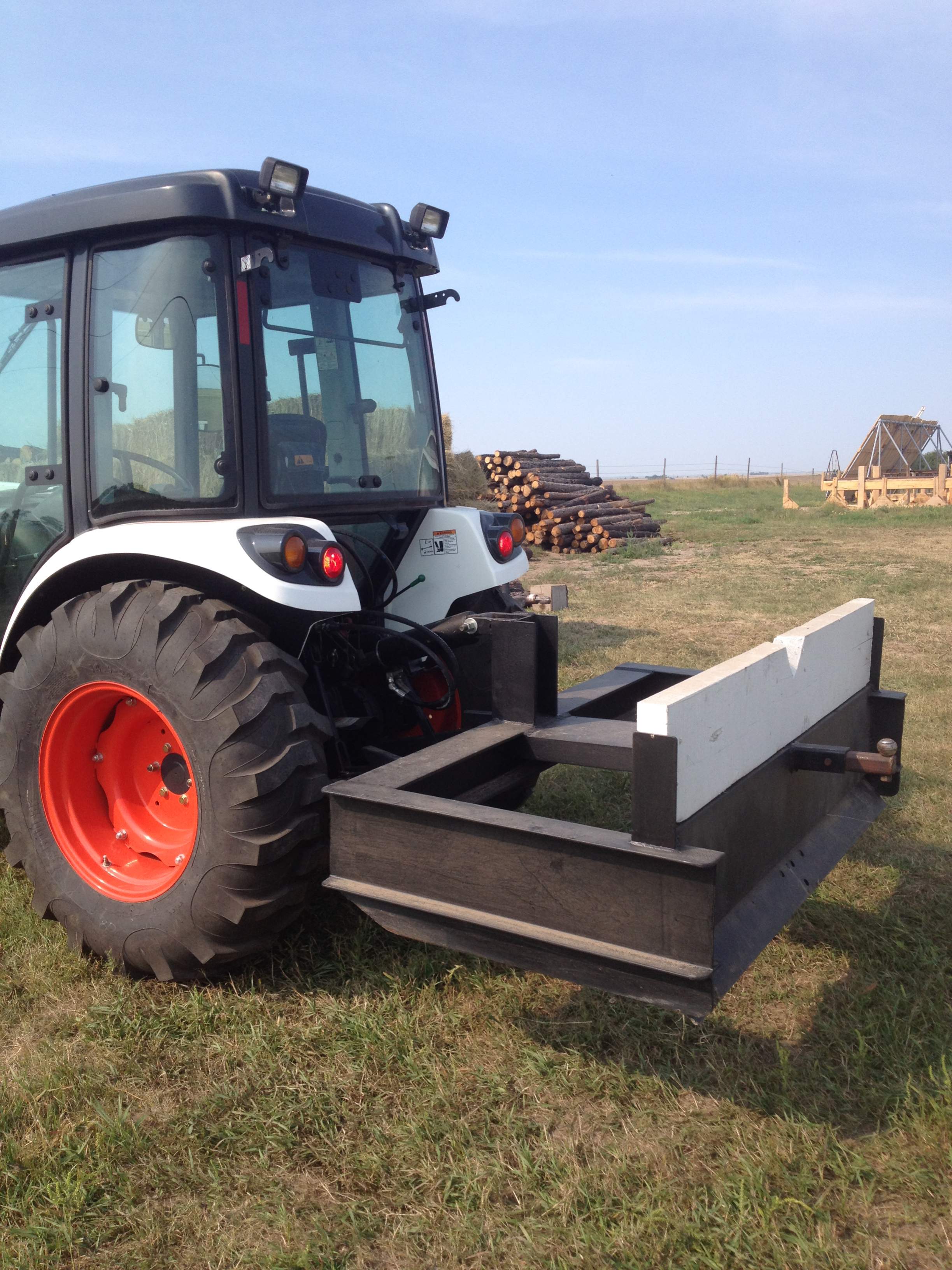

I built one with a large piece of angel and it worked fine, something like 6x6x1/2" was used for the blade. For occasional homeowner use it's' not absolutely necessary to have a hardened edge for most situations. If it did happen to wear you could just weld on a hardened blade later. If you don't' have access to some good materials try a scrap yard. Sometimes you can find great pieces for projects like this where you don't' want to buy a whole piece. I found all these parts in the boneyard at a past job. I bought a few weld on ears on ebay and a hydraulic cylinder and hoses from surplus center. The hydraulic top link makes all the difference in the world IMO. IMG_0024.jpg
