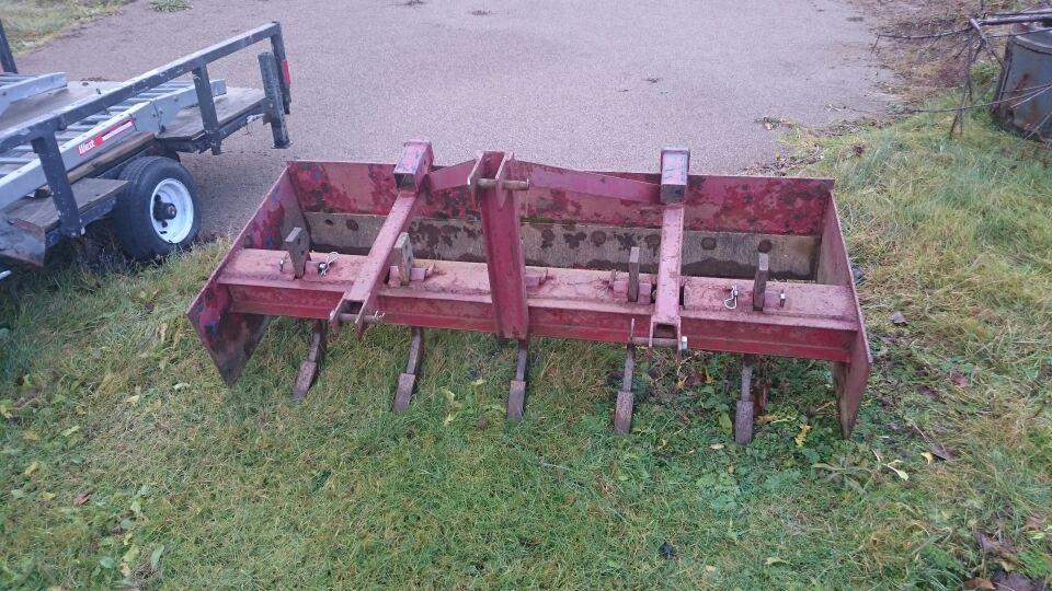

I have a cheap chinese scarifier similar to this, and wouldn't mind converting it to a box blade, so any pics and measurements anyone cares to post may come in handy when I eventually go this way, if I do! I have a used grader blade cutting edge I thought I may be able to use in it.
That looks like it would work. Use the grader blade on the back and get some 3/16" for the sides and depending on how well you weld have a welder do it or weld it yourself. Give it a try, what the heck. Seems like you are 3/4 of the way there in materials.

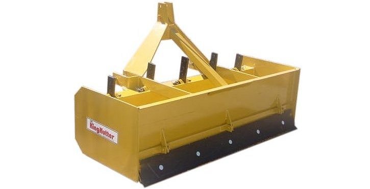

Of all the pictures I've got of Box Blades I only found one showing the hinged rear blade. Google search "Gannon" or "Land Pride" BB's. They'll have some good pics. I've got a LP and have 20 or more pics of it but none of the hinged blade. The back side of the blade rests against the heavy angle iron that the front blade bolts to. At each end is a small bracket welded to the hinged blade with a matching bracket welded to the BB frame. Insert a short bolt/nut in each one and the hinged blade becomes a fixed blade.
Here's the only pic I can find in my files.
   / Has anybody built a box blade?
#28
What happens to the hinged part when you back up?

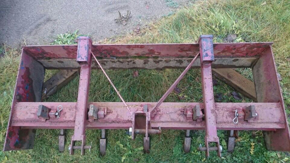

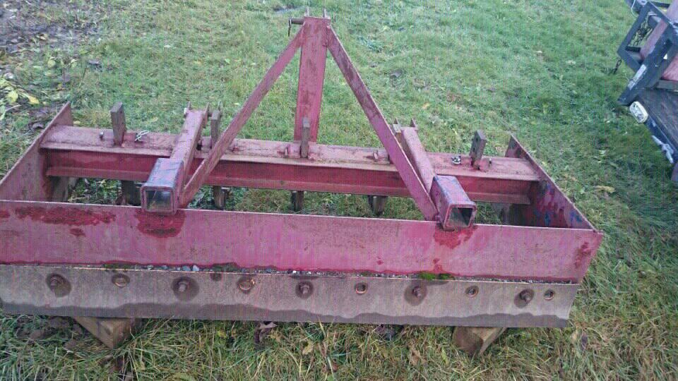

I made mine a few years ago, mostly from stuff around the farm. To hold the scarifiers, I used two pieces of channel back to back with the space between them a little larger than the scarifier. I made mine too tight and had to shave a bit of each edge of the scarifier to get them in. The top and bottom of the scarifier holder is flat stock cut to length to space the scarifiers equally. I made fancy self locking pins up to hold the scarifier at desired height, that was a waste of time, lost a couple of them. Now just have round stock with a hole drilled in each end and use R-Pins, lot simpler and works better. To hold the pins, I found a piece of angle iron that they fit nicey into and cut into one inch pieces.
I put the 2" square stock running back from the three point hitch too close to where the scarifier is, not enough room for R-Pin between it and scarifier. I mounted receivers on these members for gauge wheels but have use them more for receiver hitches to haul trailer around than gauge wheels.
Go to your highway department or anyone else who has graders and ask for a couple of used cutting edges. These are usually scrap, usless they have changed over to the carbide tipped ones. They go through the old style ones by the truck load. There is plenty meat left on them for home use. You will have to cut them to lenght. I mounted two cutting edges on mine, back to back. One for dragging, and one for pushing. When cutting to length, bolt them together so the holes will line up when your finished and then just bolt them through the back. If they are in a good mood, ask for half a dozen of the proper bolts, they're called plough bolts. They go through them by the bucket full.
I made up a set of plans before construction, I'll see if I can find them.
