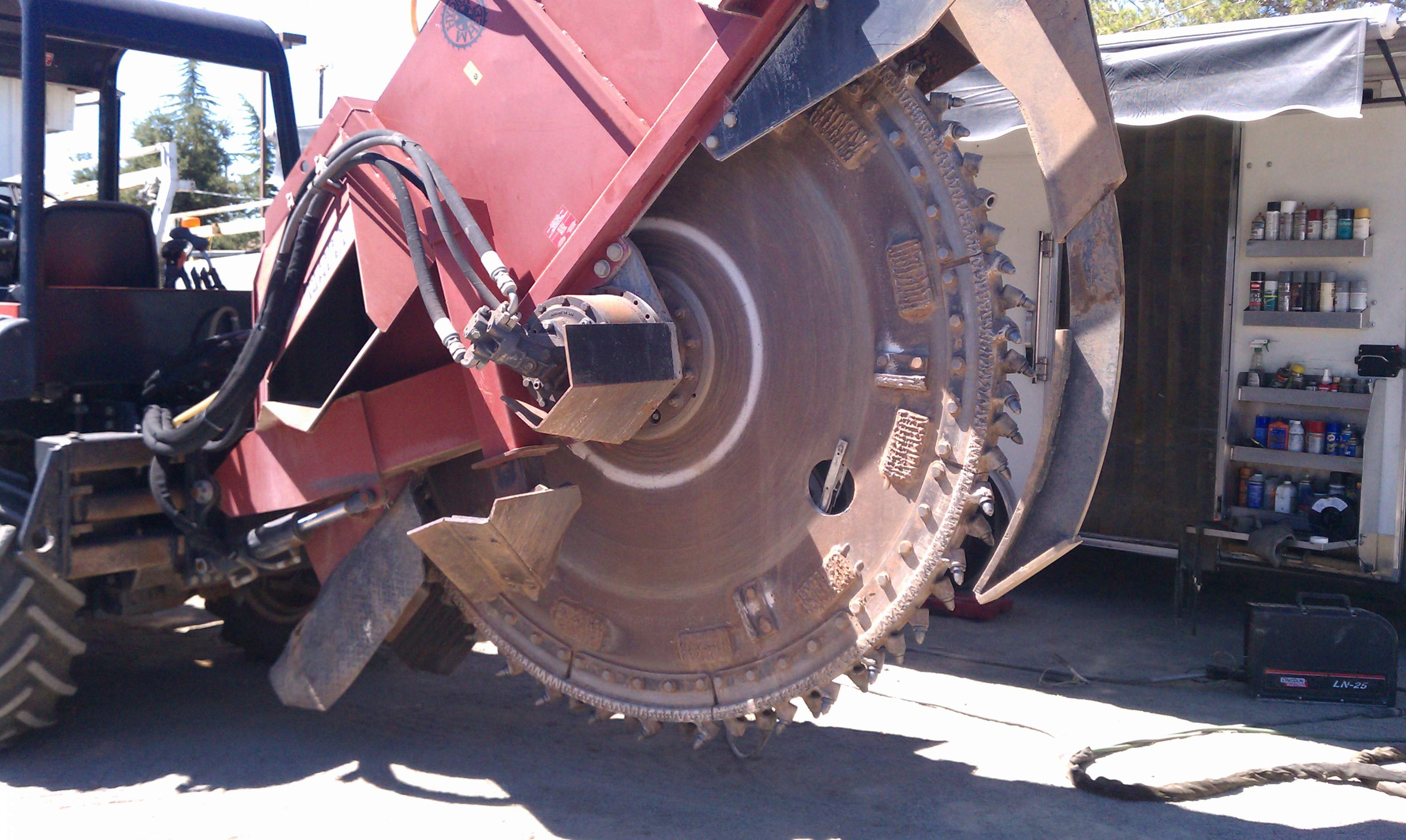

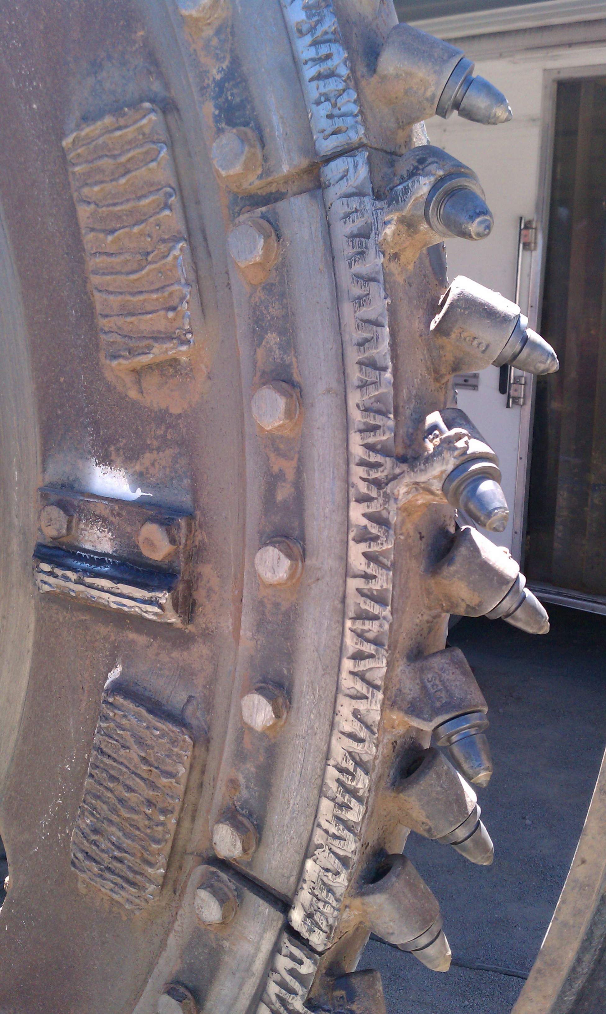

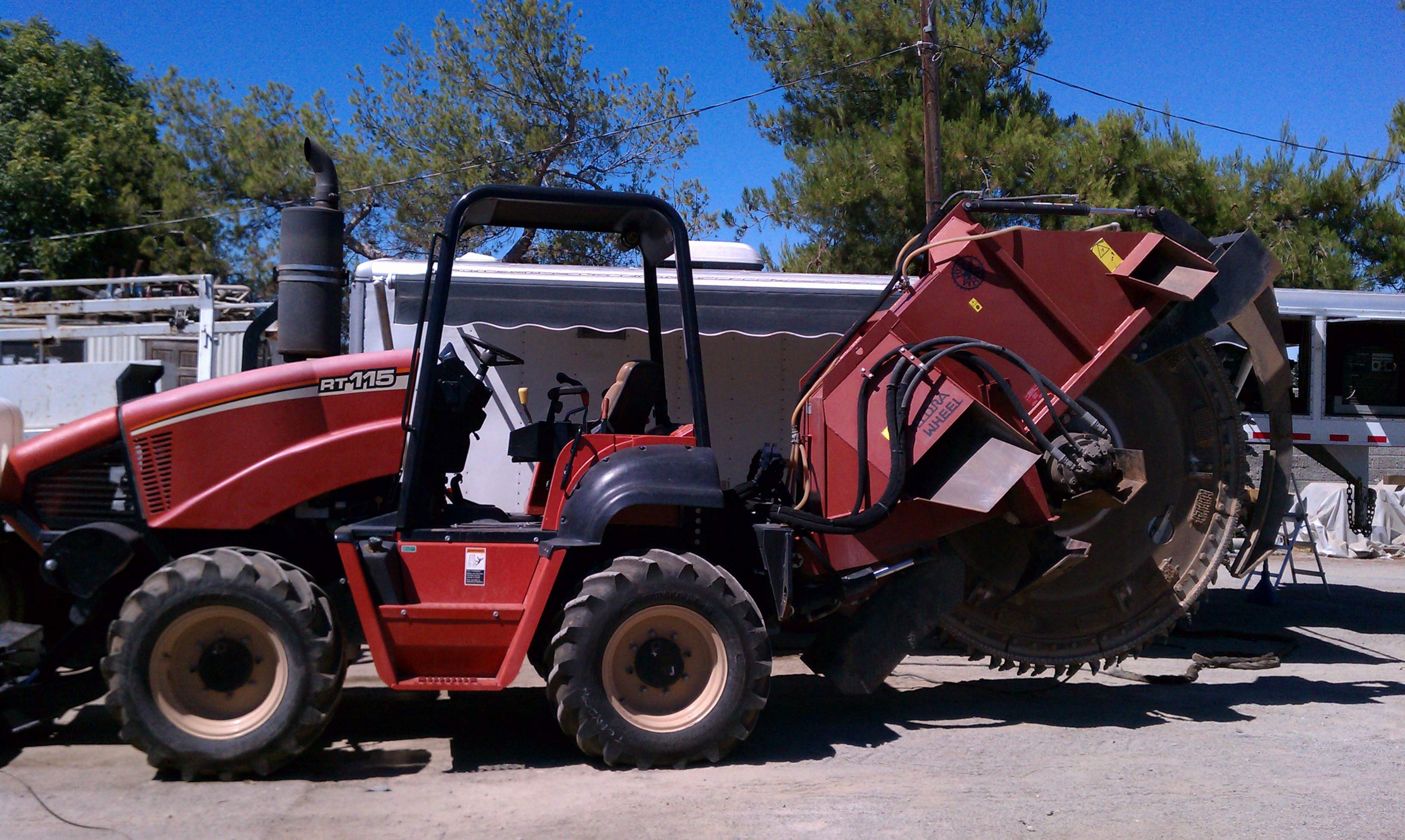

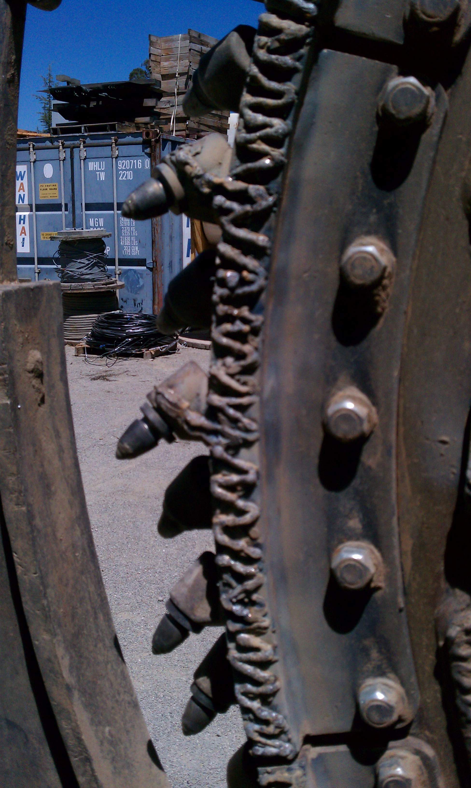

#27
Here are the pics I promised.
The machine is a Ditch Witch RT115
The third pic is of the wheel before I re-hardfaced it. Obviously the last pic is after.
It takes me about 10 minutes per side, per section, and there are 12 sections. So 4 hours of welding plus cleaning it up so I'm not trying to weld sand.

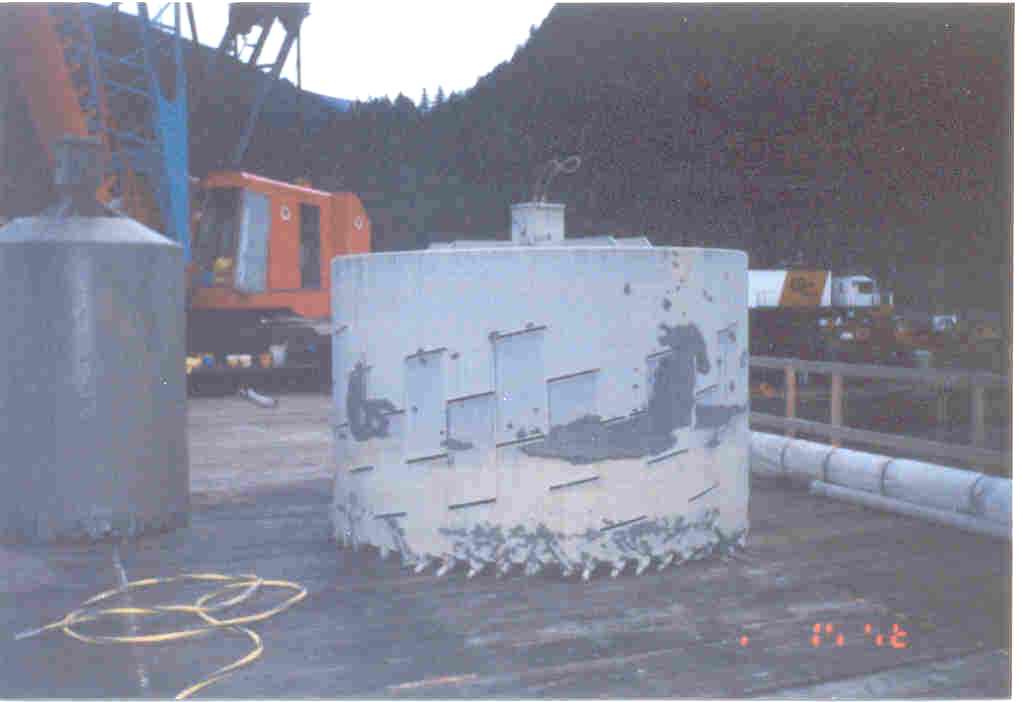

Nice job! Thanks for posting the pictures!:thumbsup:
Those carbide teeth sure bring back memories, I've been on several drilling jobs where there were 55-gallon drums full of those things. I've seen more knock down drag out fights over which way to angle them.:laughing:
