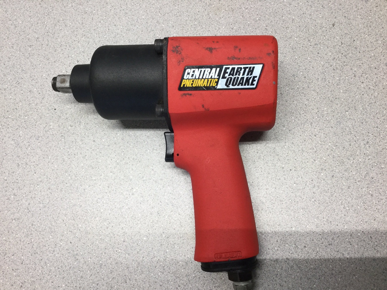

harbor freight 1/2 drive earthquake impact wrench 700 ? ft lbs tq
Be careful, you will break the wheel studs with this impact !
On the flip side of that, I can just snap off rusty bolts on old farm equipment and save a lot of time disassembling. Just spray oil on the outside of the bolt head or nut so it's easier to get out of the socket. Impact wrench is really powerful.

turn into the tool trucks every week.
/ Harbor Freight Tools that don't suck #10,830
Something is going to give for sure.
One wheel on the F150 was pulled off at the body shop and I think they put it back on with an EarthQuake. When trying to remove it the socket spilt and chewed up the lug nut. The socket was on the light side but worked fine removing the other three wheels. I finally got it off using a nut extractor, 1 1/4" socket and breaker bar out out our 3/4" drive set with a 4 ' pipe, jack stand to support the pull handle along with a 6' step ladder so I could jump on the extended pipe.
This sucker needs to be used with torque sticks for sure to not overtighten.
/ Harbor Freight Tools that don't suck #10,831
Or turn it down, mine has 3 settings:
1. "Hand tight"
2. "3/8 ratchet tight"
3. "Did you want the threads pulled out of the nut" tight
I generally use the middle setting to snug down lug nuts, then tighten them with a torque wrench.
1. "Hand tight"
Aaron Z
Torque wrench is what I use. If you have an Earthquake and use on lug nuts you eventually will overtighten and strip or bend a backing plate or something.

Where is the 3 torque switch?
/ Harbor Freight Tools that don't suck #10,836
As I said, I use it to snug the bolts down. I stop once they get snug and I always end up tightening them more when I switch to the torque wrench.
On the back of the Earthquake that I have, you have 1 reverse setting and 3 forward settings.
Aaron Z
I have this one;
Like Aaron notes, reverse and three torque settings. I've never needed the highest setting.
1/2 in. Aluminum Air Impact Wrench
