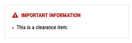

From the ad above:
Maybe it will be replaced by one with a better hook design.

I have an unsubstantiated theory - it's not actually on clearance. The cashier said mine was on clearance when I bought it a year ago. No purple tag. The website says clearance - no discounted price. My bet is that their database system simply sees the word "clearance" in the name and marks it as such, never mind that it's referring to the distance between the hooks.
