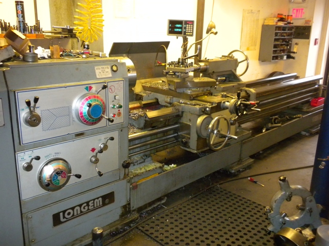

Joel,
If it was my decision I'd buy a clean used lathe and separate mill to learn on and you'll find more uses for fiddling around on....problem is you'll need more space for two machines.....
Looks like the machine in your link is missing a gear box for feeds/threads......Threading will be usefull for your learning curve (english and metric)
When it comes to machine work, think about size of what you'll be doing.....you'll always want to stick something in there bigger than the envelope size......you can always use a bigger machine to do small work but not the other way......
Also consider the small size of a machine takes away rigidity for smooth/powerfull cuts and will vibrate when machining/drilling/boring......it's a trade off with having a small machine......
Heck, I've made parts as small as 1/8" on this machine .....and it weighs in at 13000#
