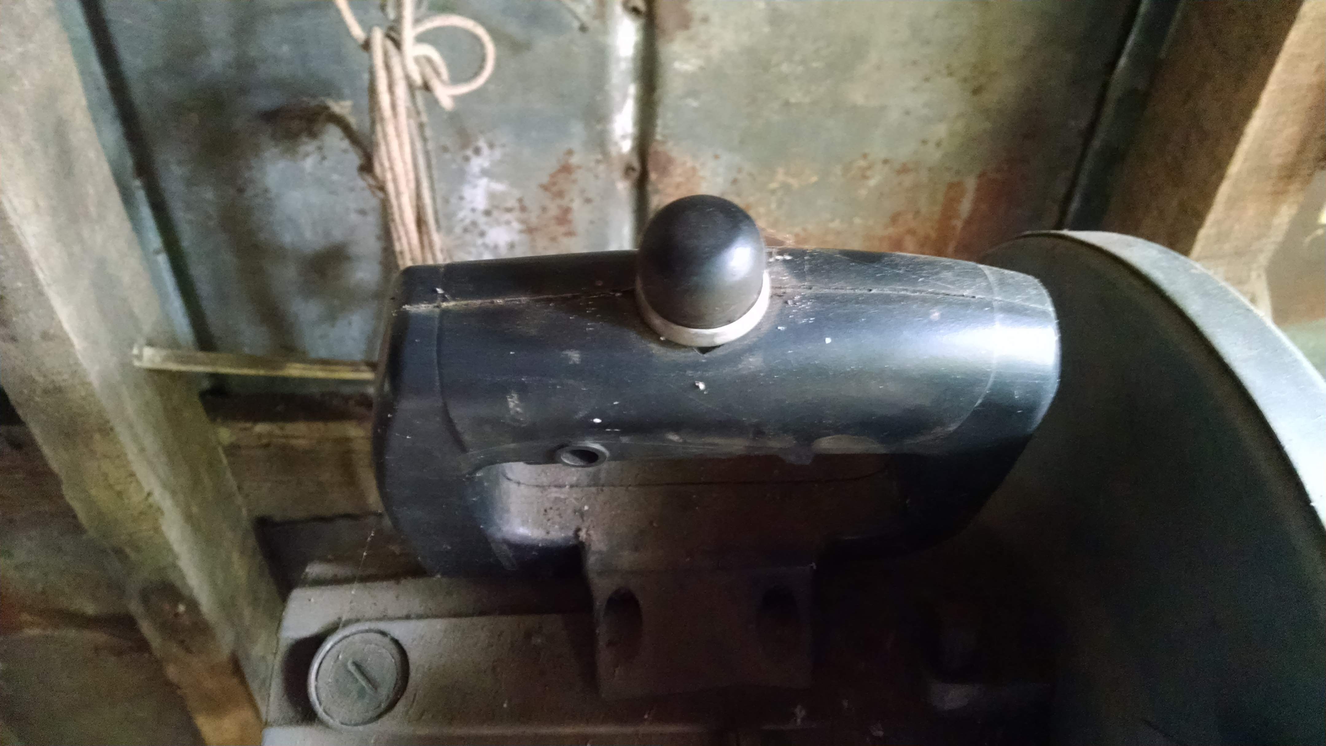

I had this 14" HF chopsaw for 12 years. I put new brushes in it 3 years ago, and yesterday I was sort of horsing it through a piece of 5/16 x 5.5 flatstock and I melted the switch.
HF doesn't sell those switches anymore, and I found I can run the saw by bypassing the switch.
I have a heavier duty chop saw but wanted to keep this one around for an emergency if the better saw takes a crap. What would you suggest for a switching operation. I wouldn't really want to just plug it into in the wall to operate it.
Safety suggests I just junk it, but...

You need two hands to run this saw. Usually one to hold the material, and the other to operate/turn on the saw. So the only options I see for a switch that is not in the handle, are a foot operated switch, or a knee operated switch mounted to the bench.

I had same thing happen to my HF chop saw. Not having any luck finding a switch to fit or modify slightly, I put in a push button starter switch purchased at auto parts store. Drilled hole in front of the handle to mount the switch and now I grip handle with fingers and squeeze with palm of my hand. Works pretty good and has been this way 4 years now.

+2 on the foot switch. rig it up on a plug and outlet so you can move it to other tools if needed like a drill press.

Yikes. How would you shut down quick in an emergency without letting go of the workpiece or the saw handle, or both?
