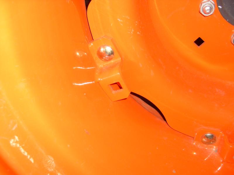

A little different design from the LS but the same principle. Kubota has one bolt whereas my LS has two bolts holding the rim, plus the LS is solid all the way around the rim with the S turn in and out continuously rather than just a single little lug. Install the center hub on inside or outside of the connection on the tire rim to change track by 2" per side. Flip the rim to move 4+ " per side. Your's looks to be at max width now.

It is obvious from your photo that if the center disc were as they are in this photo, they were already flipped to cup outward. Most tractors are installed with the cup in and the tire installed as you now have yours depicted. THis is why most folks have to flip the center disc rather than remove the outside hub.
Trying to get that bolt back in the rim from the inside and put an nut on by yourself must have been a real bear, I know it was on my LS front tires when I had to swap the rim lugs from outside to inside and it was only loaded with air.

The Kubota manual has three positions for adjusting the width. The center discs can't be reversed without the tire rubbing on the inner fender. The inner most position has the tire with the valve stem facing in. The next position is having the valve stem facing out but the disc on the outside of the brackets on the wheel. This is slightly, maybe an inch wider, than the inner most position. I have my wheels set in the widest position (as seen in my picture), the valve stem facing out and the disc on the inside of the brackets. To go from the innermost to outer most position requires the wheels to be swapped side to side. To go from middle position to the outermost would require the center disc to be removed from the tractor and the wheel so it can be mounted to the inside. Simply looking at where the valve stem is, facing out or in, should tell you if the wheels are in the innermost or middle position. Mine were set to the innermost when I got it.
