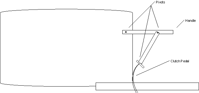

HELLO TO ALL,
i just had a knee replacement, and i cannot run
my tractor, because it is a standard transmission.
has anybody come up with a hand operated clutch?
my machine is a KUBOTA L3000DT. i know in time,
i will be able to do this, but right now my knee is not
flexable enough. any ideas, or if someone has done this,
and has plans, or rough drawings, i would appreciate
looking at these.
good luck to all.
accordionman
wlbrown
/ hand operated clutch #2
First, I've never done this, so this is just brainstorming, but since this is a temporary thing, rather than trying to retrofit for a permanent disability, I'm thinking something fairly simple like this:

Shouldn't be to hard to fab up something to make it hand operated. Think of a drivers trainer car that has gas and brake pedals on both sides, one for the driver and one for the trainer. It would be pretty easy to rig up a cable operated handle. I have a couple of gas and brake pedal assemblies that came out of drivers trainers cars if you think you could use some of the parts. Really all you would need to do is replace the pedal with a hand lever and mount it within reach of your hand. The end that attaches to the existing pedal is fairly straight forward. Simply mounted behind the pedal assembly so the cable pulls it down.

when I had Knee surgery, I bolted a lever on the clutch of the lawn tractor, (since the pedal support was steel (not cast), I just drilled through it and bent the level to suit,
(this clutch was more a rocking action), Than a down ward action,
it was odd to use as one had to push it forward, to disengage the clutch, but worked well

Have you got a top N tilt cylinder on the 3pt??? Just rig it up on the clutch pedal and use that to operate the clutch!! ;)
