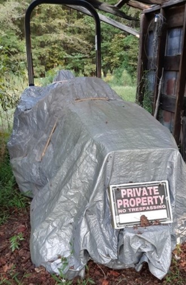

It's Basically a late model Yanmar which was my guess what it was. Which it is. The first pic. I saw of it was covered and the FS sign on it. The grill guard I guessed but all the bumper weight had me guessing what all that was? Winch Etc.. The square Hood and Grill and older ROP's was the reason I thought I was pretty sure that's what it was! The Yanmar 2210 21 Eng. Hp. and the JD. 2210 23 Eng. Hp..
