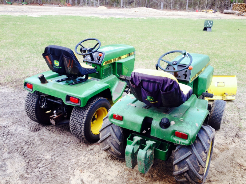

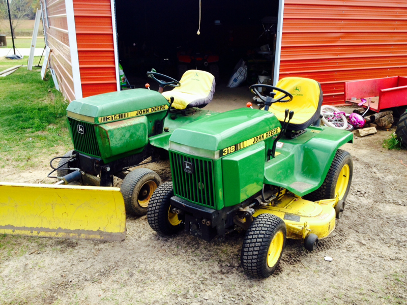

Go with the 314. It's strong as an ox. I've got 2 and 1's got the 54" blade. I've graded a lotta dirt with it.
