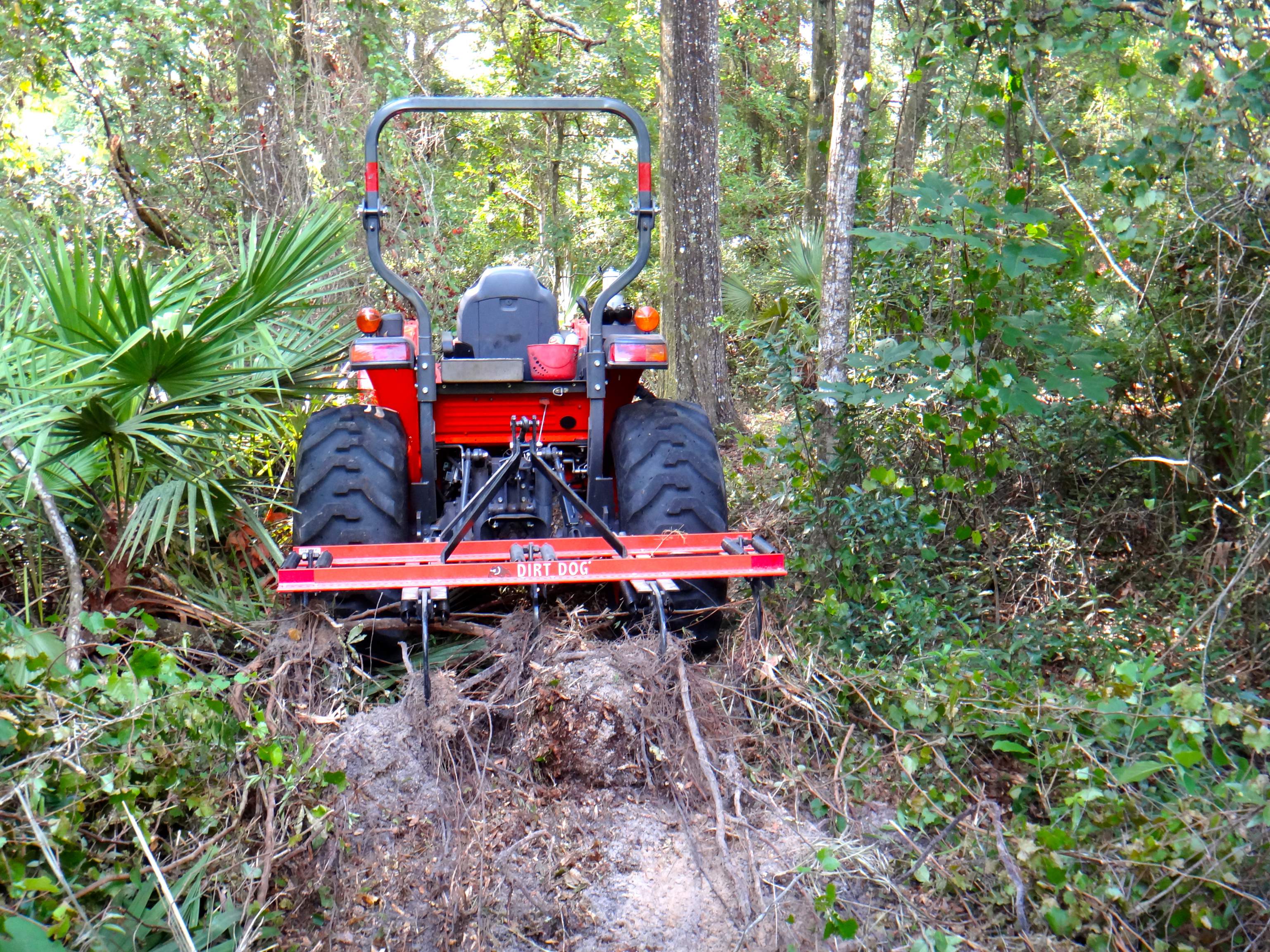

It would be educational for you to lie on the ground and look at what is under the tractors.
All kinds of important stuff is there. Hydraulic lines, filters, HST solenoid, etc.
Subcompact tractors have 7" to 9" ground clearance.
Compact Utility Tractors have 12" to 15" ground clearance, depending on wheel size.
As increasing ground clearance also increases tractor instability, tractor with 15" of ground clearance usually are heavier and wider than tractors with 12" ground clearance. R1/ag tires may increase ground clearance a tad, relative to R4/industrial tires.
If in doubt have you dealer armor the underside of your tractor with heavy gauge expanded steel.
My L3560 has improvised nine gauge expanded steel under armor. Installation was simple. Removal for service is simple.
Under armor is most often applied to tractors that work in heavy brush.
I buy heavy gauge expanded steel via eBay.
