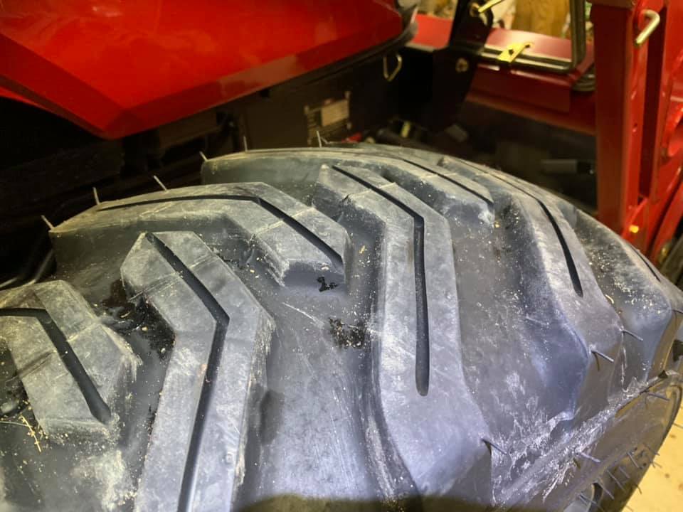

Nothing especially new here, but wanted to share. I grooved my rear tires and siped the fronts. My goal is a bit better forward traction, but mostly better steering when plowing snow. Once I drop the HLA 1800 snow pusher in float, there's a lot less weight on the fronts, so turning on slippery surfaces is not always that effective!
[FONT=&]
[/FONT]
[FONT=&]
[/FONT]
[FONT=&]
[/FONT]
I grooved my front and rear tires like you did your rear tires but has anyone noticed how much the front grooved tires in this picture that are grooved look very much like the R14 tires except for the center groove?
If that center groove would have been at an angle like the rest it would have been very much like a R14 tire.

We finally got a bit of snow, so I wanted to update everyone with how the grooving worked. Regarding conditions, there is a bit of ice under the snow that fell. It started as rain, then switched to snow, so definitely slippery conditions. The ground was also not frozen, so the snow had to "work" to freeze the ground. As far as how slipery it is, I would categorize the asphalt and concrete as uncomfortable to walk on after plowing. (Virtually all the plowing I do is on either asphalt or concrete.)
My main goal was to improve steering when the snow pusher was on the ground in float, so very little weight left on the front tires. I have to say, my simulated R14 pattern nailed it. I can now turn much better, even considering the slick conditions under the snow. I did not need to engage 4wd to get the benefit either. I call it a win. As far as improved traction in the rear, I don't see that much improvement there (see pattern photos in first post). I had to engage 4wd to back up even on the slightest slope. My tires are not filled though, and I've only got a light duty 6' rear blade, so very little weight on the rear. Maybe next summer I'll add some cross groves on the rear tires.
Anyway, I'd say well worth it overall.
