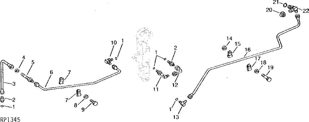

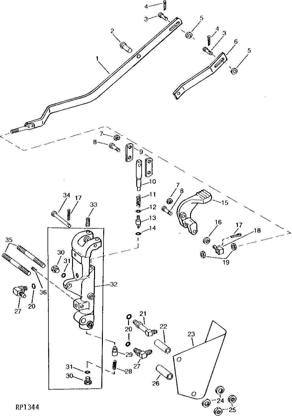

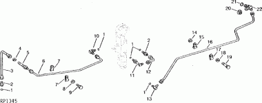

If you suspect diff lock is engaged loosen fitting on line(parts key 6) if no oil comes out under pressure with engine running then diff lock isn't the problem. My guess to grinding is diff pinion shafts(2nd photo) are spinning in housing or pinion gears have failed.

RP1344_________UN01JAN94.gifSince you mention the differential lock valve is hard to push, I suspect maybe something inside the valve is not assembled properly or the linkage going to brake pedals may be binding.

Something seems to be wrong with the diff valve, as it is very hard to push and release and the small line leading to it is shaking and gets hot really quickly. The problem is not there immediately after start up, but happens after a few minutes - almost seems like the pressure needs to build up? I took the diff valve apart again and everything seems put together appropriately. I removed 2 extra shims I added, but I do not think that is the problem. The only thing that I did not put together as before were the spring and stop (parts 4, 5) leading to the brake accumulator as they were broken and needed to be ordered - I am not sure if these could be the cause? I will put these back together tomorrow and retry. Any further ideas in the interim? Thank you.
/ grinding noise while turning
I added parts 4,5 in the diagram above and problem appears solved. No more shaking and heating of the differential line and nor more clunking during turns.
