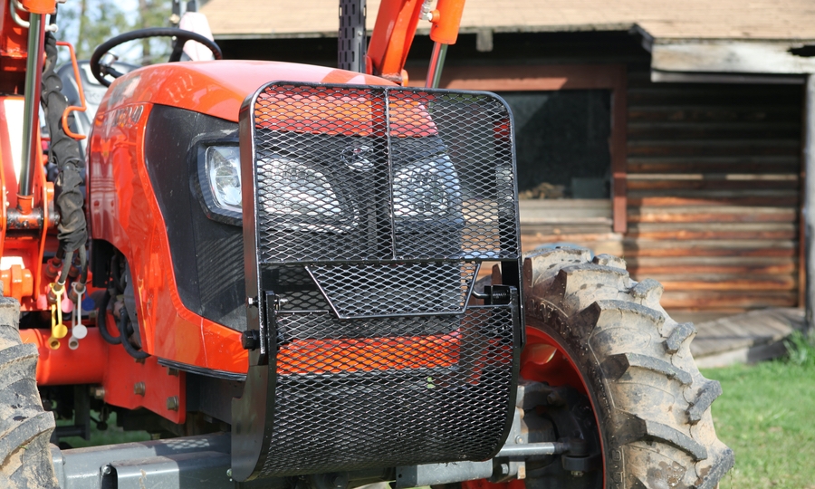

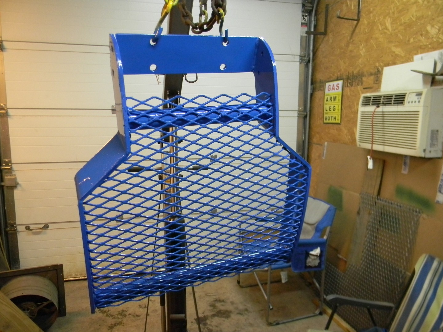

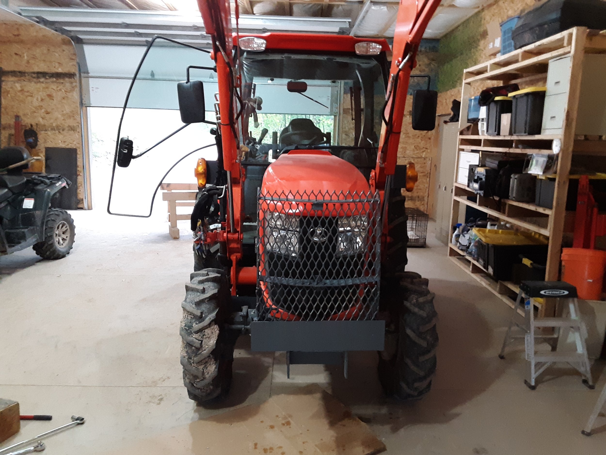

This is on my Kubota M6040. The top folds forward - at the middle - so the hood will open.

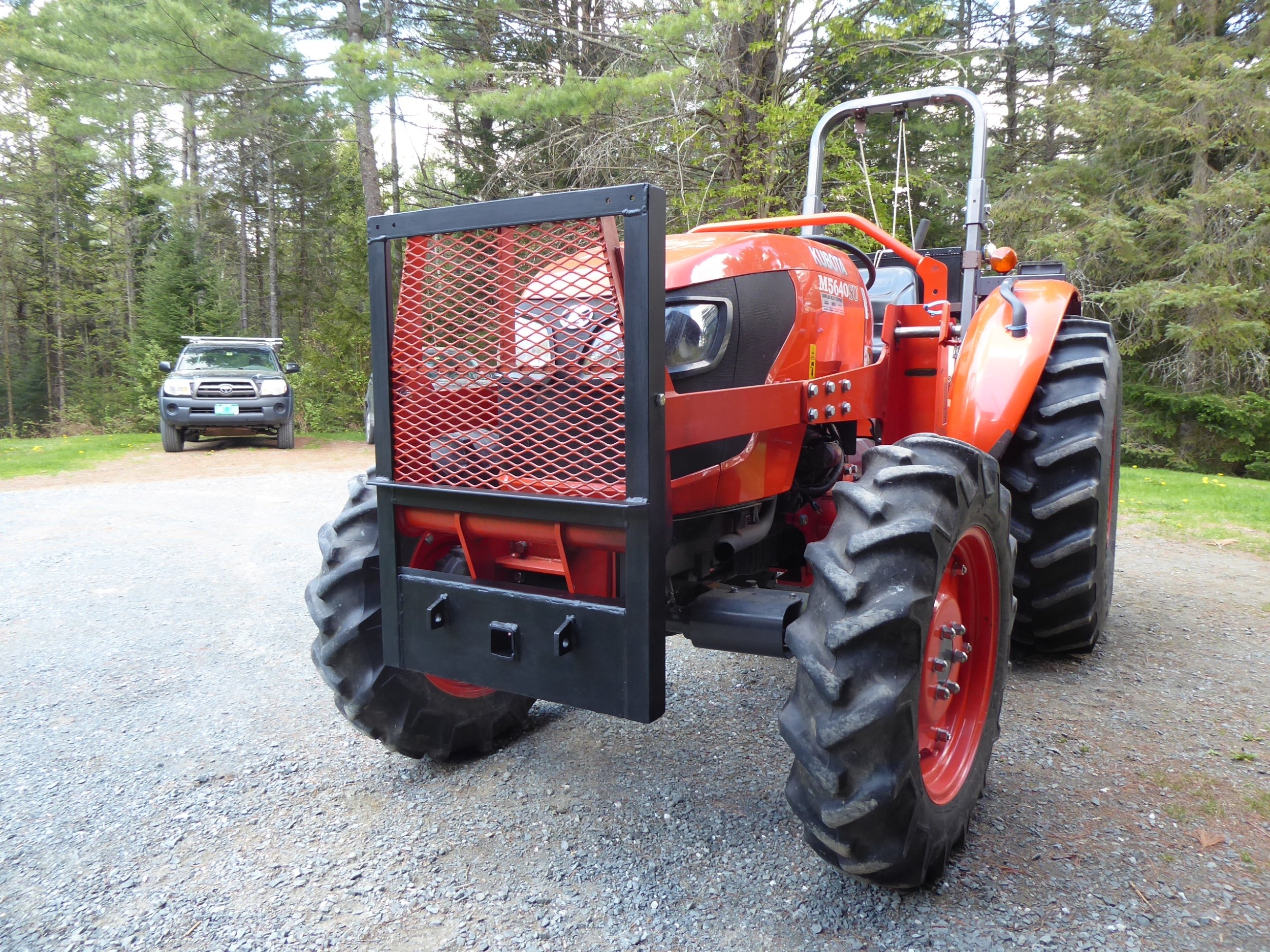

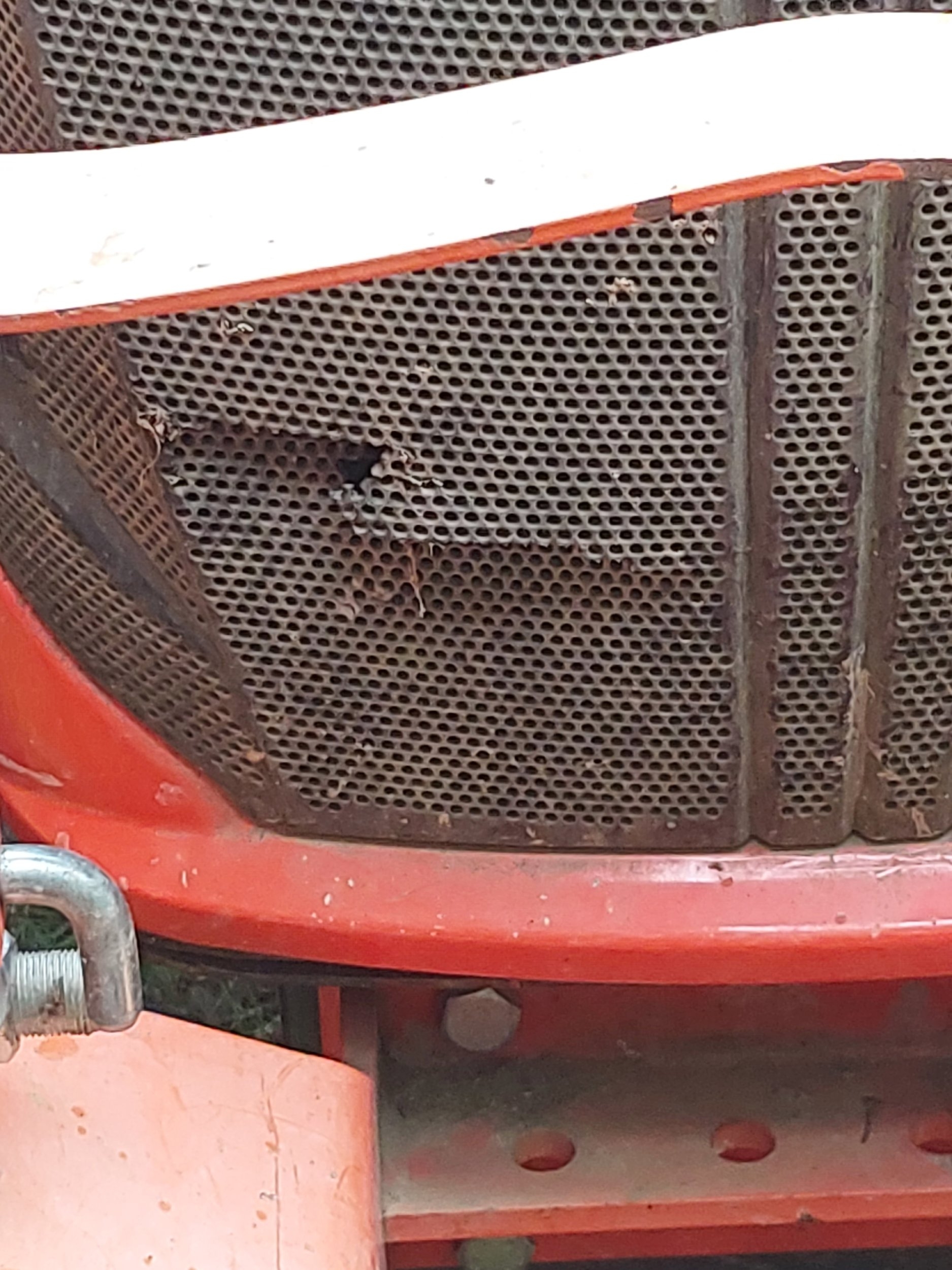

I also have a 511 grill on my Kubota L4060, but only after ramming something through the expensive OEM grill.
It came with stainless hardware, and I take it off every winter for 0400h snowplowing.

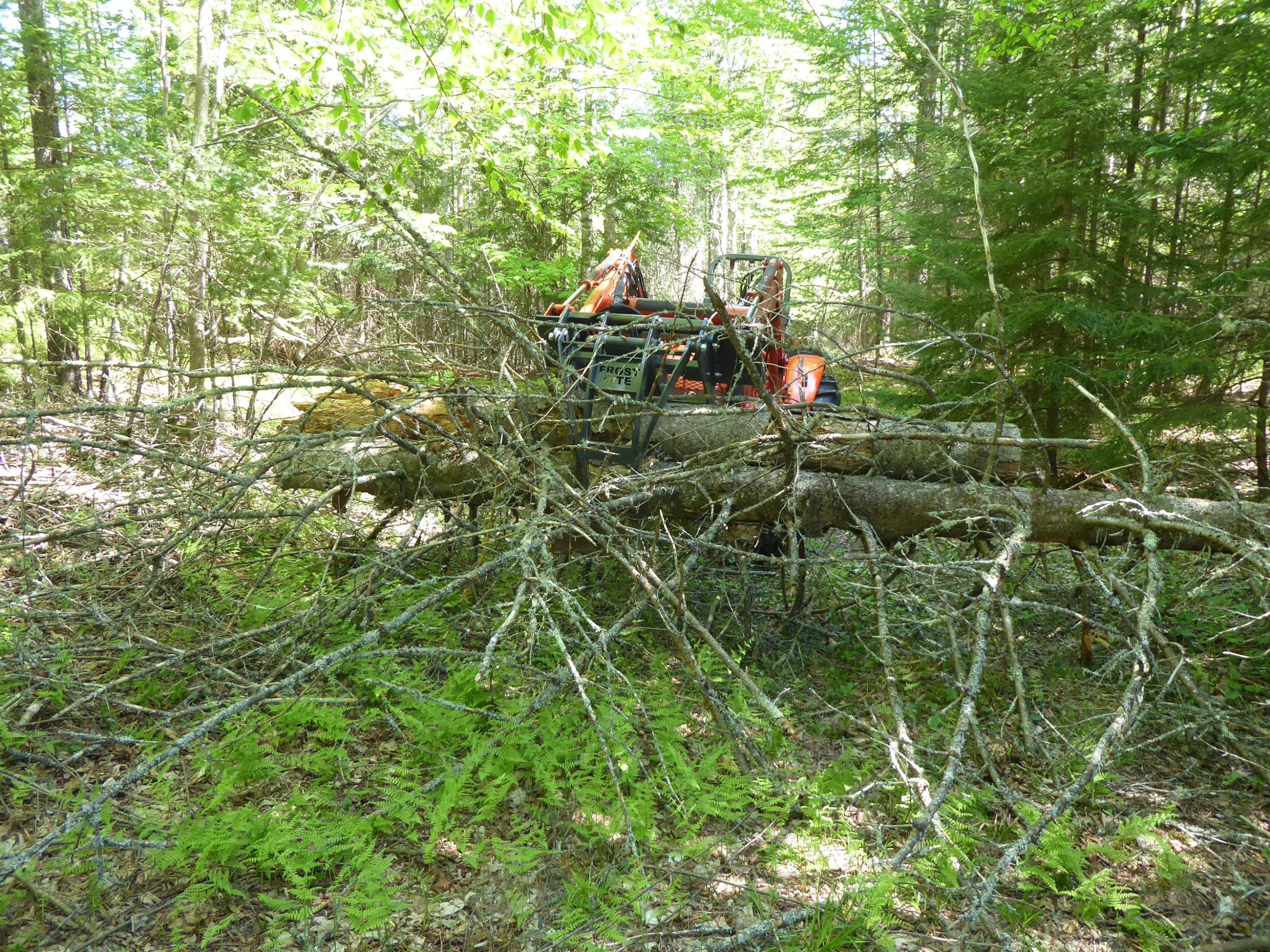

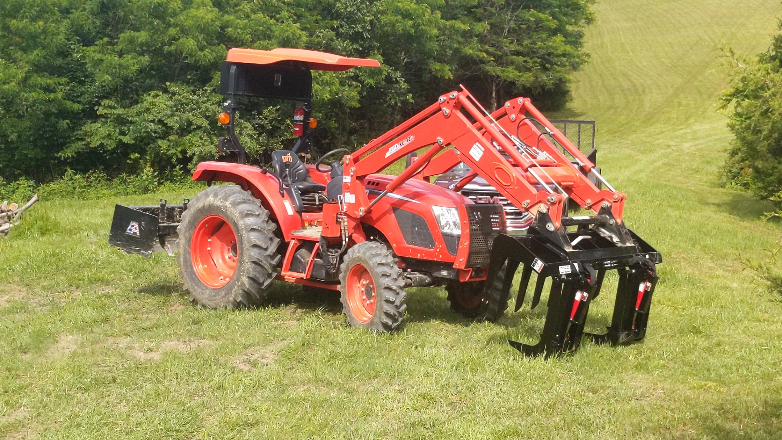

Should have used heavier expanded metal, it's all bent up these days. Still intact, but bent.
Which is a testament to the importance of having a grill guard.
Good job on yours, but yes use heavy gauge expanded metal next time.
My first 'incident' involved a tree stump that shifted, and would have smashed my head lights for sure, without a grill guard in place.

The main reason I posted this. I read a post on TBN where a member had no grill guard. He wiped out his grill and radiator. I immediately had my grill guard modified. Even BEFORE I purchased and had the grapple installed. I know the modified guard has saved me several times. I've picked limbs out the expanded mesh two times now.
I wish I would have asked for heavier expanded metal. This is all the weld shop had at the time. So far - it works 100%.

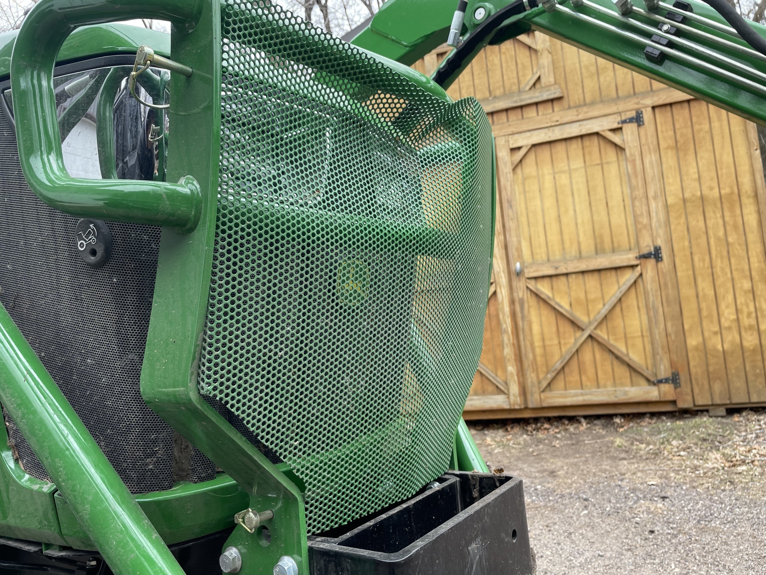

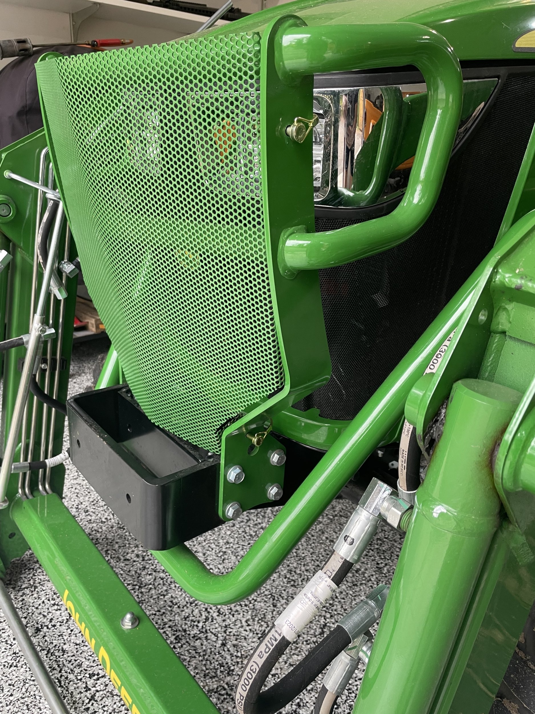

Mine is held on with linchpins, so I have taken it off, used a rubber hammer to straighten it after a branch has hit it.
