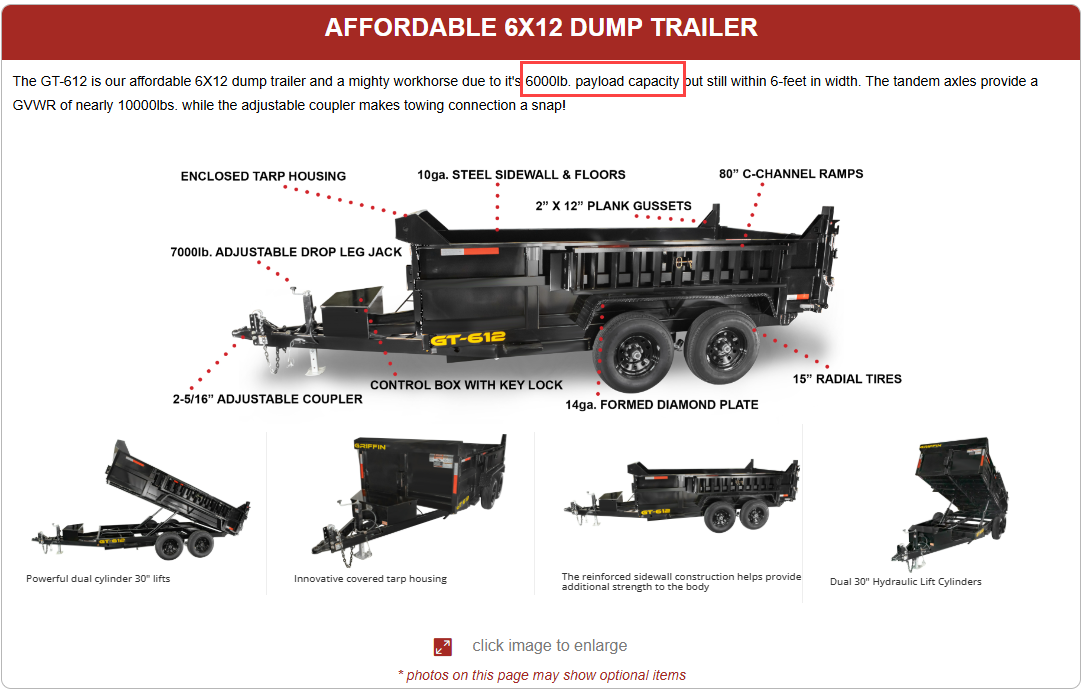

I think most trailer manufacturers spec the cheapest components that will carry the rated load, nothing more. I don't know what you were sold, but you might want to recheck the rated load capacity. The capacity I see on their website for the GT612 6'X12' dump is 6,000# load capacity. I don't see an option to upgrade load capacity, just a jack increase from 7,000# to 10,000#. That might account for your excessive wear. Also check the load rating for the tires. It doesn't list a rating on the website, just 15" radial tires, but they may have been Load Range D 8-ply tires. That would barely cover the GVWR of 9,990# with 6,000# of payload weight. If that is so, I would up that to a Load Range E 10-ply if it were my trailer.

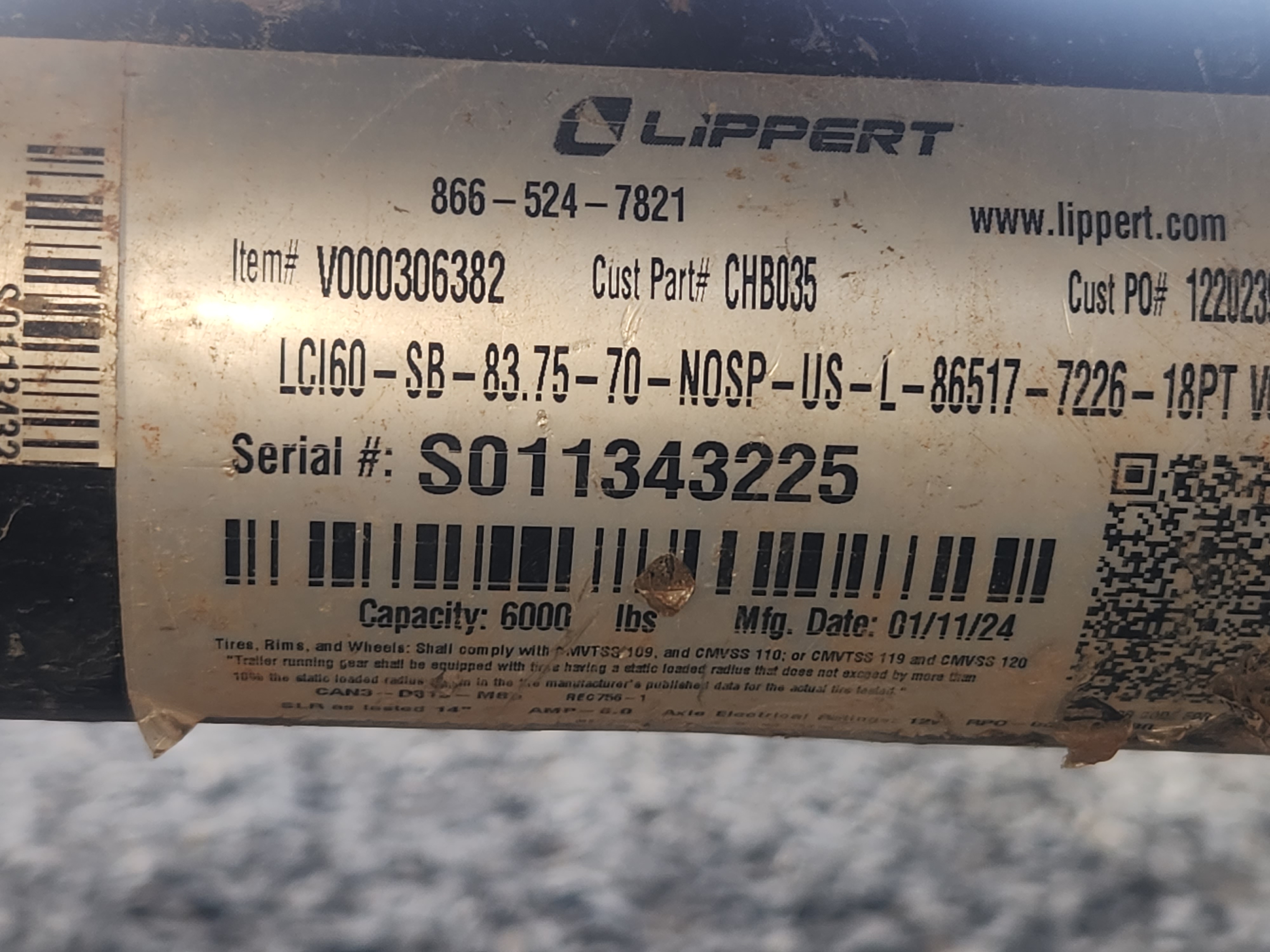

No, it's got 2x6k axles, rated for 8K payload. The sticker on the trailer also says so.
I am guessing they de rated them after poor performance.

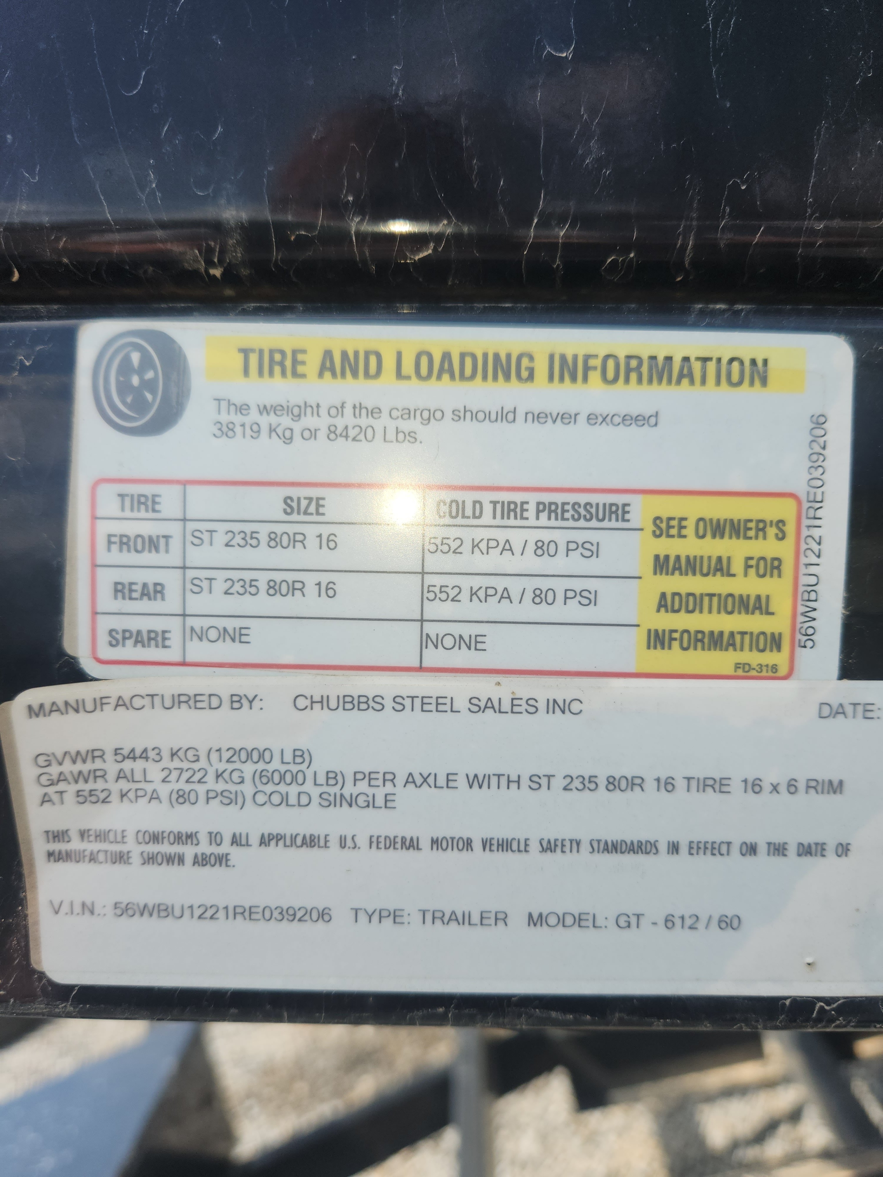

I have a Griffin 6x12 Dump trailer I purchased new in June 2024.
Updated pics to show trailer rating

That seems to be a common problem with Lippert components.

They didnt de rate anything. Theres typicaly two axles. 6000x2 is 12,000lbs

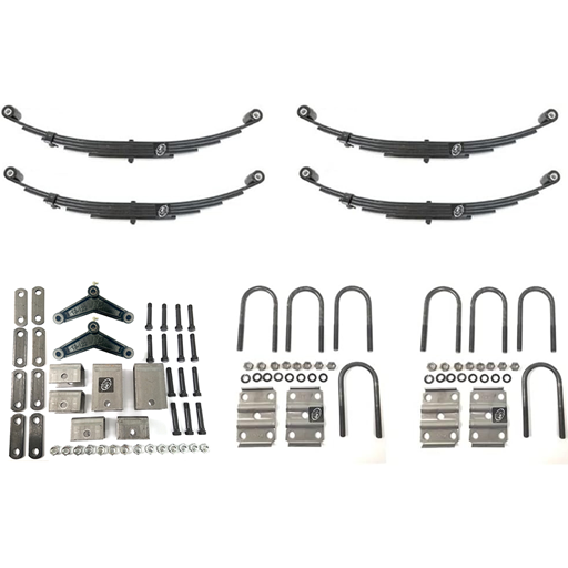

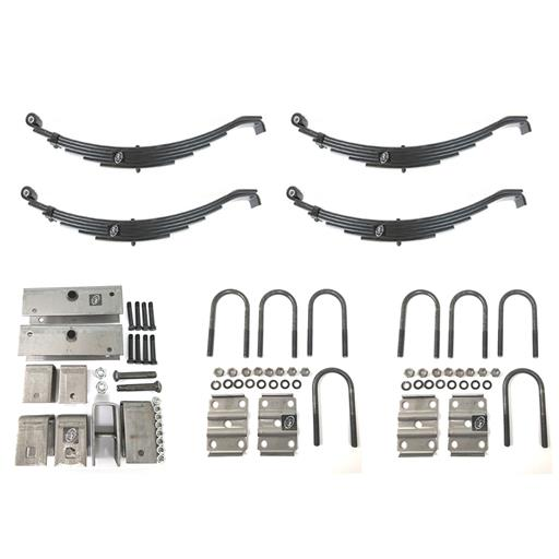

It is not Lippert or Dexter parts that fail or don't fail. It is the trailer manufacturer that is in control of the suspension specs. Economy trailers might spec this type, first picture. In my opinion,10k or less. For 12k-16k the second style is preferred.
