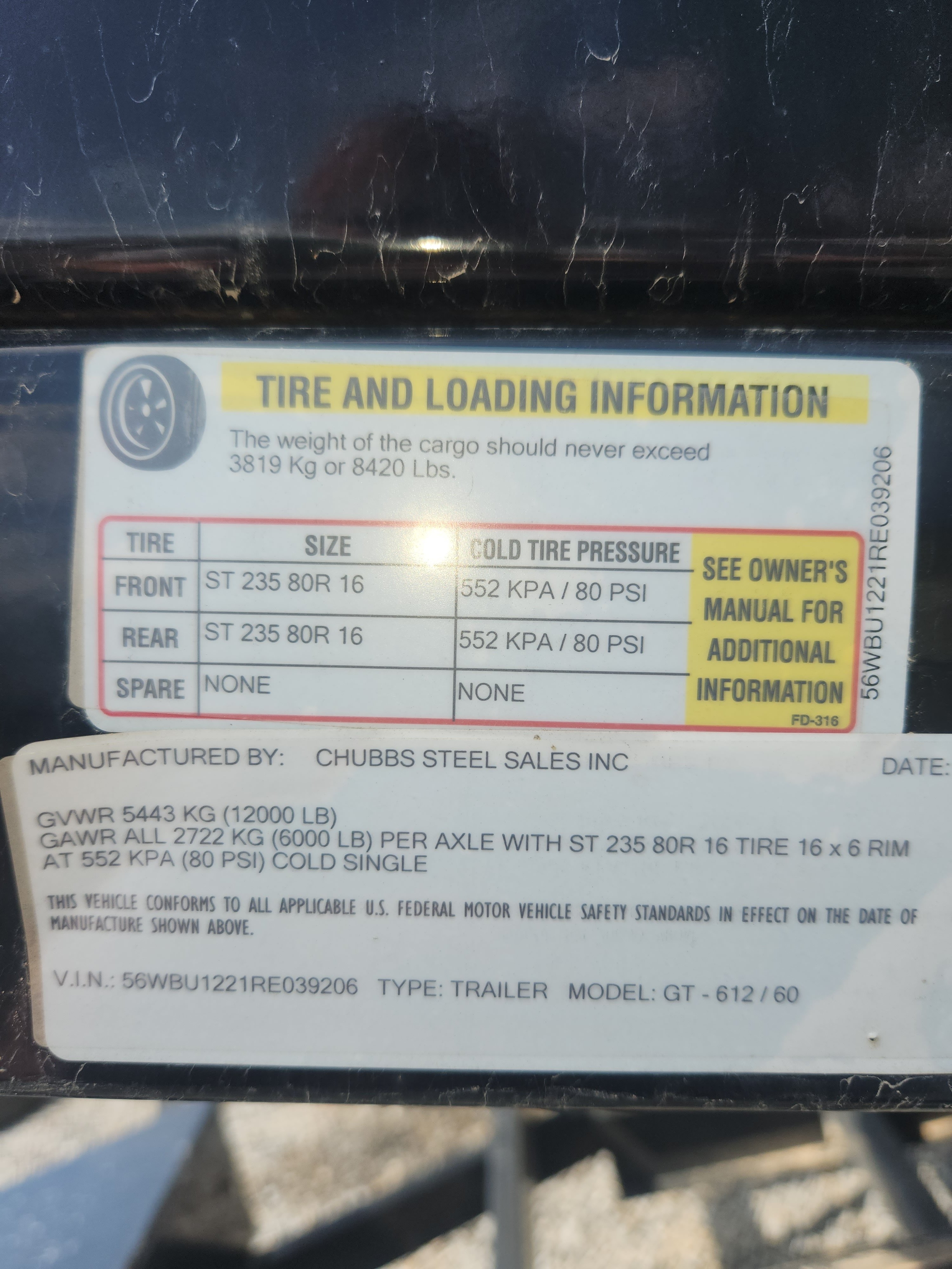

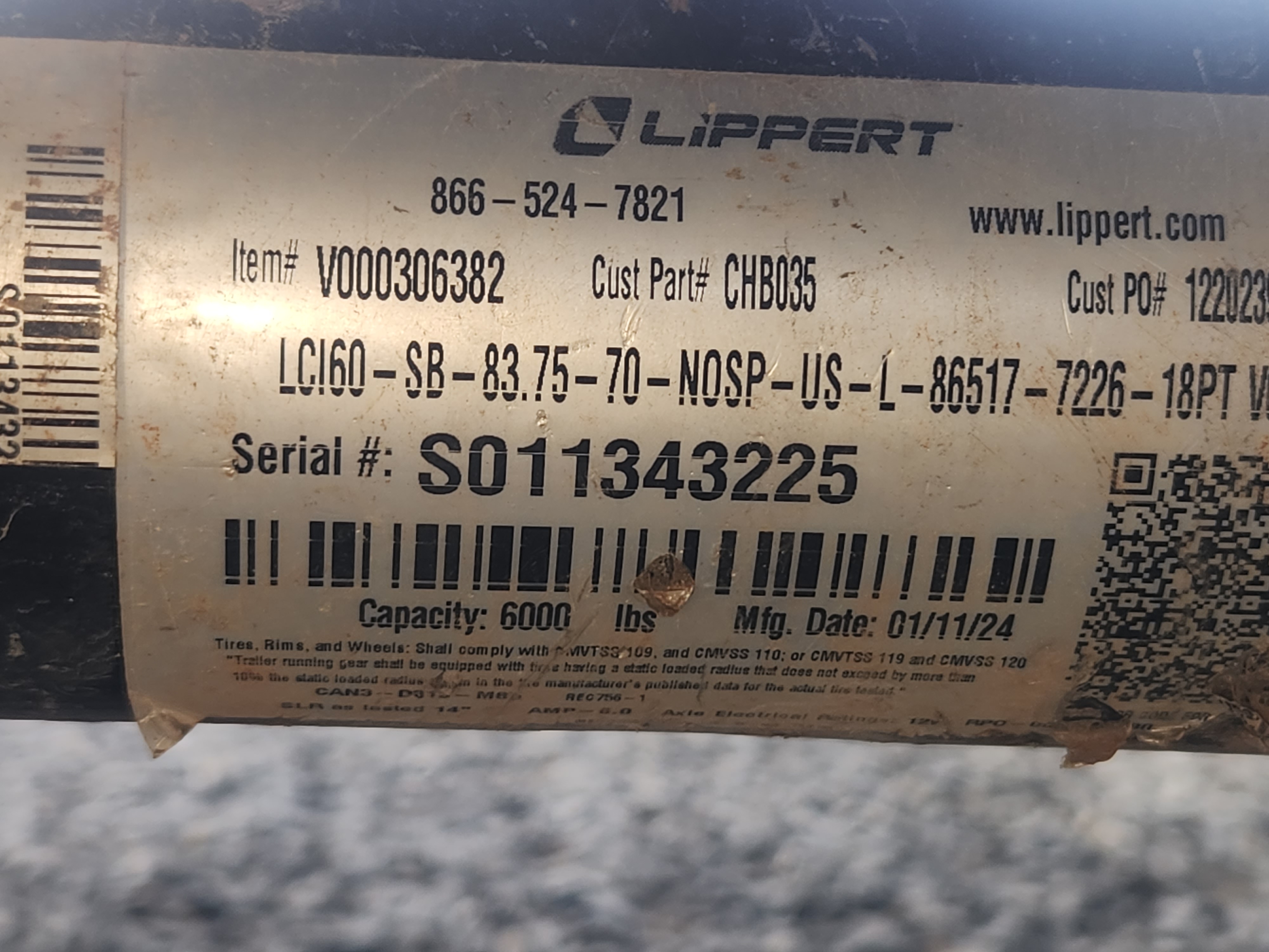

No, it's got 2x6k axles, rated for 8K payload. The sticker on the trailer also says so.
I am guessing they de rated them after poor performance.
Curious:
6k axles but they don't equip them to spec?

I have a Griffin 6x12 Dump trailer I purchased new in June 2024.
Updated pics to show trailer rating
The battery lasted about 3 months
The tires lasted about 4 before they were coming apart.
I just broke a spring last week, not covered by warranty.
I took the suspension apart and found the bushings had all failed, the equalizers are worn out of round, the links are also worn out.
Are these made as though most people would not actually use them much?
That seems to be a common problem with Lippert components.

I'm guessing they de rated after poor performance.
They didnt de rate anything. Theres typicaly two axles. 6000x2 is 12,000lbs
