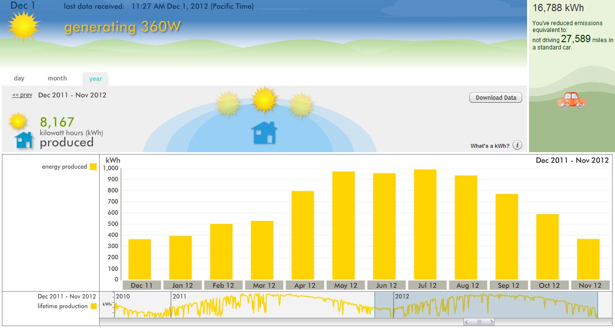

Enphase is kinda nice in that you can see how many systems are around the world (for those that have chosen to allow a limited, public view of their data....most do...it actually defaults to that unless you opt out), and get details on specific ones (the public side)....190,000 systems around the world. You can zero in on your area and see if any of your neighbors have an Enphase system.
https://enlighten.enphaseenergy.com/public_systems
For that one above I finished up last month, today is his one month online day.....his system has produced 1239kwhrs for the month it has been in operation. You can mouse over the blue boxes and see the daily production. Today, for example, was fairly lousy because we had only a little sun this morning, and rain most of the afternoon. He only did 12.3kwhrs today. On a good day, he will do mid-60's.
Click on "Energy Production"....it has Months, Days, Hours. If you use the hours section, you can about tell the sunshine quality of any give day.
https://enlighten.enphaseenergy.com/pv/public_systems/sntr451420/grid/months
