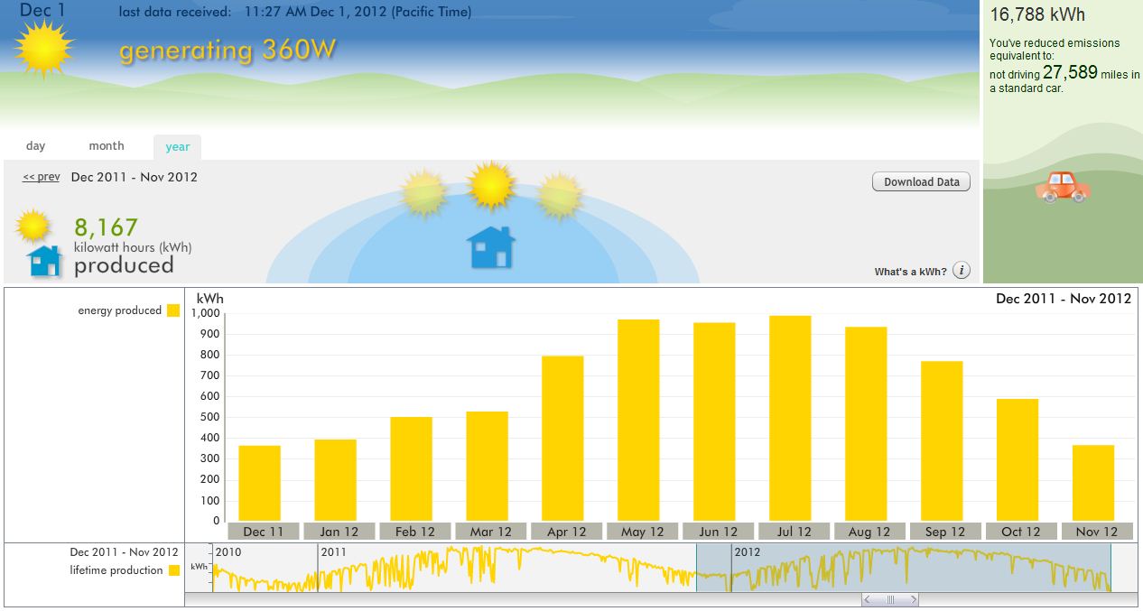

Here is graph of the last year from my 5KW system. The last couple of days, it has been really rainy out here, so production has been low.
Our solar hot water system has been using it's electric back a little too.
I believe the term is "trolling".:laughing:

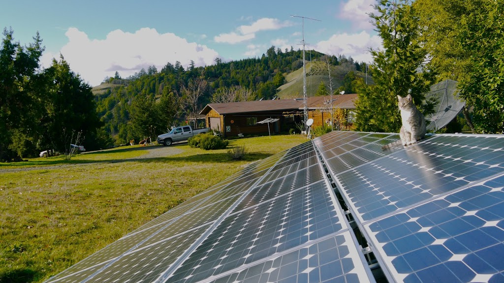

My picture above show my panels since initial installation, at the bottom of the picture. I do not have a monitor for the solar water heater.
I do not see from the panel display website, how to put values to that graph

Data monthly, 2 years running. 5KW system. N. Calif foothills, east of Sacramento.
12/1/2010 183.44
1/1/2011 396.44
2/1/2011 483.36
3/1/2011 507.87
4/1/2011 776.37
5/1/2011 878.74
6/1/2011 887.49
7/1/2011 1022.28
8/1/2011 956.45
9/1/2011 807.38
10/1/2011 621.42
11/1/2011 420.77
12/1/2011 364.9
1/1/2012 394.36
2/1/2012 502.78
3/1/2012 528.9
4/1/2012 795.48
5/1/2012 971.77
6/1/2012 956.48
7/1/2012 990.18
8/1/2012 935.82
9/1/2012 770.55
10/1/2012 589.44
11/1/2012 367.1
12/1/2012 2.38

Thanks. There would be significant savings here if I could generate those types of numbers. 5 year payback?
