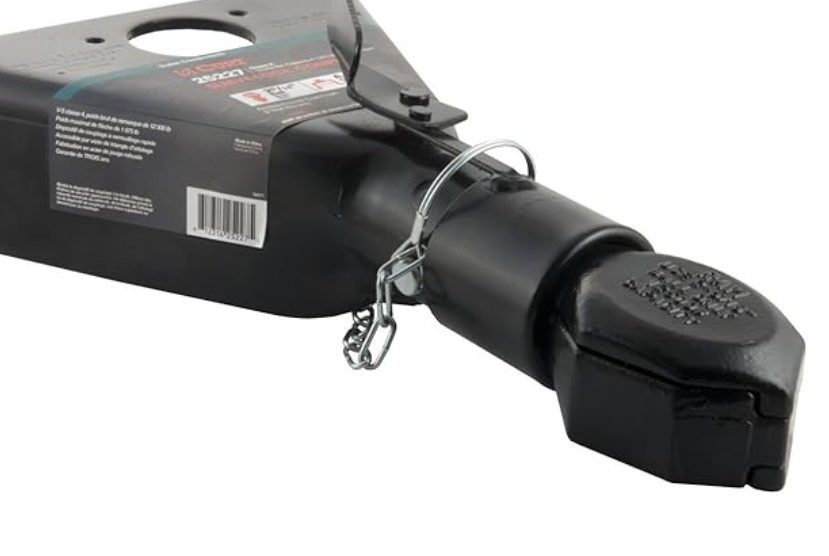

Hello I have a PJ 12ft utility trailer that has a slide style sleeve coupler. It has become increasing difficult to lock/unlock the coupler and I'm not sure how to grease or oil it. The style is like this:
It only slides maybe and inch or so (by design) and there's no want to disassemble it that I can tell to clean and grease it up good. I can spray something like WD40 under the sleeve but I'd like to use something that will stick and last longer but there isn't much of an gap to spray into and it neesd to penetrate fairly deeply. Any recommendations?

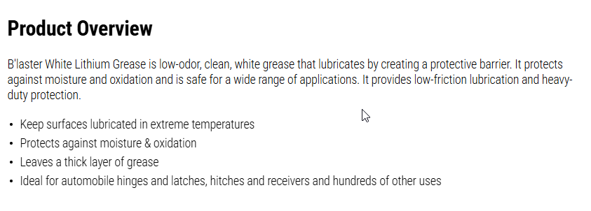

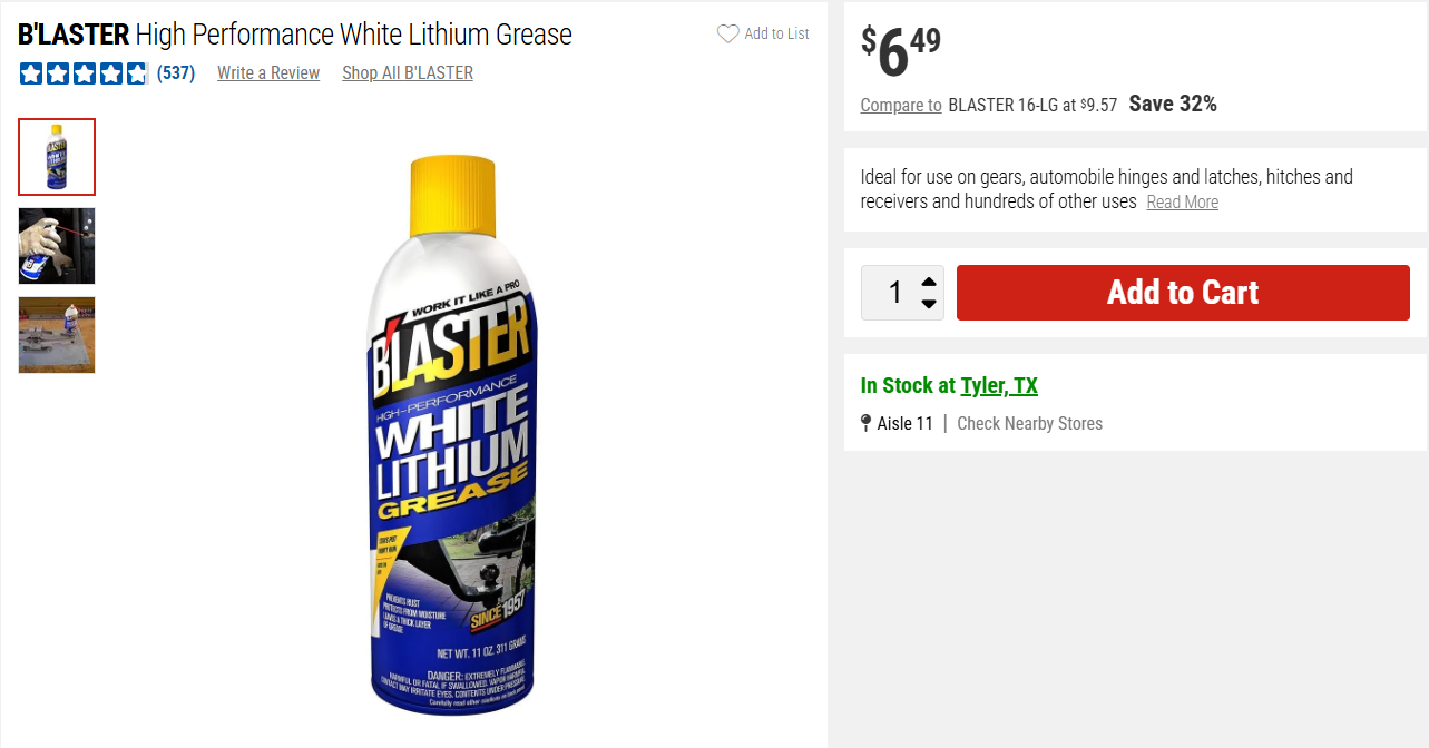

IMO, I use this for the slide
and this on the ball
