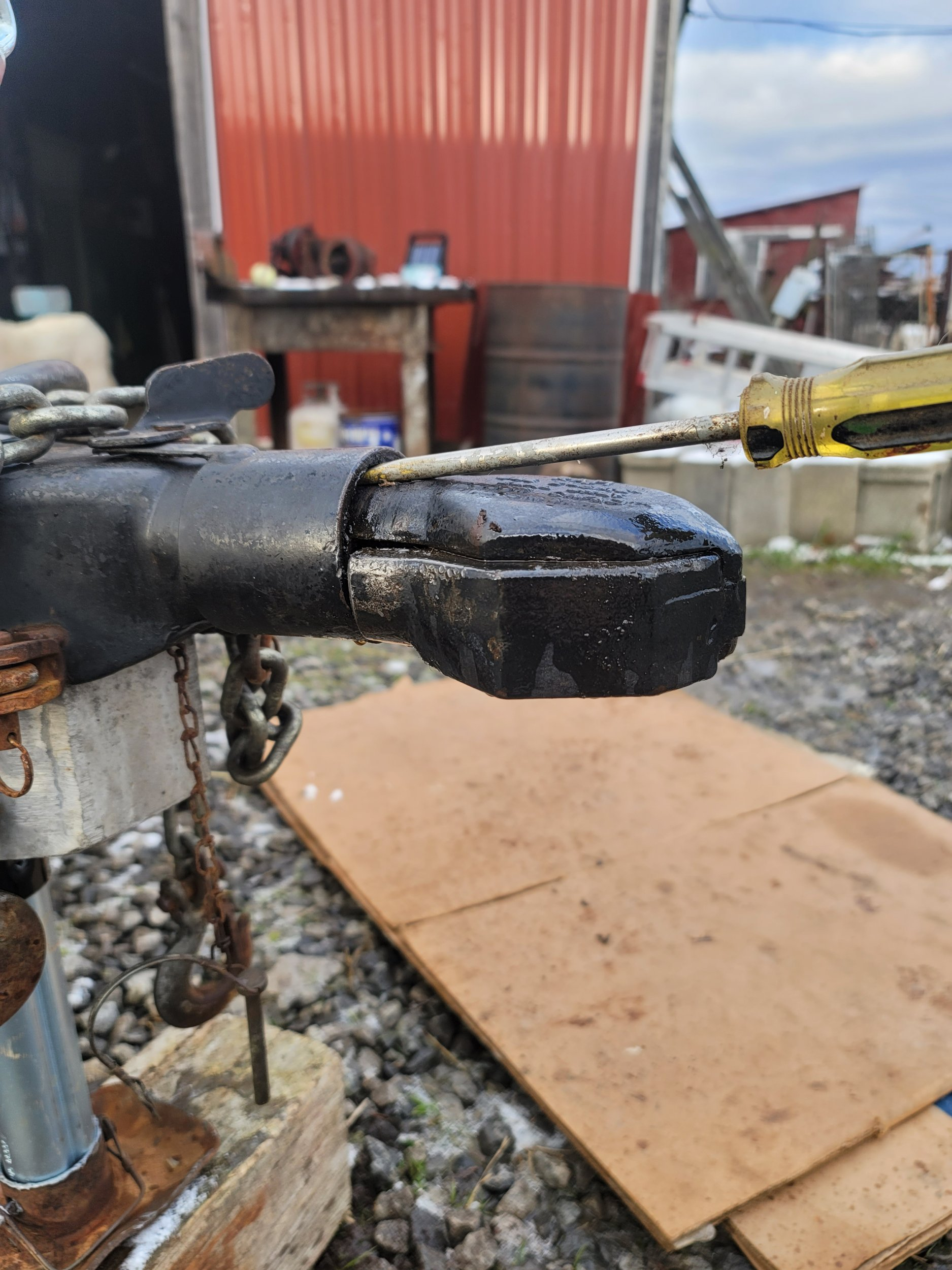

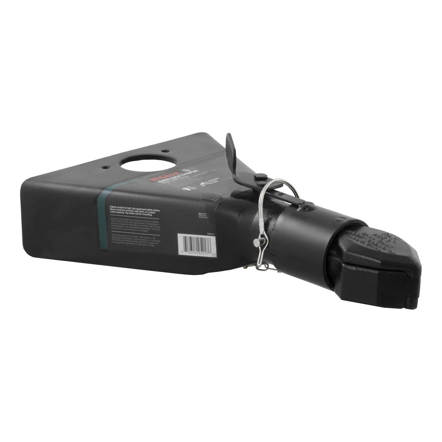

I am having an issue getting this trailer couplers' hinged jaw to move freely. The spring is good but isnt strong enough to push the jaw open. Has anyone had an issue with this style coupler and getting it to move? I had used penetrating oil all over the front of the coupler and on the under side. I then used a rubber mallet to pound it open and closed. I would prefer to not replace the coupler but here is a picture of what it looks like (not mine exactly since I forgot to take a picture while I was outside).

A quality penetrating oil (not WD40 or Liquid Wrench) maybe a little heat, open and close it until it loosens up. Might take 20-30 cycles or more.

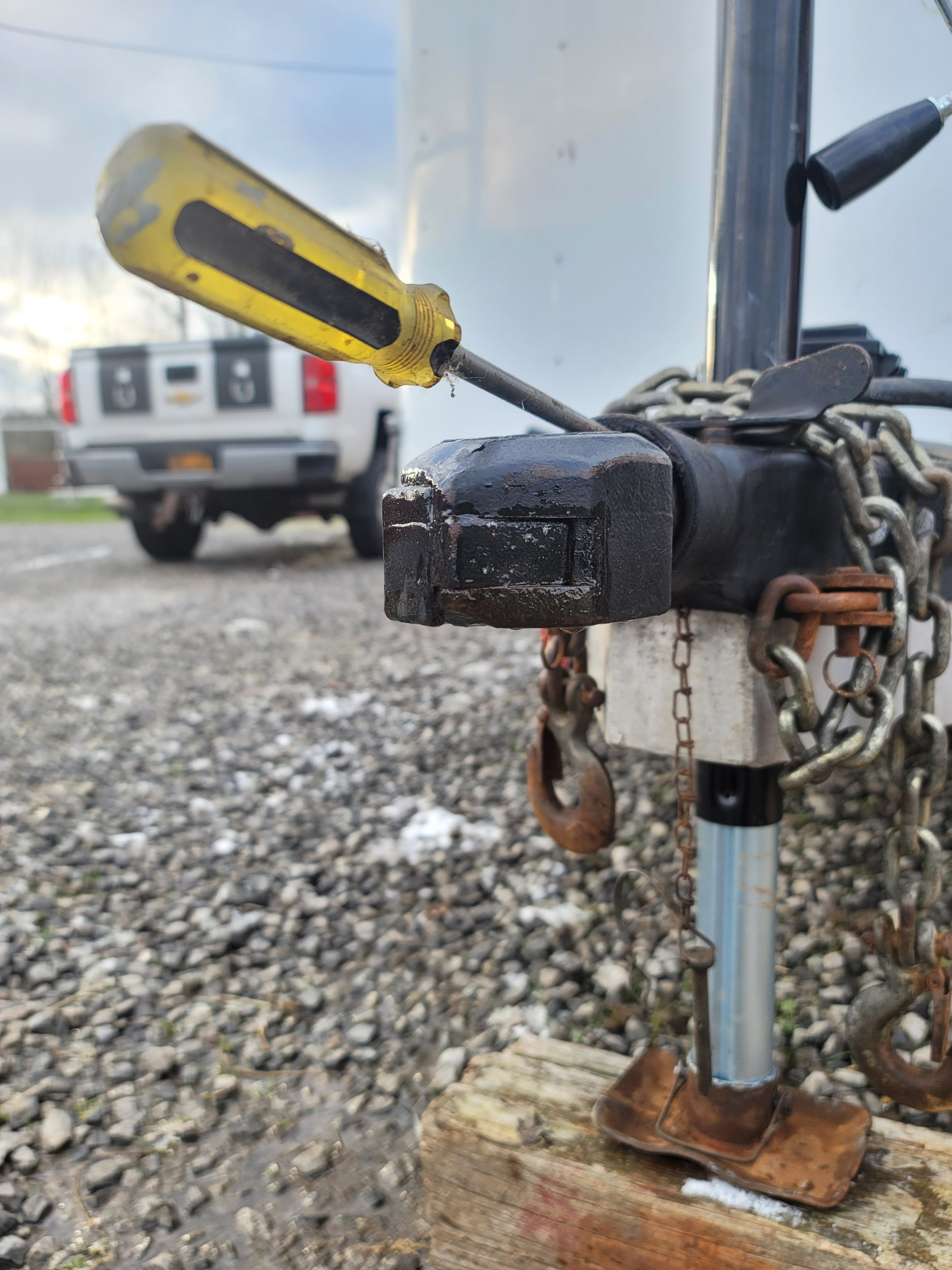

No difference with the oil. I've taken the spring out since it's not strong enough to open it. There's not much of a gap between the jaw and the top of the coupler...is there a way to remove this piece? I could clean it better and grind down the top of the jaw so there is some space to move...

Clean all the grease & schmutz off of it and paint it red or yellow whn pulled back. Then look for the paint scrapes when you get it in and out of coupling. Then grind the area where the paint tell-tale is.
Of course, the collar may be oblonged because of an over travel. Can you roll it around to check this ? If it's ok when parked and not attached, then suspect a ball or ball compartment problem.

Just a quick update. I got it moving. Needed a second set of hands to operate the torch and we heated up the end while I moved the jaw back and forth. Took a bit but then it just gave and went easy. It is now all greased up and ready to go.
