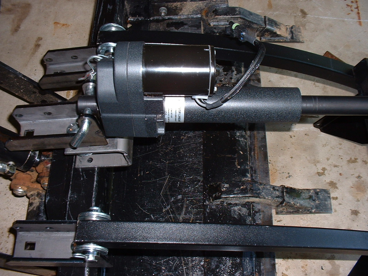

Red spray grease caused this mess as you can see in the background. It's all I had around my shop at the time? All it does is collect dirt, dust which can cause more wear on the joints. I will be giving the PT a good cleaning soon this will be removed.
I may take your advice and use the Lipplate graphite spray. Does it cause less collection of dirt when digging with the bucket? :confused:

Barry,
Slipplate spray is messy to apply. I wear surgical gloves. Super Lube dry spray is less messy and I don't wear gloves. Both products are dry and do not collect dirt or debris at the joint. I have also used Commet graphite spray used for snowmobile clutch. It works as well as the other two products but is considerably more expensive.
Dale
