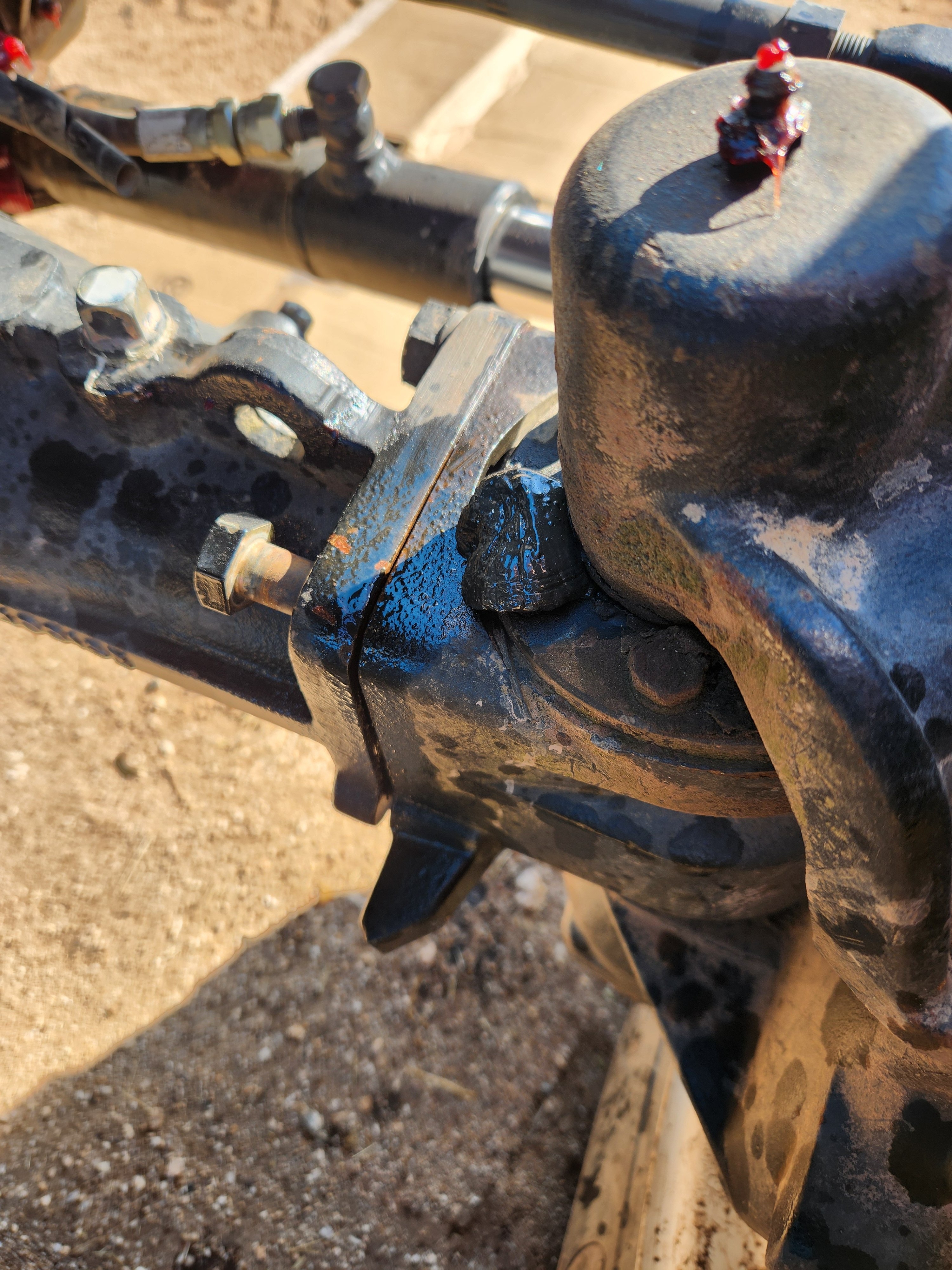

Just got my 4047 back after losing it in a divorce. I had a thread going on the trailers and transportation section.
Upon getting it home I wanted to give it a good grease and inspection. When I got to the right front I found this😱, three out of the five bolts holding the front drive to the axle were broken. Has anyone separated the drive unit from the axle? Is there just a splined drive shaft running through or is there more to it. I thought if I separated the drive I could get at the broken end instead of laying underneath and trying to drill, then easy out.
Any advice would be appreciated. Here's some pics.

One of the more interesting ways to deal with this I have seen was a guy welded a new (smaller) bolt section to the broken off internal sections. The heat released the rust & corrosion and an impact wrench pulled out the broken pieces. No need to disassemble. The other option is with 'easy-outs' punched into a carefully drilled centered hole in the broken studs. But you still need to release the rust. Shock heat works the best.
/ Broken bolts on front axle #3
Any guess on how that happened
/ Broken bolts on front axle #4
Not having easy access to a welder I have had success with liberal use of penetrating oils followed up with a left hand drill bit.
As the left handed bit bites it applies force in the same direction needed to back out the bolt.

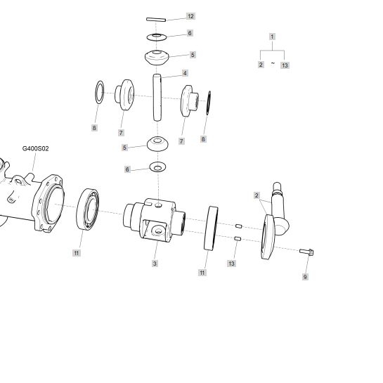

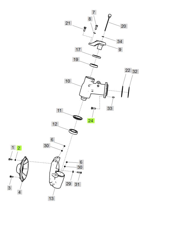

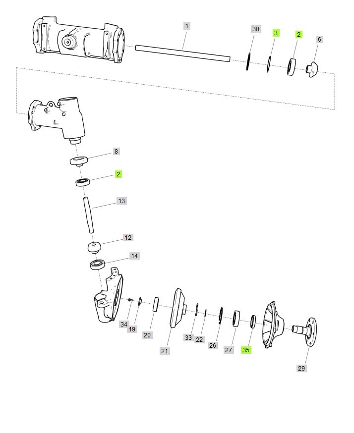

HERE IS A BREAKDOWN DIAGRAM OF THAT FORNT AXLE AND HOW IT COMES APART HOPE THIS HELPS.

I have seen broken axle bolts like this a few times, usually caused by the bolts loosening over time. Just fixed the same issue on a MT235HE. Luckily the bolts were not rusted in, thats why they came loose and caused the problem. Only the heads broke off so when the housings separated, I could spin the part that stuck out with a small thin channel lock pliers and unscrew them. I only had to drill one that broke off flush with the housing. Came out easily with an extractor. If you do need to remove the end axle housing, yes it has a splined shaft inside that slides out. Now when I service the tractor, I always check these axle bolts as well as loader frame bolts and wheel nuts to make sure they are tight. I know a few people that had these axle bolts break and there was even one bolt missing that came loose and fell out, and nobody noticed it until the others broke off. Low strength Loc-tite is a good thing.

I would pull the part after removing the wheel assembly. You are going to want to know is the bearing and shaft have suffered.
Less than 15 minutes to break it down, It will save way more time than that dickin' around.

I started working on it yesterday. I removed 2 out of the three broken bolts easily. The third I had to drill and try an easy out. Even with heat I couldn't budge it. I'm going the HeliCoil route on that one.

I use with great success, the Howie machine method of removing broken off studs and bolts. My easy out's and spline drive extractors now stay in the tool box...
I place washer over the proud end of the broken fastener and MIG weld the washer to the broken part and then I MIG weld a suitable hex nut to the already welded on flat washer and use the hex nut to remove the broken bolt / stud. The heating of the fastener when welding on the washer plus the nut helps loosening the broken off fastener and it works (comes out) like a charm.
My extractors stay put away now, even the spline drive extractors are no match for the weld on method and if the fastener is broken off a bit below the surface, I just build it up with MIG weld and then add the washer and nut.
Of course you need a MIG welder and a steady hand to achieve the desired result.

What people don’t realize is most of the time drilling for the ez out typically produces enough heat to free up the bolt shank without taking a torch to it lol. Good luck!

I wish lol. This one was really stuck. I had good purchase on the ez out and really had some torque on it. If I put much more on it I'm afraid the easy out would break.....and I definitely did not want that!

Then it was really stuck lol! That is when I’d break out the torch. Since you have a hole in the shank now the heat will get to the threads better. Also sometimes when working on stuck bolts I’ve found it’s good to stop once in a while, go away and get a sandwich then come back to it. Sometimes giving it time it would free up from the previous work.
