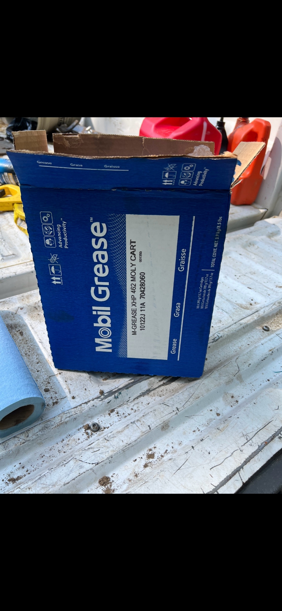

Tried the horizontal storage. The oil that stays in the gun then runs out when you are using it, dripping onto everything beneath. If you happen to be laying under a piece of equipment, guess what's beneath...
I switched to this Exxon grease. Even in 90 degrees in full sun the grease stays in the tube without running everywhere like red grease does.
