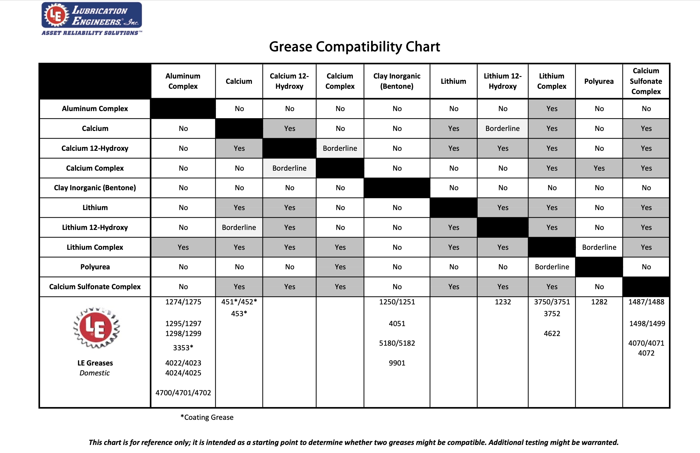

In the Texas oilfield and farm we used to have problems with grease compatibility - at least we thought compatibility was the reason that caused grease to harden. Loader bushing pins locked up by hardened grease were a big problem - we never could figure out why it happened some times and not others.
Of course lots of times we were greasing equipment without knowing what kind of old grease was already in there. We avoided aluminum based greases just because grease tables show they aren't compatible with most other types of grease.
Does any of that apply to Shaeffer's aluminum based grease?
From the chart, Lithium complex seems the most compatible.
