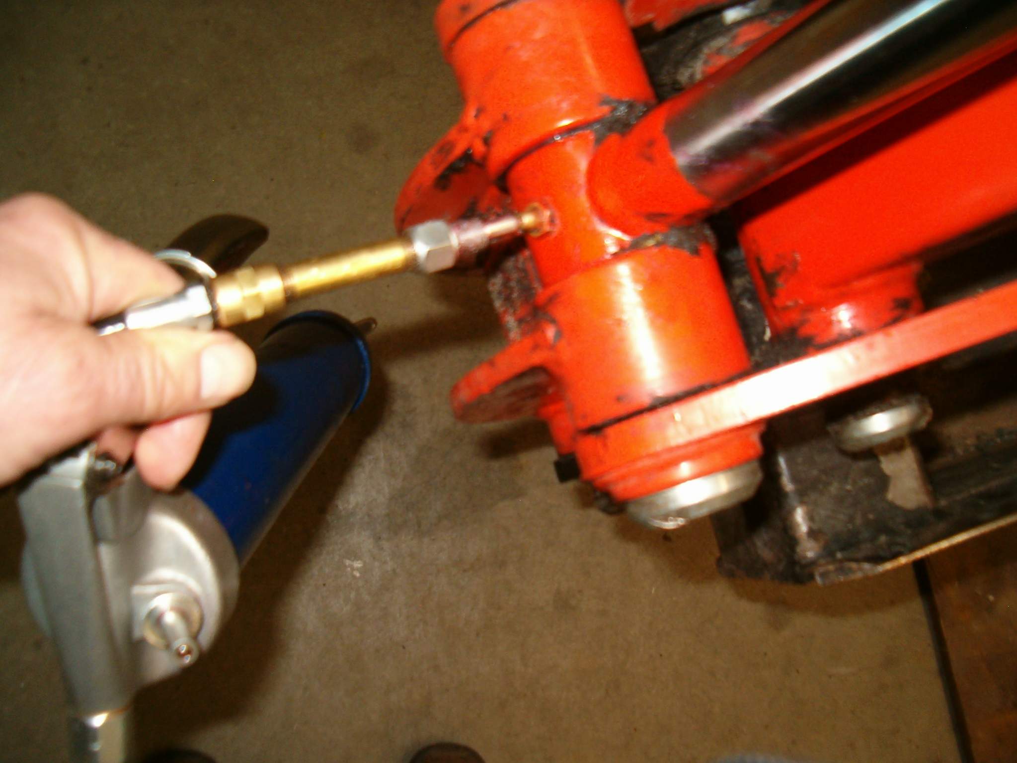

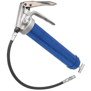

I'm tired of dragging air hose around my tractor with a gun bound to fail. I'm convinced now that air grease guns are not likely to last. I bought a single handed squeeze grease gun by Lincoln and had it about a year. It actuallly completely can grease by tractor loader backhoe without the need to stop and spend countless hours trying to get those air powered guns to work.
Here's another tip. Don't you just hate those stupid grease gun end couplings won't release from the zerk. I have tried loosening the barrel and they still remove stubbornly. Get yourself a nice long flexible hose and put on a needle tip. It just takes a minute to get used to hitting the little spring release with the needle tip . You can tell when it's centered because it wont slip. You can feel the gun have the needle buried in the little spring hole stop in the center of the zerk. A couple squeezes while holding the zerk and tip together and away you go to the next zerk. You are not playing tug of war with the tractor trying to get your gun back.
Works for me and those single handed blue barrel Lincolns ar only $20-30.

Well...if you have a picture or 3 post it up, I am to much a newb to follow your line of thought here... Thanx Though!

OK, here is the lincoln one hand squeeze grease gun with a hose and a needletip end instead of barrell grease end. Just line the needle tip grease end with the hole in the middle of the zerk and press in. You will feel the spring depress then give the grease gun a couple of hand squeeze pumps with one hand while holding needletip tightly against zerk. I did my whole TLB with this set up and I could get at every zerk. As some of us know backhoes and FEL's have lots of zerks.
rim

Ah HA! Now I get your drift... THANK YOU! That very well could be a "Speed Tip" . I ordered a Lincoln 1134, should have it in a couple of days. We will see how much of a pita it is, or is not.

good call on the 1134. :thumbsup: It'll serve you well.

For a manual gun i recommend a Lincoln 1134. Its what i use. Its their heaviest duty manual gun. Generates high 7500 PSI for those nasty plugged fittings. Not the cheapest, but its served me well.
