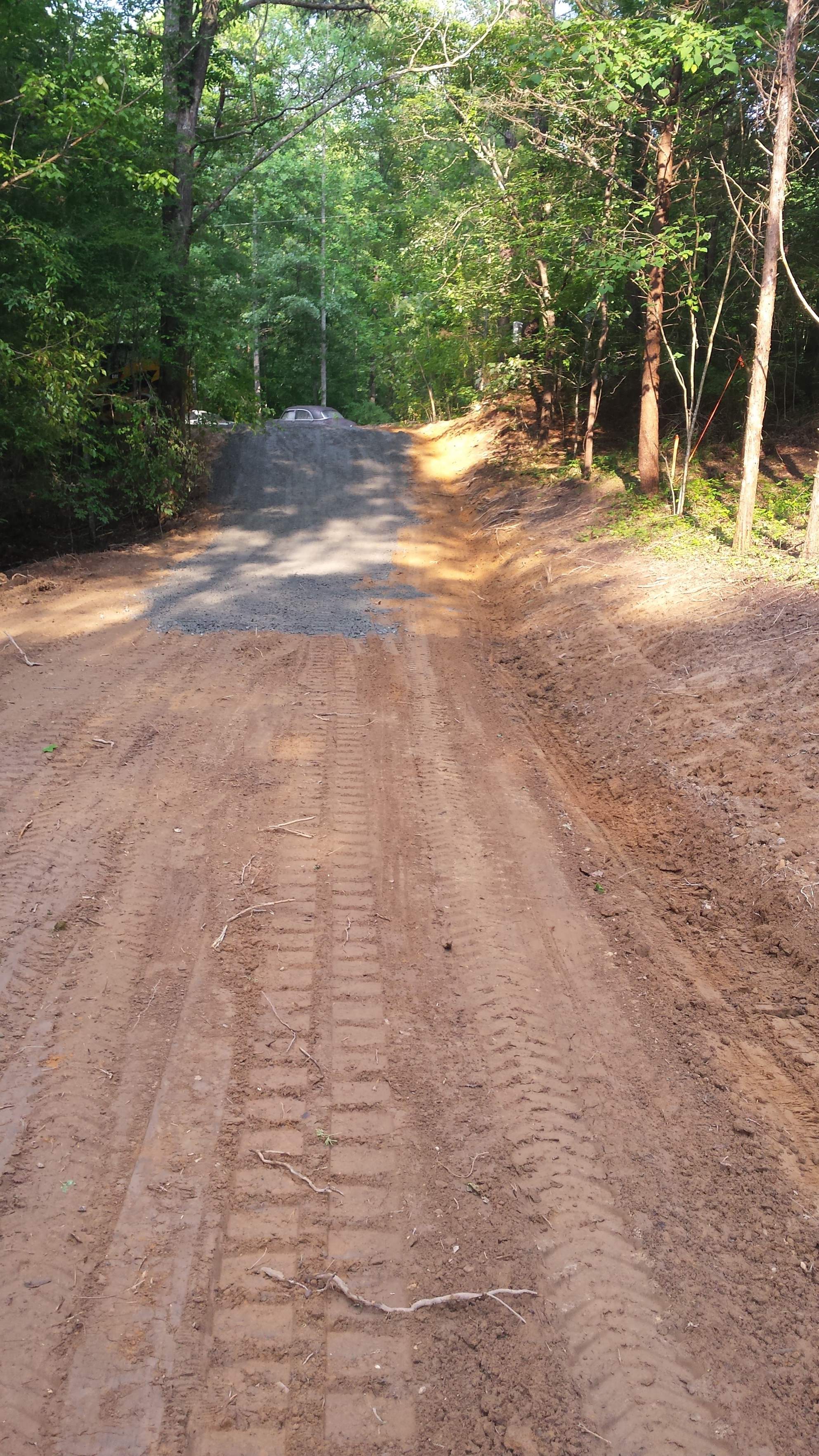

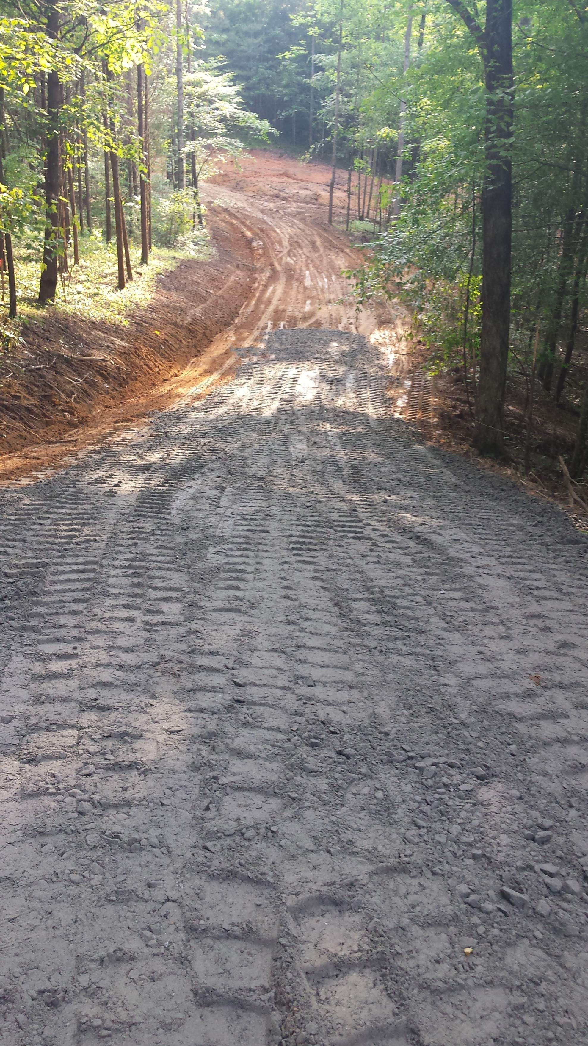

Been a few years since this project was finished so I thought an update would be nice.
I have an endless supply of shale here on the property which I used as a base for the road, the shale base was used to fill low areas (2 draw crossings) as well as provide a stable base 6 to 8 inches below grade. We brought about 22 loads of crusher run to top off the shale which packed in very nicely. Maintenance has been done with a box blade every three months or so just to pull the larger pieces back to the main tracks and maintain the arch for drainage. We are to the point now where I would like to top-dress the entire drive with 3/4" which will make the drive smoother and more aesthetically pleasing.
/ Gravel Drive width? #49
3/4 minus will work much better than washed 3/4.
The 3/4 minus will pack like concrete, the washed 3/4 will migrate as vehicles travel over it.
