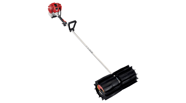

PS344.png PS344 | PowerBroom™ | Shindaiwa-USA.com
bought the above awhile ago, not cheap, heavy but it beats racking! fling it into the bucket then dump it.
