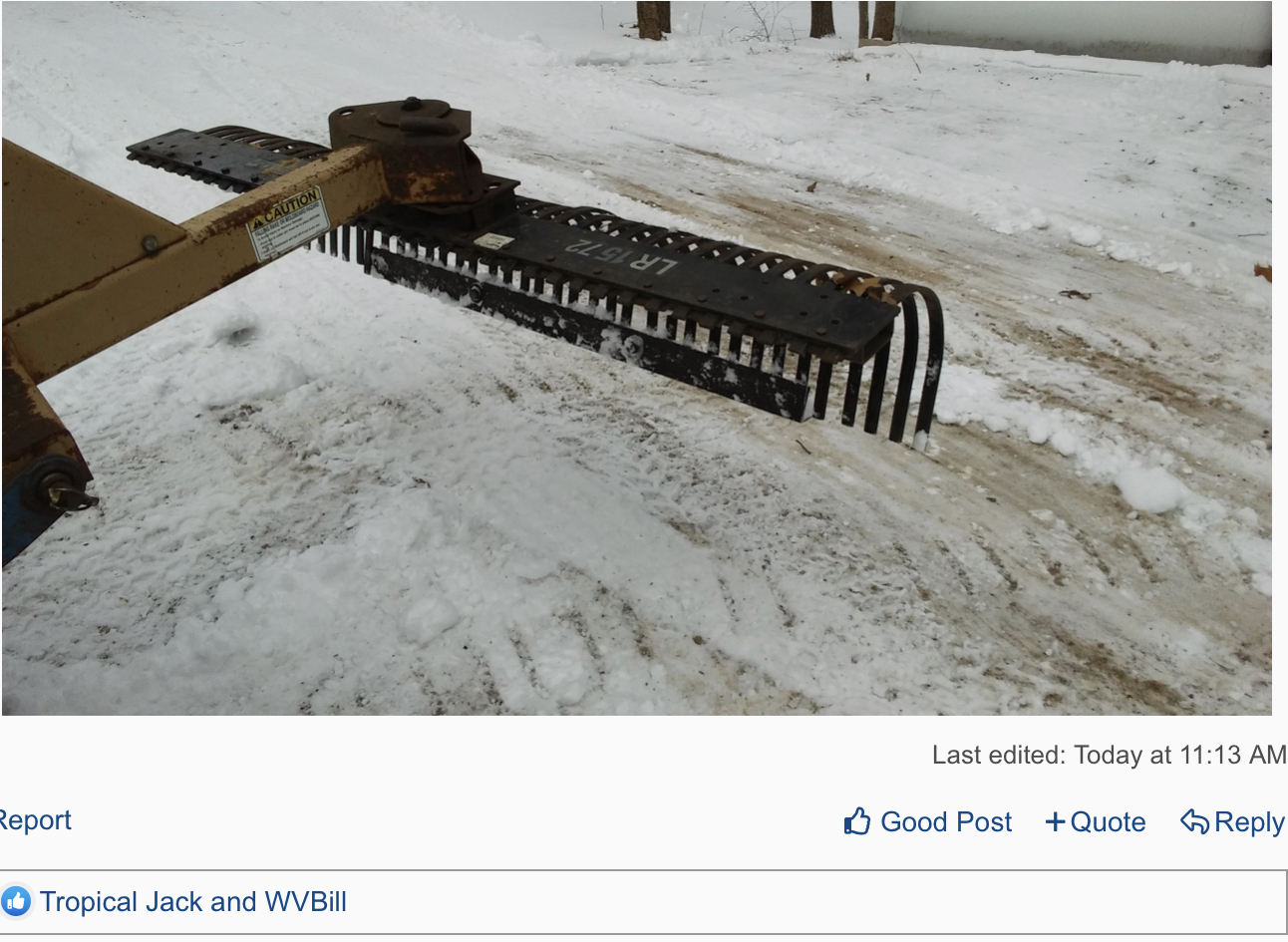

Try one of these. May have to go over three or four times but it will loosen top inch without disturbing your packed base. I use one for a my gravel driveway (3100 ft lenght). Saves me from buying so much gravel. Once you have an establish packed base this keeps the top inch loose.
Any big rock or grass that is pulled up move to the sides. Use for filling wash places that occur in the future. This is the cheapest way to try. If it doesn't work you can always purchase the other equipment when caught at a good price.
