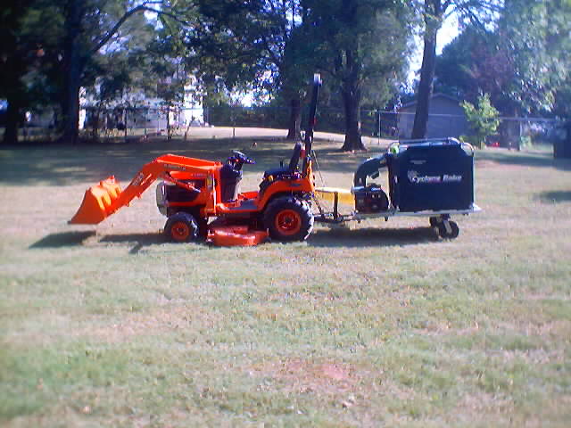

A shot of the original deck adapter. I discovered that the std quick attach hardware wasn't stout enough to hold the adapter plumb to the MMM once the weight of the heavy duty hose was added so I cut and mounted an additional metal bracket towards the rear of the adapter and it kept the adapter from pulling down and exposing a slight opening for debris to escape. The fab'ed plate is visable at the rear also.
The adapter comes without the opening cut. Once you mount the adapter, you then mark then cut th eopening. I used a small scroll saw.
   / Grass and leaf pickup, what do you use, recommend?
#22
The CR mounts to the BX's 3PH with all the required hardware included in the kit. One thing I discovered whilst mowing was that the weight of the CR would continue to push the 3PH arms down past the MMM deck setting which caused the front of the CR's hitch to gouge the ground in slight hills.
Instead of having to worry about constantly jockying the 3PH to get the MMM lowered to the correct depth setting and keeping the CR from lowering past it, I just used a simple check chain setup to keep the CR from dropping lower once the MMM was at depth. I may refine it more later but for now it works good, lasts along time /forums/images/graemlins/grin.gif

I ordered my Cyclone Rake today for my bx1500. It ships tomorrow. As I look at my 48" mmm deck opening, I'm having a hard time visualizing how exactly the mower deck adapter mounts up to the mower deck. If you get a chance, could you possibly post some close up pics of the mda mounted to your mmm?
Also, anyone else who has mounted one of these to a bx 1500 w/48"mmm, I'd appreciate any tips or advice. Thanks.
#25
The adapter basically hangs on the MMM via two threaded studs (included in the kit). There are two large threaded knobs that screw down and holds the adapter tight to the MMM.
You'll have to drill a couple holes in your MMM for the studs and once you get the adapter lined up with the bracket you then drill and bolt the adapter to the quick attach bracket (nylock nuts & bolts included).
I added an additional bracket on the adapter because the heavy duty hose cocked it in the rear just enough to allow clippings to shoot out. The home made bracket fixed that!
You'll need a drill, some bits, 1/2" & 9/16" wrench(s) and sockets. Plus you'll have to cutout the opening which I used a scroll saw.

Heres a pic of the adapter mounted and the knobs screwed down. Connection of the CR is very easy and doesn't require any tools, just like the rest of the implements on my BX23. /forums/images/graemlins/grin.gif /forums/images/graemlins/grin.gif
The instructions are self explanatory and detailed. I'd venture to say that the 48" MMM doesn't have as big an opening as the 60" so you probably won't have to fab up a plate to cover up the 2 1/2" gap that is present on the 60".

Just received my CR Commercial Pro with 7HP Briggs. Have not yet unboxed, but plan to tomorrow. The Mower Deck Adapter is just slightly smaller than the opening on my 54" deck (18-5/8" vs. 19" outside to outside). Woodland says this is no problem. Did you find similar differences, and was it an issue? /forums/images/graemlins/confused.gif

Sounds like you've got the same adapter they sent me. My 60" MMM's opening is approx 20 3/4". They told me to make a plate to cover the approx 2" opening and I did.
They also sent me a longer but shorter adapter and the original taller adapter with my home made plate fit and performed much better.
Making a plate to cover the opening isn't that time consuming or detailed. It only has to support it's own weight and be rigid enough to deflect the air & grass. The suction of the CR not only pulls the clippings towards the opening but it also keeps the bottom of the MMM surprisingly clean & free of clippings.
Start by mounting the adapter and once it's properly mounted, find something you can use to make a plate to cover that rear opening.
I bent an 20ga piece of scrap steel I had laying around to where it would completely cover the opening plus give me a couple of extra inches to bolt to the adapter. It does pretty good and no clippings escape from around it. Theres a blurry pic of it at the top of pg 3.
