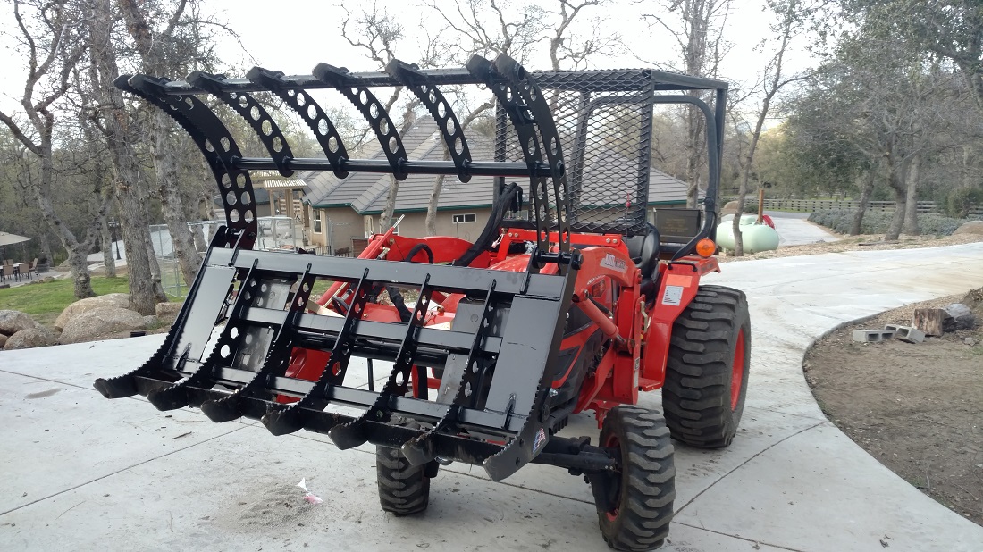

Finally got to use my home built stump bucket grapple and I知 super happy with it. Now I can join in this thread. The rock is about the biggest I can lift with my poor little L2501
View attachment 553588View attachment 553590View attachment 553589
Not sure why the thumbnails are sideways but if you click on the image they are in the right orientation.
Very nice, indeed! Would love to see some more pics of your grapple empty, to show your handiwork better.
About the thumbnail orientation, this happens to me as well when I upload an image to TBN from a computer file, although not always. Very puzzling. :confused: Maybe other TBN'rs can advise on why this happens.
/ Grappling fun - A Picture Thread.... #1,714
Nice work Stomper !!!! Looks very professional.
/ Grappling fun - A Picture Thread.... #1,715
Thanks guys. It was a fun project. I will try to remember to get other pictures for you threepoint.

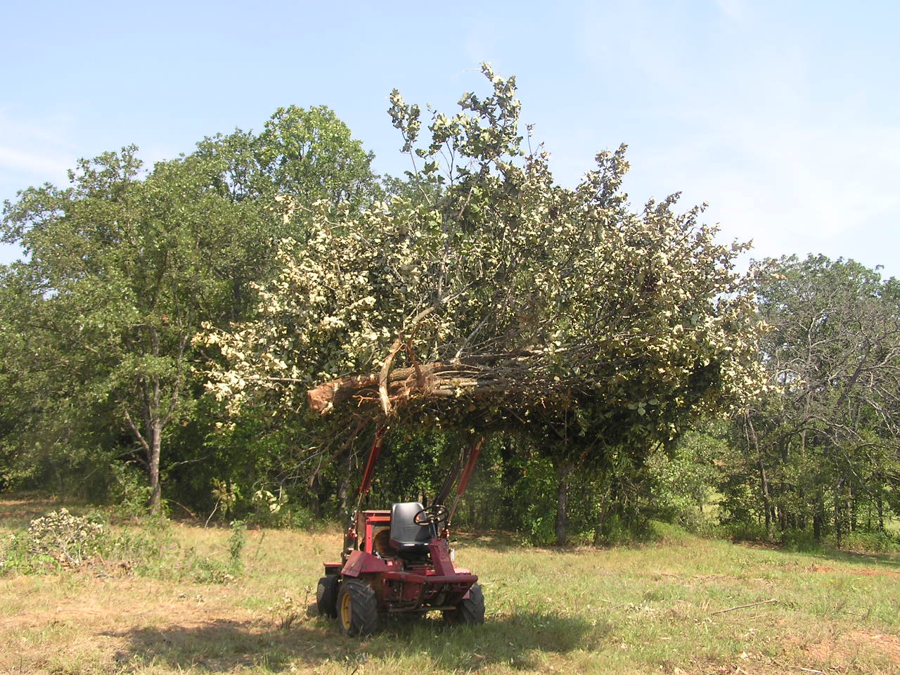

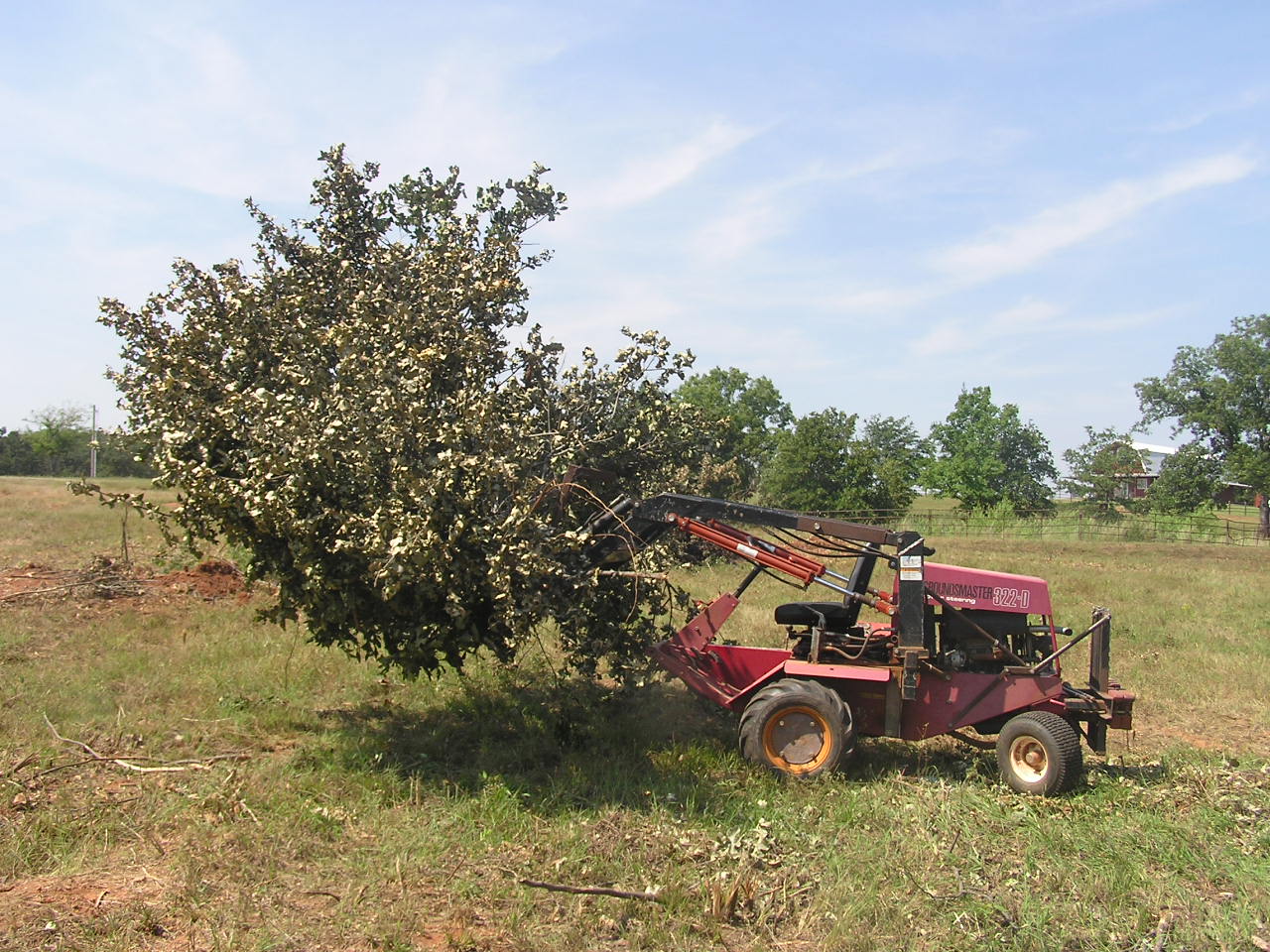

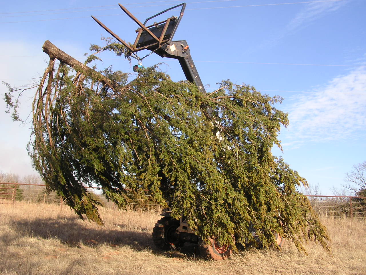

Ok I searched thread but with 1715 postings I may have missed this so sorry if its a repeat. Have a 09 Kubota L3400 with LA643 FEL(1100+ lbs lift). Most grapples seam to run around 500lbs so that only leaves 600lbs of load. Not sure how much a normal load of brush/trees weighs but any input on anyone finding the heavy grapple(compared to a 100lb bucket) really limits your loads. Or do you normally find most loads that fit in grapple are under the 600 limit.
Brush isn't very heavy. My TORO+Loader will lift 800 pounds with extra counter weight on the back.
It lifted these oak trees easily with the normal counter weight:

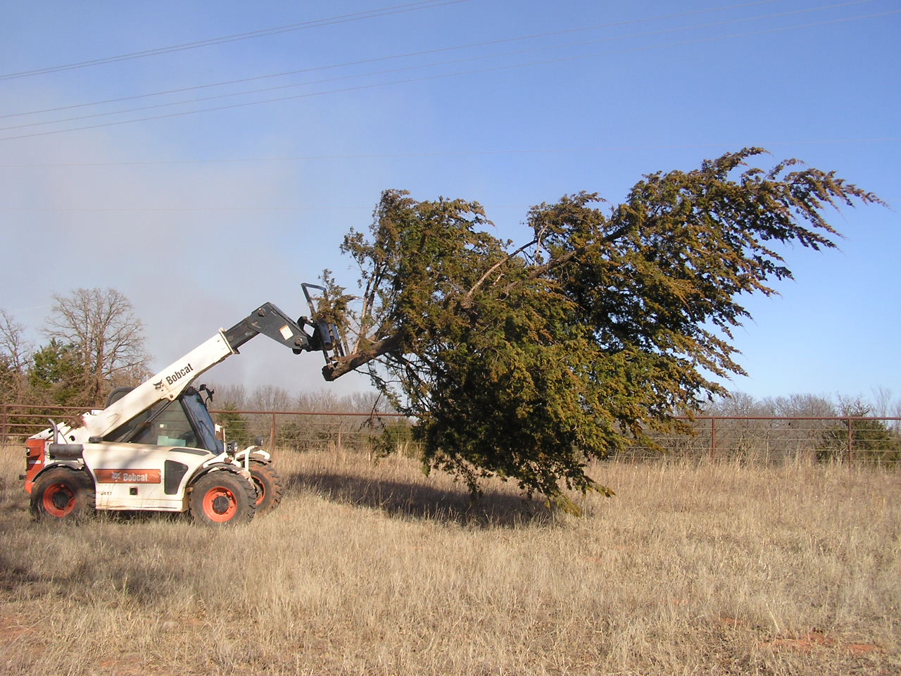

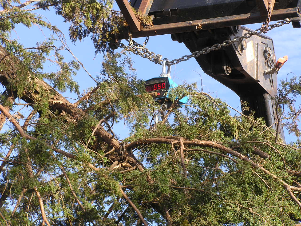

This 26' cedar tree weighed 550 pounds:

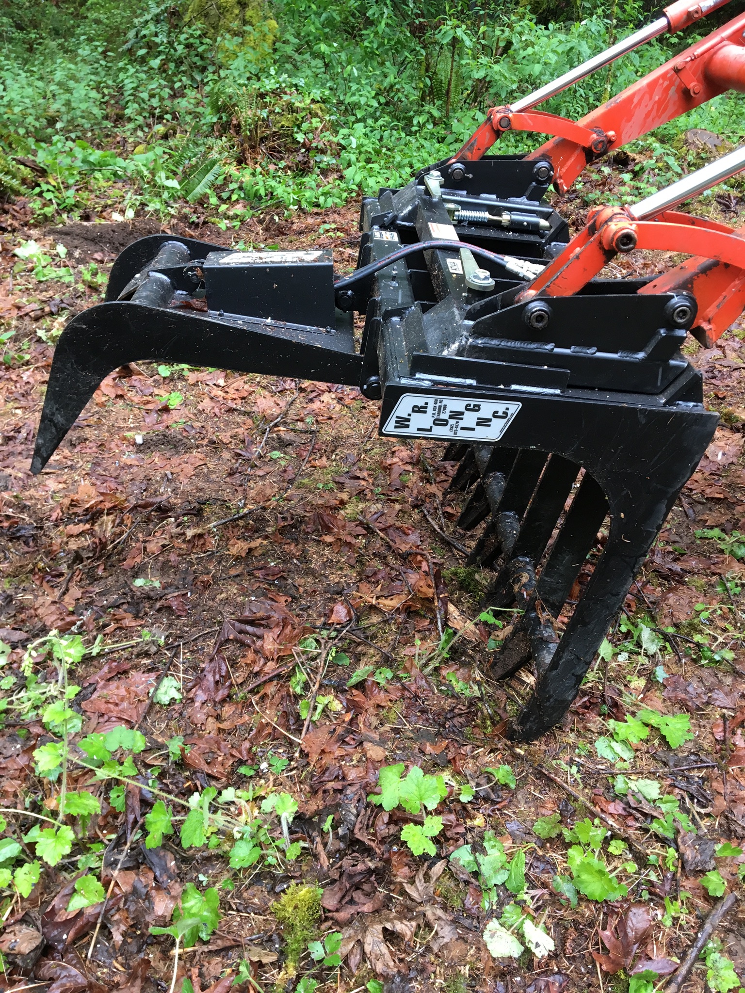

For your LA643 loader I would get a grapple in the 3XX pound range. My WR Long OBG2 48” is something like 375 lbs. EA makes them in that range and a little under. I went with WR long to get the 48” width so it would fit between the wheel wells in my pickup so that I can easily move it between properties. If that is not a need for you , EA’s start at (I think) 54” wide. They do not open as wide however. Both are good brands. WR along opens to 44”. Once you use any grapple you will appreciate a wide (vertical) opening.
