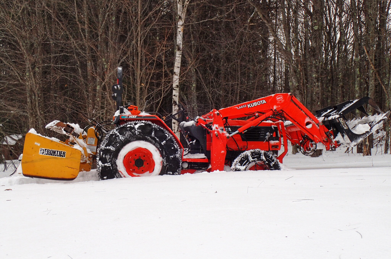

WOW Man... Those pics are IMPRESSIVE... Hope you had a good fire going nearby... Brings back some fond/SOBERING memories... I am VERY familiar with that/your area... I notice the chains/'first aid electrolyte'... Tell me what happened to the tire (NOT good timing)... Today I did similar tree/grapple-work but YOU don't want to know how nice it was to work outside here/in Central Florida today (at least I did not sweat)... Maintain course/speed...

I had low tire pressure in my right front tire, I had noticed it after my third grapple load of wood, and then rather than doing the smart thing and airing up my low tire, I figured well, I only have one more load so I’ll risk it. I loaded up (probably too much) for the last load, and then as soon as I made a sharp turn off the snow covered drive into the freshly paved gravel road, I rolled the tire off the bead.
I knew I wouldn’t be able to set the bead because the tire was so stiff in the cold, so I grabbed my battery operated impact, my sons sled, and a cold beer.
Then took the tire off, set it on the sled, sat down on top of the tire, and sledded down my hilly road :)
I put the tire next to the woodstove, lit a fire, and gave it a few hours to warm up. I was going to use a ratchet strap but didn’t have one (to try and set the bead) so I had to improvise. I rigged up a “Spanish windlass” to squeeze down on the centerline of the tire, and without issue, blew the tire back up.
The trek back up the hill with the tire on the sled was NOT fun at all, but it worked, and I had the tire back on before bed.

Nice pics. I wish we would get a decent snowfall. I know it's a little off topic but what style chains are they and where did you get them? They're on my list of things I need. BTW, I see your refreshment cooling in the snow LOL.
I got the chains from a place in Tamworth, NH called Windy Ridge. They work wonders! I had standard ladder chains on my tears before this and they just didn’t give me the traction I wanted. These are called OFA chains and the model is EKO 9.
VERY resourceful/industrious/determined... Impressive... Again, I got to hand it to ya laddy... Good for YOU...
